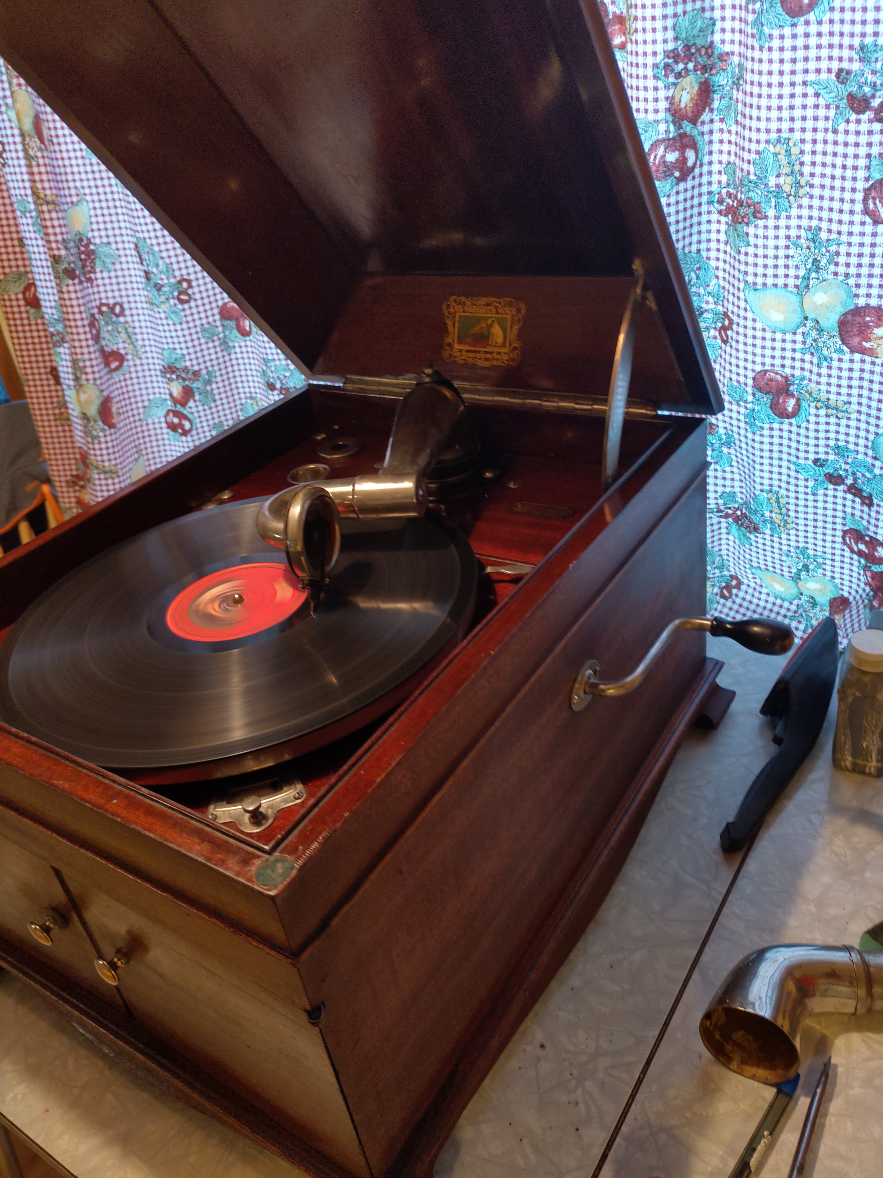

Everything seems to come in pairs lately, and here we have another table grand in mahogany. It came up for sale yesterday, and I could again not resist it, because of the HMV No2 Soundbox, that I still not own, and also because the model is not what we see too often, also because of the feet. I bought it after a quick check in the HMG book, and to me, it looks like model 125? It has a goose neck tone arm, speed indicator, green felt, and a 32 double spring motor. The horn can be seen on the photos.
The only detail that to my eyes mismatch the photo of the Model 125 in the HMG book is the door knobs, they are of wood on my machine, while the one pictured in the book has metal door knobs.
We can see this machine was originally sold in Cardiff, but has later lived most of its life in Riga, Latvia, before it ended in Oslo, Norway some years ago.
The machine is right out of the car this morning, no basic cleaning etc yet.

Minor details such as door knobs did not always remain the same throughout a model's production run.
There was probably a transitional period when either metal or wooden knobs were fitted.

Thank you, Roger. From your response I understand that this is actually a model 125. According to the HMG book it was manufactured in 2294 copies in mahogany ( If I understand the book correctly), so I will maybe keep this machine. I also have a set of metal door knobs from a unsalvageable early HMV table grand, that can be fitted to this machine. It looks quite impressive really. I also received an Odeon sortiment needle box with the machine, along with about 120 records so it was well worth the trip yesterday evening, even if I was close to abort the purchase due to a recent overflood of machines coming in my direction lately, that I have not been able to resist buying.

Later models 126 and 127 were new style gramophones, listen to the bass era, swan neck tonearm, no4 soundbox and new long expo tin horn, but the outer box was the same and the overall appearance, except for the new tonearm and soundbox. Same motor too. My French 126/7 (?) also has the wooden door knobs. One was missing, and I made a replica by hand, out of a wooden stick, using a knife and sandpaper.. Then I stained it with Judea,a bit of shellac, et voilá... It looks better than the original! The difference between 126 and 127? Maybe the later production and an auto brake added? Mine is of the 'wide fork' type, which you set for each record. My model is French, so I don't know if they departed somewhat from the UK standard. French Gramophone had their own idiosyncrasies....

The 126 and 127 have different cases - not immediately obvious, but it's clear if you put them side by side. 127 has thinner sides, a slightly squatter lid moulding, and different doors - they are pivoted within the jambs, as on 109 etc, not hinged at the corners as on the 126. The bead round the top of the case is removed, and the lid stay is different, too. But it does not surprise me to find wood door knobs on a late 125.
The hand-set automatic brake on the 125 continued into the early 126, but later ones would have the No 2 brake (hand-released but self-setting, worked by eccentric run-out groove. 127s would probably have the later version (No 3), which was released automatically by swinging the tone-arm to the right, but the change would not necessarily have come at exactly the same time as the change from 126 to 127.

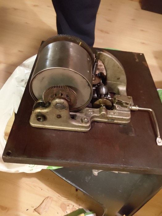

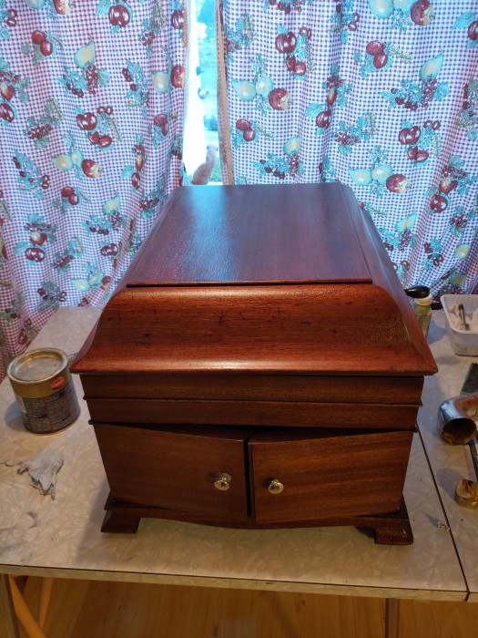

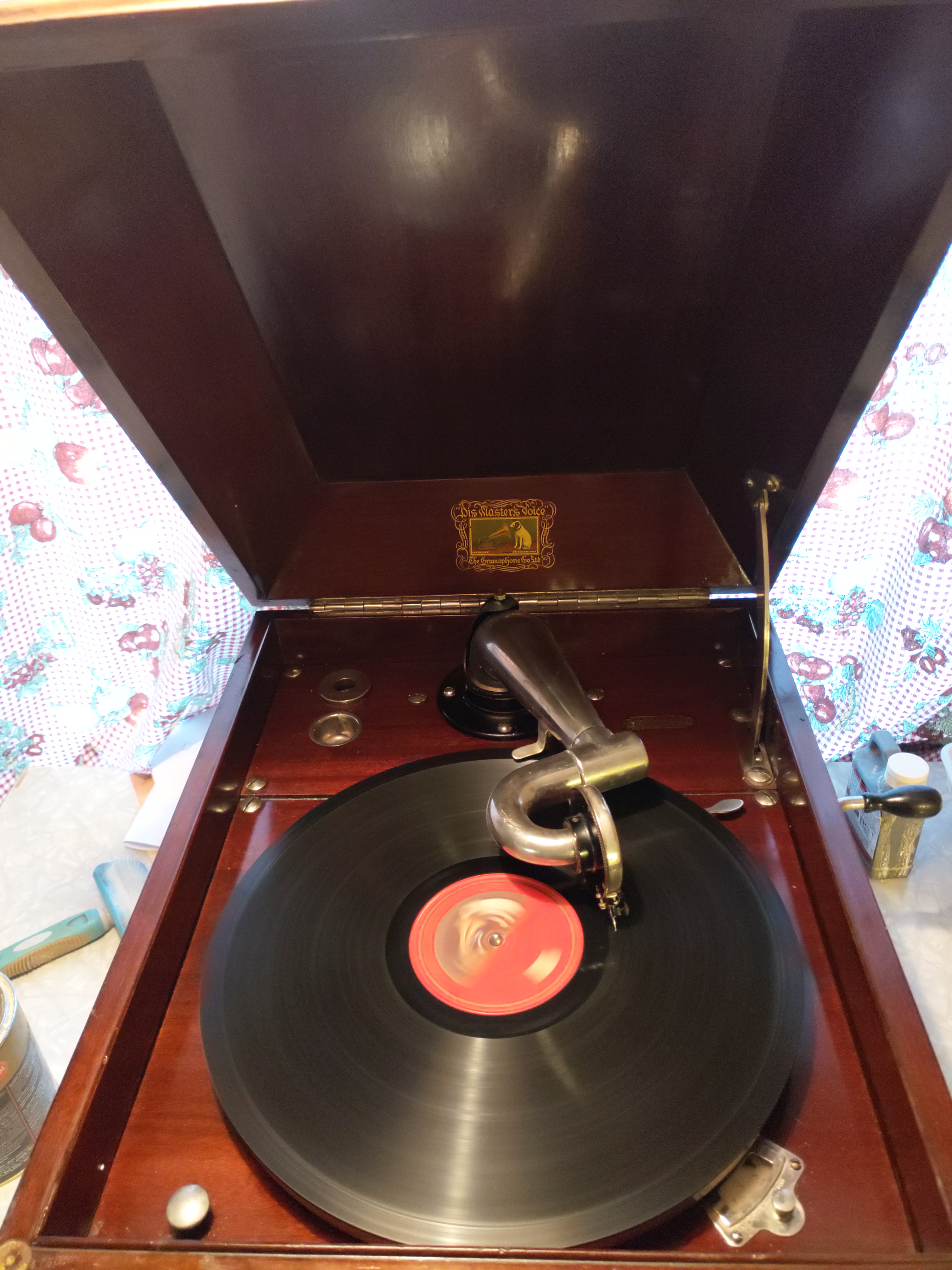

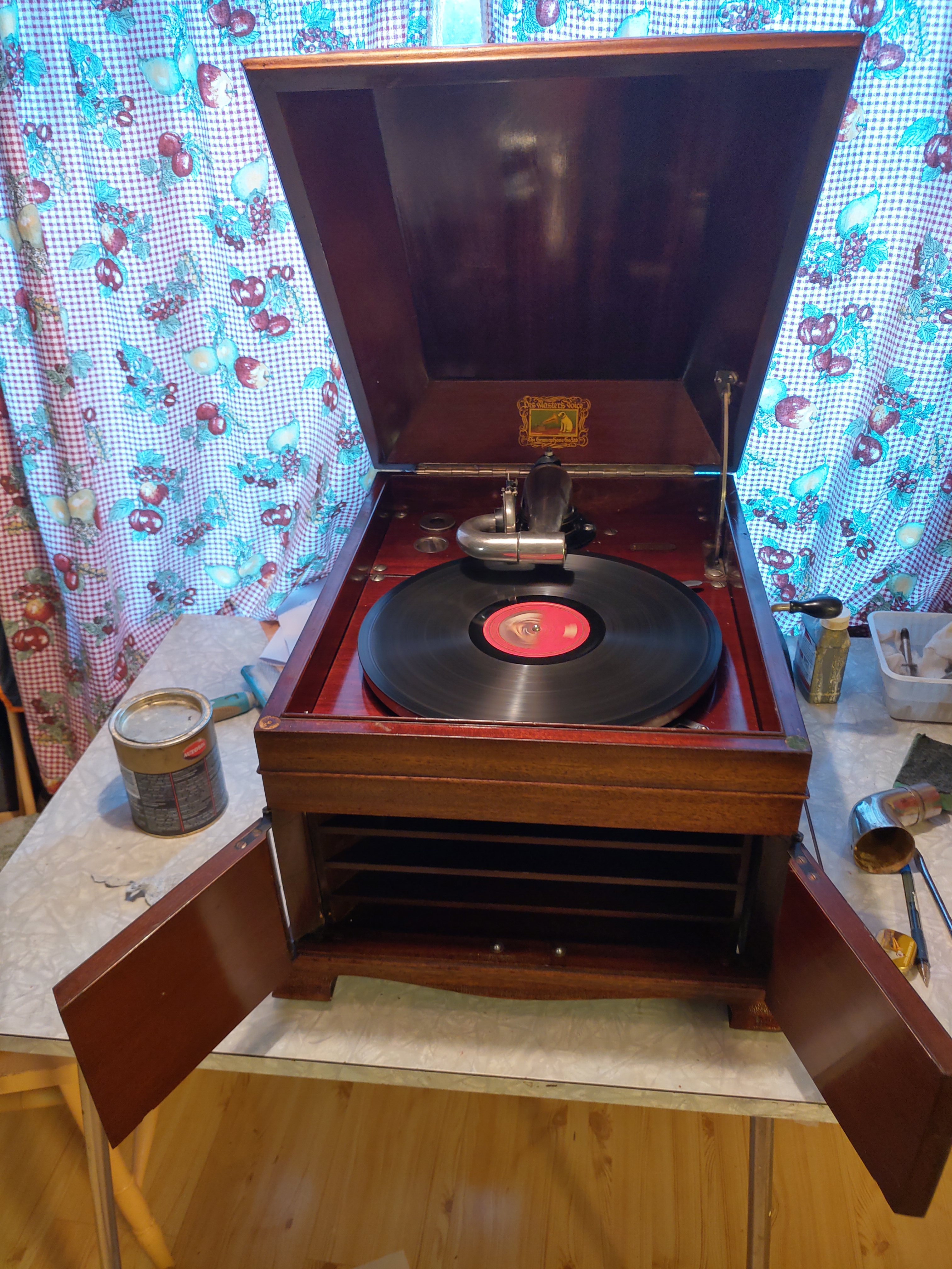

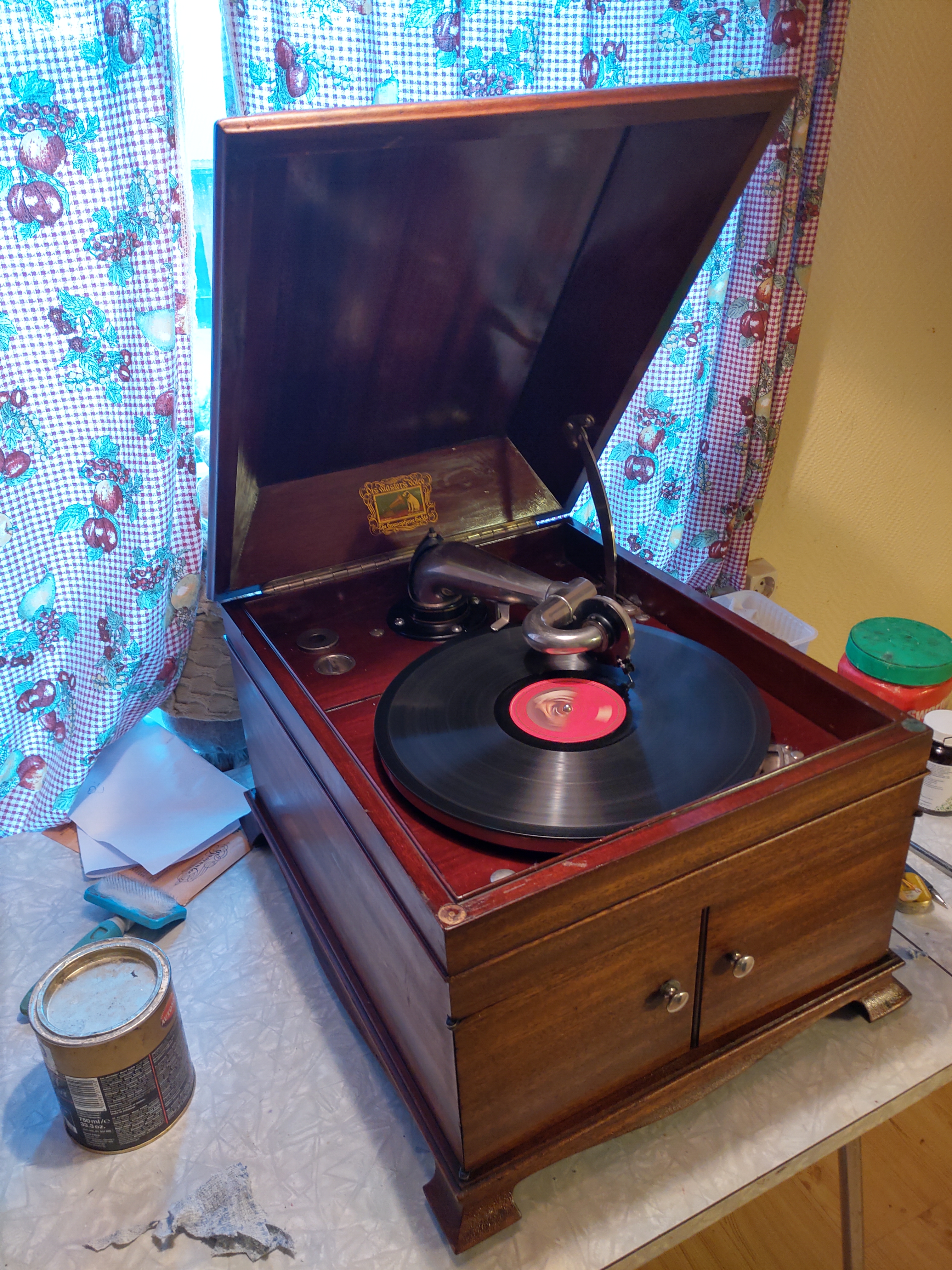

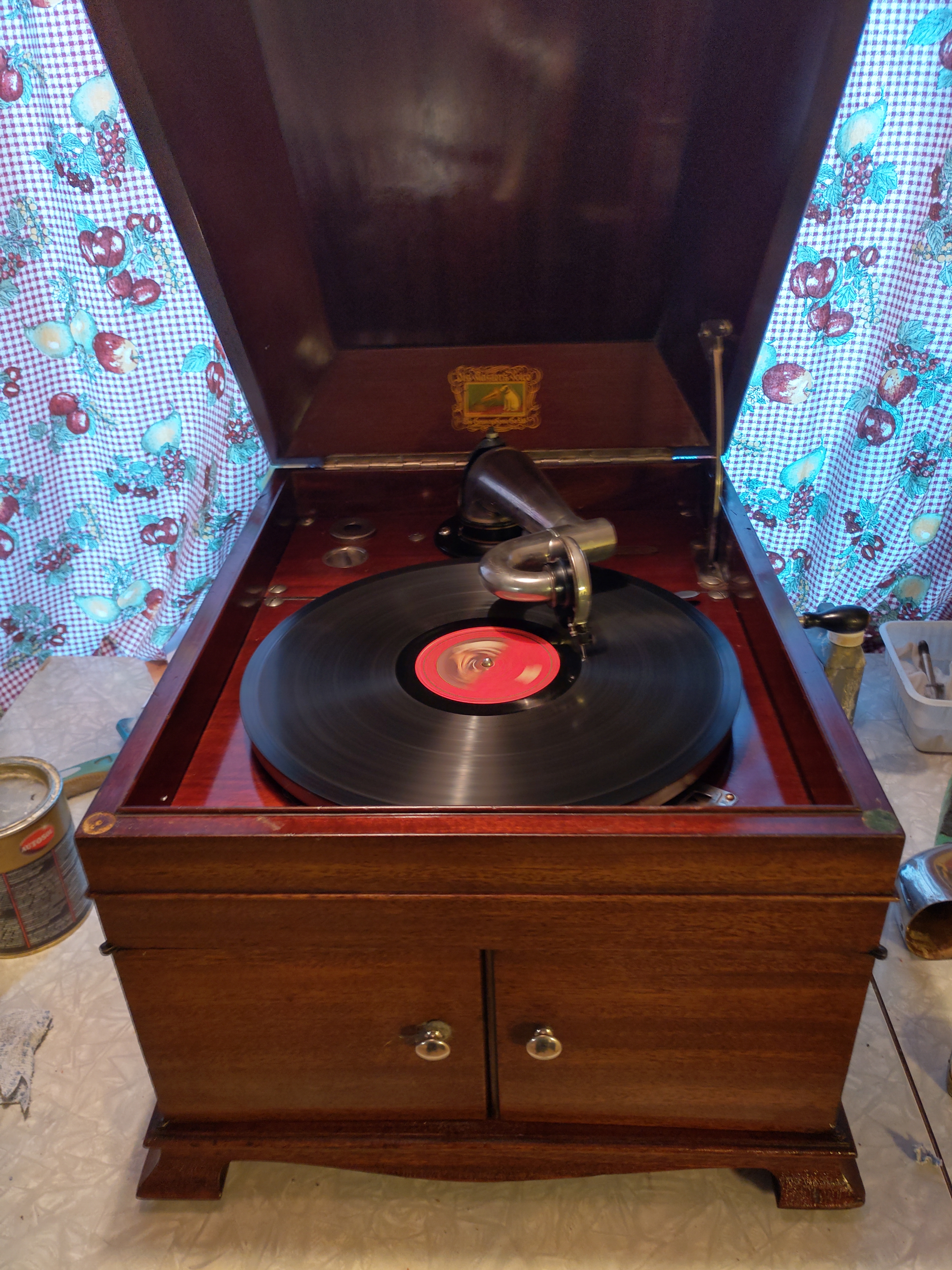

As always, some photos, when the machine is restored and serviced.
This was a rough 32 motor, the grease was extremely hard to remove from the springs. (Also caused by the type of springs, that were not exactly smooth.)
The door knobs have been changed to HMV door knobs in metal from the same period, since one door knob in wood was missing.
(On the turntable: Caruso, La Boheme ( Puccini) HMV 052122)
(Grease added to the gears after the photo was taken:;)
