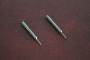

There's another possibility which I've used with success, and it is too use the Exhibition with very soft needles. I've found that the RECOTON type (those needles with the thin needle protruding from the thicker shaft) is good for playing modern 78s with the Exhibition. Provided that they are not vinyl based records (i. e. the Victors of the late forties, the later Capitols and Deccas and MGMs, al those staring in their labels that they are pressed in vinylite, Deccalite, Metrolite or similar "unbreakable" material for late 78s; they feel unmistakably plastic, thin and light). The problem with these is that the record material gets destroyed under the heavy soundboxes.
Here's the type of needle I mentioned

Thank you, this is very helpful. Are Recoton needles easy to find? Or is there a modern day version that is available? I have never tried soft tone needles, and up to now, have only used mediums.
Posts: 4572
Re: Playing "newer" records on Victor VIII
You may find similar needles of other brands, I believe that all important brands made their own. For instance, in Europe the German Laubscher brand is easily found. Just check eBay adds with photos of the needles in the boxes. They're ready to find in NOS packages. Modern steel needles suppliers are mentioned in the Links section of this forum. I always buy from british colleague soundgen, whose needles are very good. He used to have an extrasoft class that was suitable, but the shafts of the needle is as thin as the point, and they may not be gripable by the exhibition needle chuck. You'll need a type of needle that is the same, but with a thin wire rolled and pressed around the shaft, to make the needle more gripable... Ask him if he has this type, or any other needle supplier in your area, if you want to save mail costs. Although mail costs for such a tiny package of, say, 1000 needless, costs anything...!
Another option is the bamboo needles, but these don't work well on vinylite based 78s. But on shellac based 78s, they also work well.
For vinylite 78s, frankly, I cannot find a good option for acoustic machines, I've never tried the cactus needles, though... and these seem promising. I play vinylite 78s only in modern turntables.

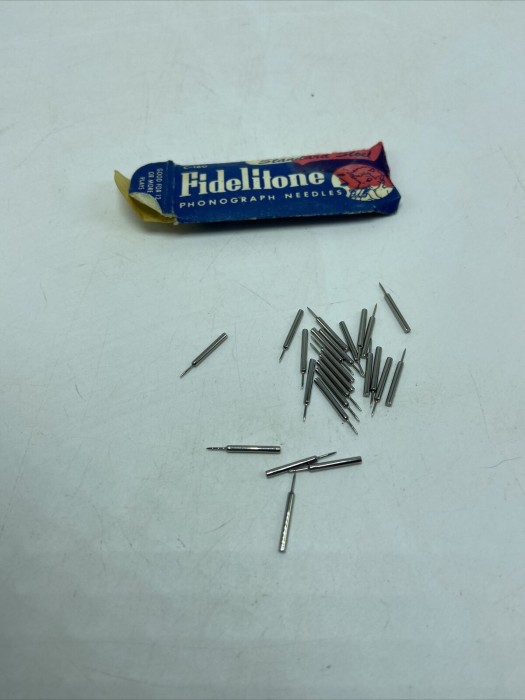

This thread brings back memories. When I bought my second Victrola while in high school in the late 1960's, I asked the guy selling it where I could buy needles. He directed me to a local radio parts store that sold Fidelitone steel needles for a quarter a pack (see photos below from a recent ebay listing). I bought needles from the radio shop for several years until it eventually closed down. I always liked those needles. Fast forward to the mid 1980s, and I responded to an ad in APM from a guy selling Laubscher Pianissimo needles. As it turned out, they were the same as the Fidelitones I had purchased in the past. A few years later, I wrote to the Laubscher company in Switzerland, and they sent me some samples. I purchased a few thousand Laubscher Pianissimo and some of their other varieties of steel needles. I regret that I didn't buy more at the time.
I now use Mike Child's (soundgen) soft tone needles, and I am very pleased with them. Although different in shape, they work well.
