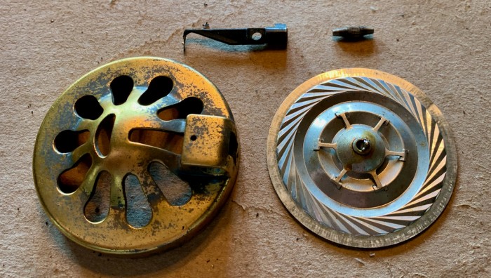

Can you show us a photo of what you have so far please?

I'm not worried about brass or steel parts - they will be fine in the ultrasonic cleaner with clock cleaning solution. Really just wondering what people might use for cleaning aluminum and pot metal without harming either finish or shellac (as this seems to be in good shape on the diaphragm). While I am at it, though: what do you like to use for resealing spiders on the diaphragms without snipping and using cyanoacrylate? The original seems to have more shellac than needed and I had thought about dissolving it and reapplying it in smaller quantity.

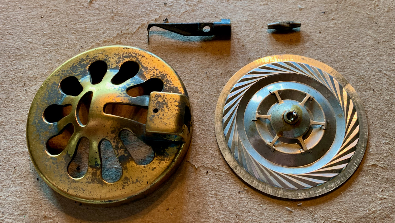

I would not attempt to clean the diaphragm. I have only rarely found cases where the spider no longer seals at its attachments to the diaphragm. I suppose I would try resealing with beeswax, but only if necessary. While the diaphragm looks like a good one, hold it up to a bright light and look for very tiny pinholes in it, especially where it may appear to have small blemishes in the surface. Surprising how many are perforated.
As to cleaing the housing, it appears to be more tarnished/corroded than dirty. As for dirt, I would use a toothbrush, along with either soap & water, or a solvent to clean it. Any attempts at polishing usually removes plating.

Agreed. Thank you for your comments. As there are residual solvents on the parts (Mouse Milk) and dust from years of storage, I had wanted to get that off before reassembling. I'll probably go with a Dawn detergent solution and an artist's brush, given the fragility of the diaphragm. Not as worried about the body other than preserving the gold. I have others that are too far gone to worry about finish, but this one is good enough to preserve.JerryVan wrote: Mon May 10, 2021 3:59 pm I would not attempt to clean the diaphragm. I have only rarely found cases where the spider no longer seals at its attachments to the diaphragm. I suppose I would try resealing with beeswax, but only if necessary. While the diaphragm looks like a good one, hold it up to a bright light and look for very tiny pinholes in it, especially where it may appear to have small blemishes in the surface. Surprising how many are perforated.
Interesting tip about the pinhole perforations. I had held the diaphragm up to light and detected 3 or 4 at the points of attachment of the spider feet, but wonder if that is only because the original shellac thinned in the small gaps upon application. My current plan unless I learn of something better is to apply a small drop of Indian Head Shellac Gasket Compound at these points or maybe mix up a little orange shellac and go with that. I want the repair to be reversible.
