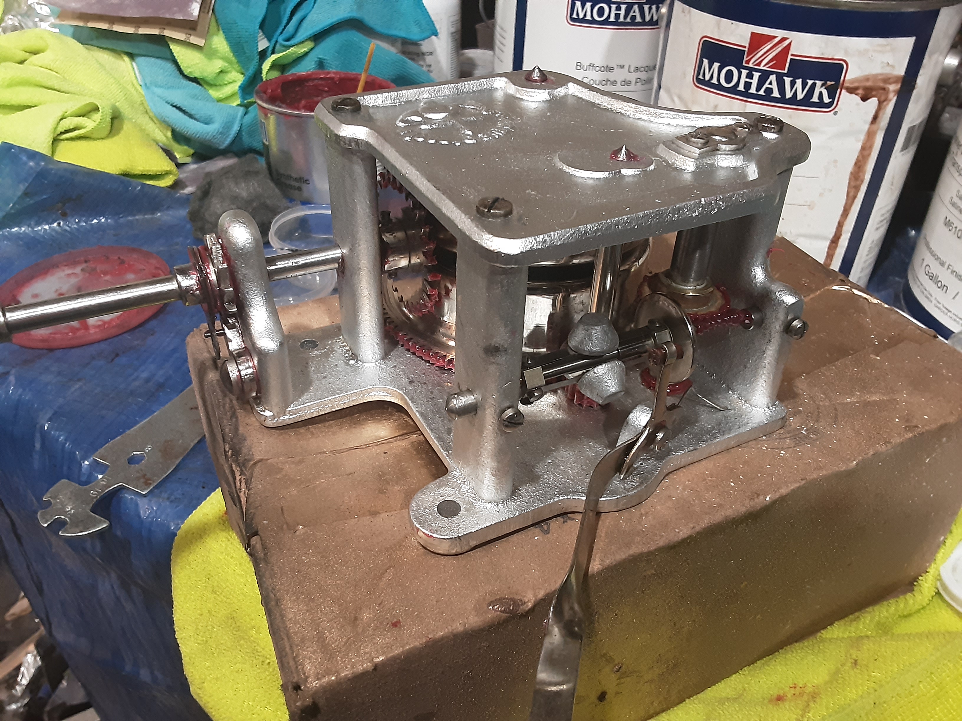

I am almost finished with a Paillard 217 motor for a 1919 Sonora Baby Grand and compared to Victrola motors, these seem sub standard, quirky and hard to get running right, anyone else have trouble rebuilding these? I have it running now but have a spring slip issue to troubleshoot still.

I have rebuilt many Victrola motors so in comparison, this seems cheaply made in to me. Chrome plated vs Victrolas brass and nickel plated parts. The Pallard governor doesnt ride on ball bearimg ends like Victrola so it doesnt seem to spin as freely and takes some adjusting to get the worm gear lined up on the governor while getting it to spin freely. Also, the crank gear mech is way over engineered. They also use pins instead of screws in places that makes disassembly harder than it needs to be (tapping the pin out and aligning the holes to put it back in). Perhaps if i have done a few it would be easier. The only problem i have now is if winding tight one of the springs slips. I think i need to put a washer on the bottom end of the bottom spring barrel to lift it up and reduce the gap between the topmand bottom barrel. I put the washer on the top and think it belongs on the bottom. I am sure with another round of tinkering i can sort it out. Are any diagrams out there?

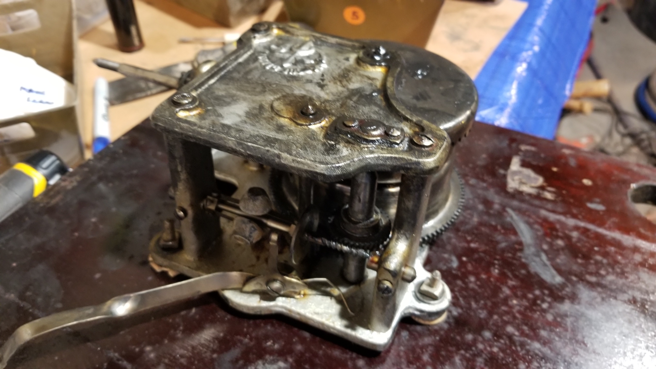

I have the motor running well and figured out the sprimg barrel washer spacing but still having problem with winding, when it starts gettimg tight a sprimg slips, sounds like 2-3 slips before it catches again. I suspect i need to tighten the sprimg where it goes around the arbor, does anyone else agree?
Posts: 6823
Re: My first Paillard spring motor rebuild - and last
Jonsheff wrote: Sun May 16, 2021 3:13 pm I have the motor running well and figured out the sprimg barrel washer spacing but still having problem with winding, when it starts getting tight a spring slips, sounds like 2-3 slips before it catches again. I suspect i need to tighten the spring where it goes around the arbor, does anyone else agree?
No. Sounds as if it's slipping at the outer end. Slipping on the arbor would not allow you get any spring tension at all, while slipping at the outer end requires some amount of winding to overcome the grip of the outward pressure on the barrel. Then, it will slip until the tension is no longer sufficient to allow slippage. You wind it more, it slips again. Etc.... Your outer is not catching on the anchor.

Jerry was correct, outside end blown out on mainspring. I cut and drilled but it wont catch, keeps slipping. I think i need to temper so it will bend but dont have a torch and would prefer to replace. I am having trouble locating one, its 25mm (1 inch), not sure of length, perhaps 14-17 feet. Any suggestions on a source?
