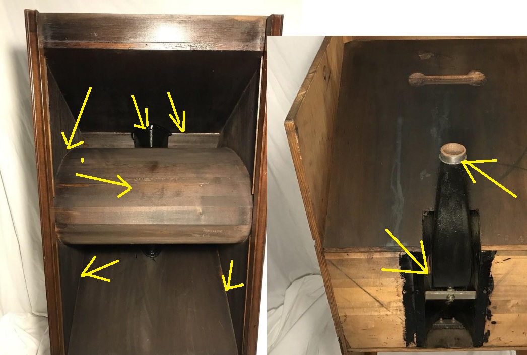

For the most part, it involves ensuring that there are no air leaks in the horn chamber where parts come together, such as at the base of the tonearm, where the tonearm joins the cast-iron elbow (I think it's called an elbow), where the cast-iron elbow is connected to the back of the horn, etc. Inside the horn, you should check for seam gaps where wood is joined to wood, such as the lats that comprise the "heart," (central portion of the horn) and at the sides of the horn, etc. When I sealed my 4-40 horn, which is identical in shape to the Credenza horn, but much smaller (about 60 inches in length, including the tonearm), I worked white glue into the seams at the corners inside the horn, and worked silicone calk into the area where the cast iron elbow was joined to the back of the horn.
The arrows indicate where to check for leaks and apply sealant if necessary:

The pictures are fantastic! Thank you! Is there anything to seal on top of the unit or the front behind the screen?OrthoFan wrote: Tue May 25, 2021 4:39 pm If you haven't seen it, this article is worth a read: https://www.gracyk.com/credenza.shtml
As for how to videos, I haven't seen any step-by-step instructions that show all aspects of the horn sealing process, but there are a few that show some specific types of repair/maintenance. For instance:
https://www.youtube.com/watch?v=F8q5fw3CmaU
https://www.youtube.com/user/HD7100/sea ... y=Credenza

After the motor-board is removed, you can inspect the top--outer portion of the horn--for cracks, warpage, etc.. If you have a spring motor, it will probably be covered with grease, so you might want to clean it with a grease solvent.JOHNNYTREMPs wrote: Tue May 25, 2021 5:00 pm The pictures are fantastic! Thank you! Is there anything to seal on top of the unit or the front behind the screen?
Right behind the screen or grille is the mouth (or front) of the horn, itself, as shown in the photo. No sealant is used between the grille and horn.
About the only other places where there can be air leaks is where the soundbox (reproducer) attaches to the tonearm, at the tonearm "crook", and at the base of the tonearm. You can use a little grease or Vaseline to coat the end of the tonearm before affixing the soundbox. Some collectors, myself included, wrap a few turns of plumber's Teflon tape around the end of the tonearm before inserting the soundbox.
For the crook, (that's the joint where you flip over the front of the tonearm), you can remove the lock-screw on the bottom, and then unscrew the coupling. Once removed, clean it and apply a light coating of grease to the threads and screw back in place. Not too tight, though. The sound box must be able to rise and fall without restriction.
I'm not sure what type of tonearm support back bracket you have. There were two styles, and the sealing instructions are different for each one. The earlier one without the overhang support, simply involved removing the bracket and coating the felt washer under it with fresh grease. I've never taken apart the later version, so I don't know if there is a washer positioned under it or not.

I've got the electric version.OrthoFan wrote: Tue May 25, 2021 6:35 pmAfter the motor-board is removed, you can inspect the top--outer portion of the horn--for cracks, warpage, etc.. If you have a spring motor, it will probably be covered with grease, so you might want to clean it with a grease solvent.JOHNNYTREMPs wrote: Tue May 25, 2021 5:00 pm The pictures are fantastic! Thank you! Is there anything to seal on top of the unit or the front behind the screen?
