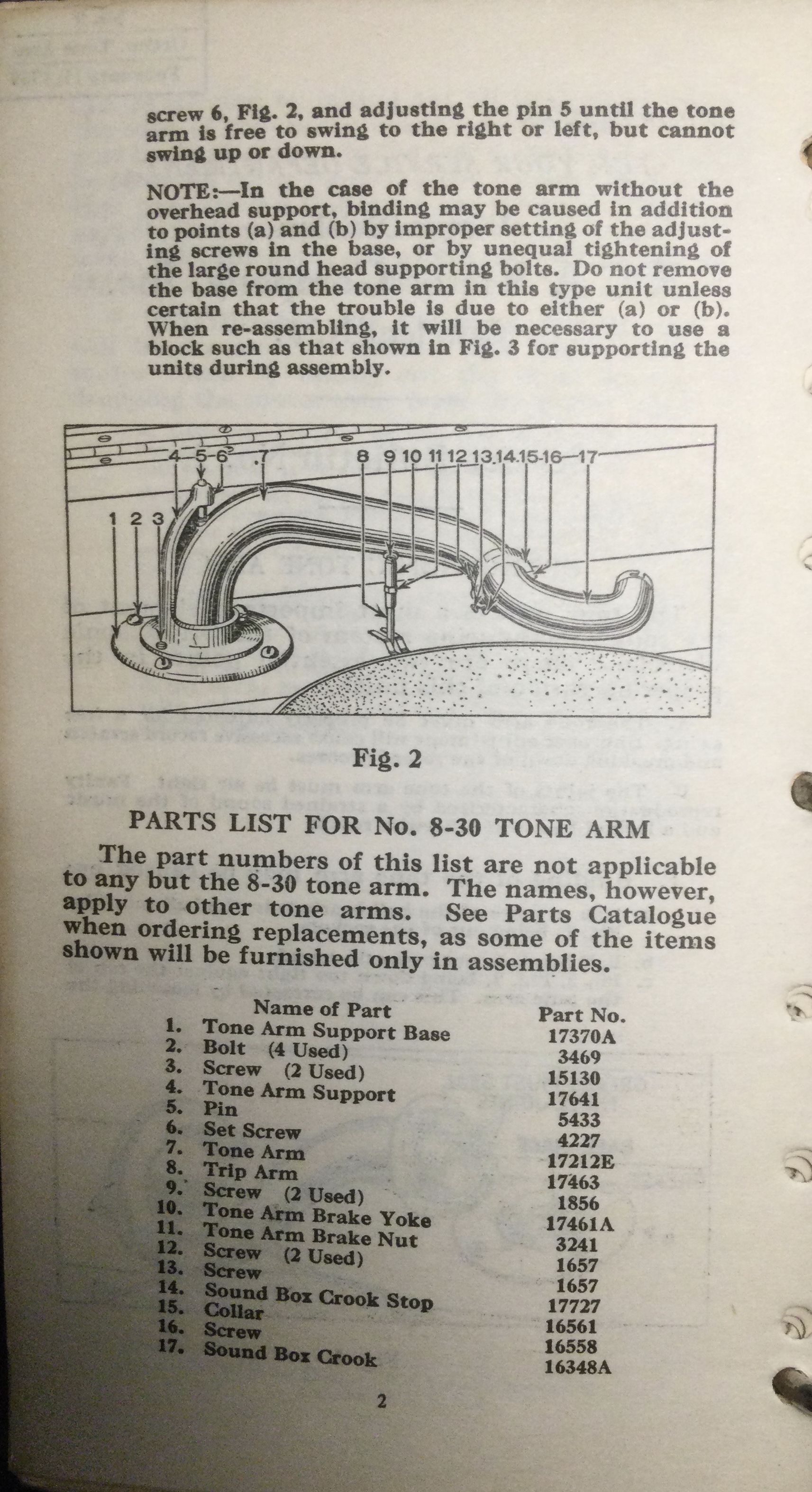

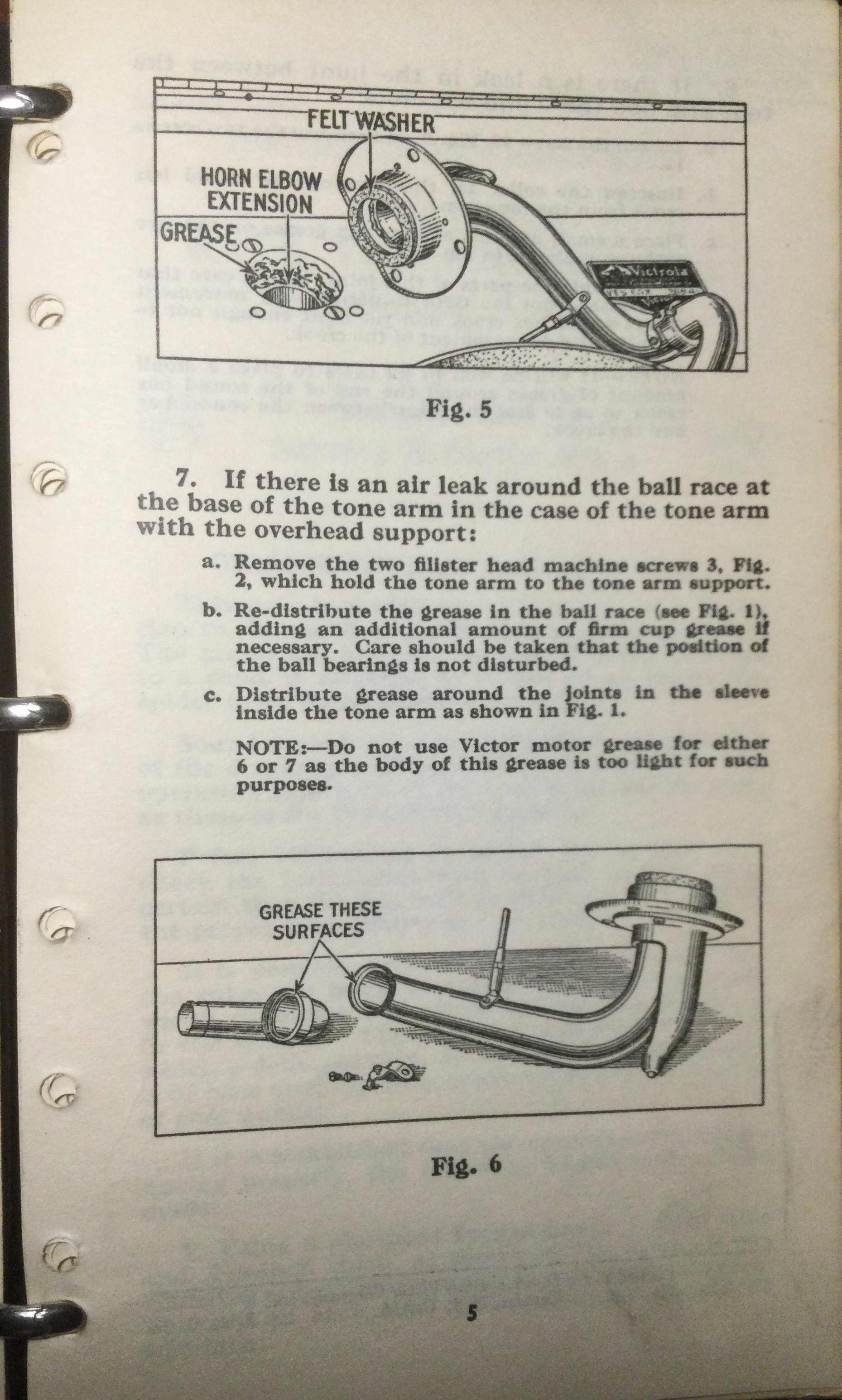

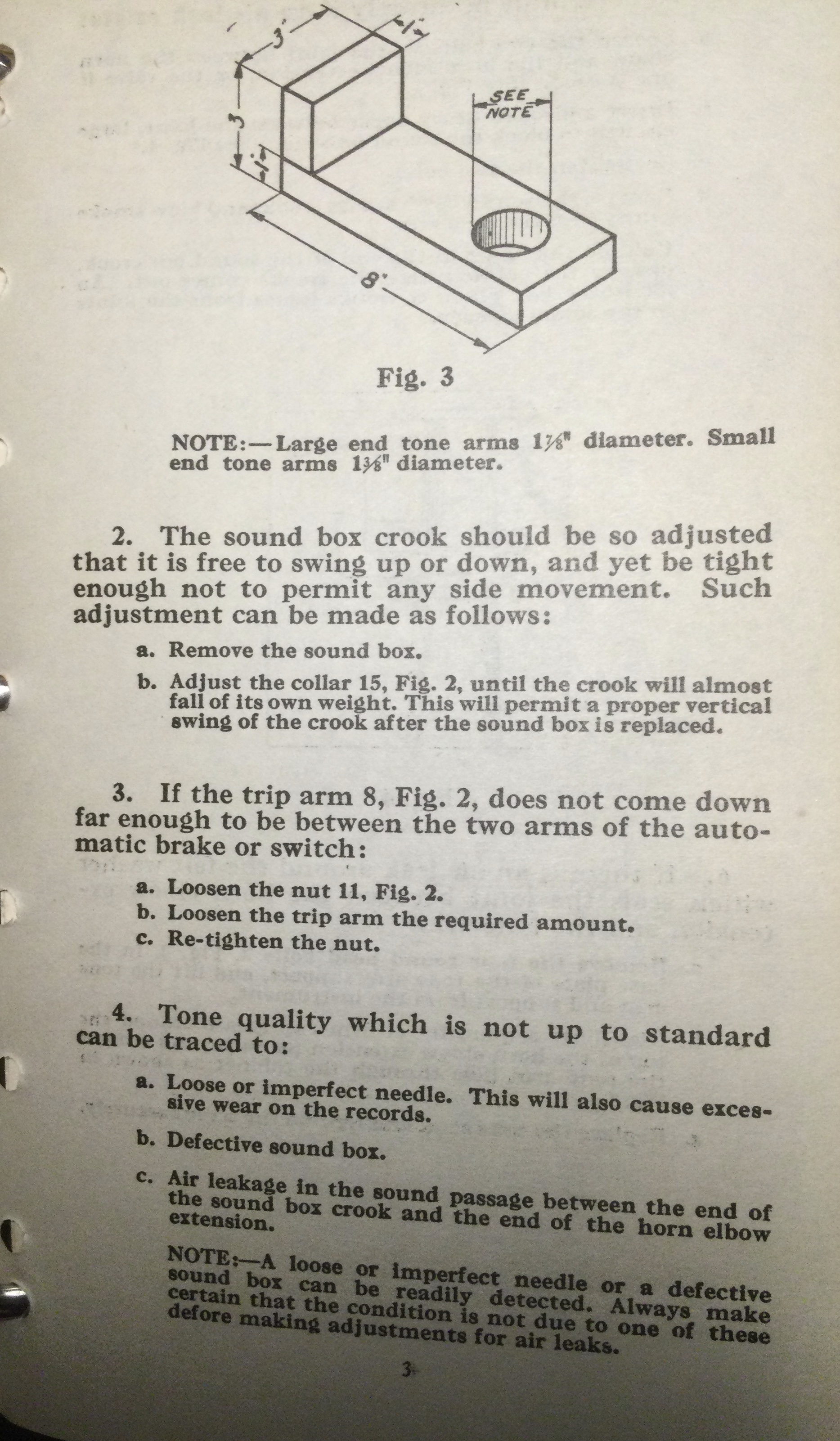

Victor was a large organization with substantial dealer support. Here is the service bulletin supplied to the dealer’s service department by RCA Victor for servicing the Orthophonic Tonearm. Modern collectors will find these instructions useful.

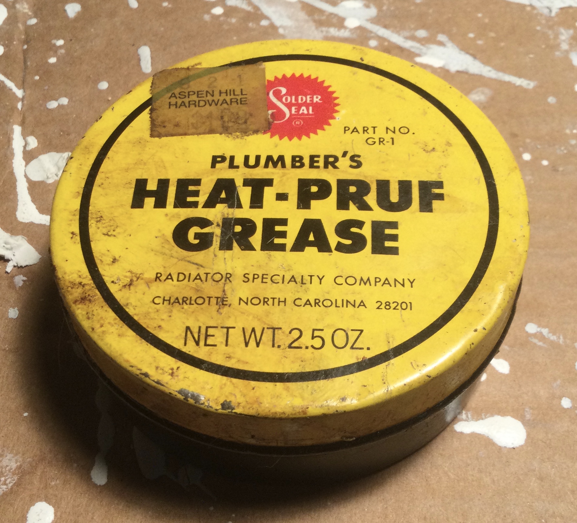

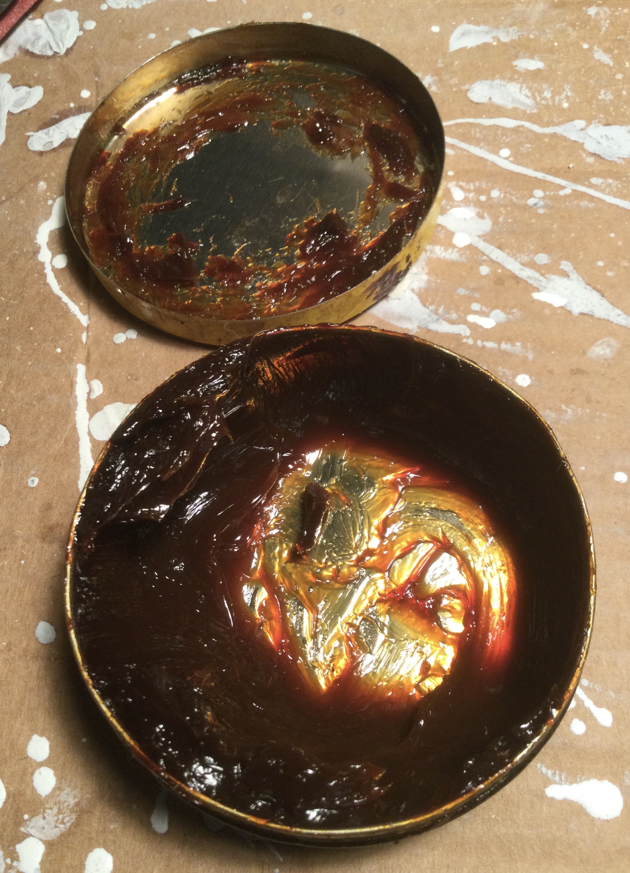

The instruction describes the use of “firm cup grease”. This plumbers grease has the right consistency for the felted joint and joint at the Tonearm base. Use a lighter grease at the soundbox crook.
Supplemental instructions can be found in the appendix of Robert Baumbach’s book “Look for the Dog”
All collectors should have a copy.
Mark

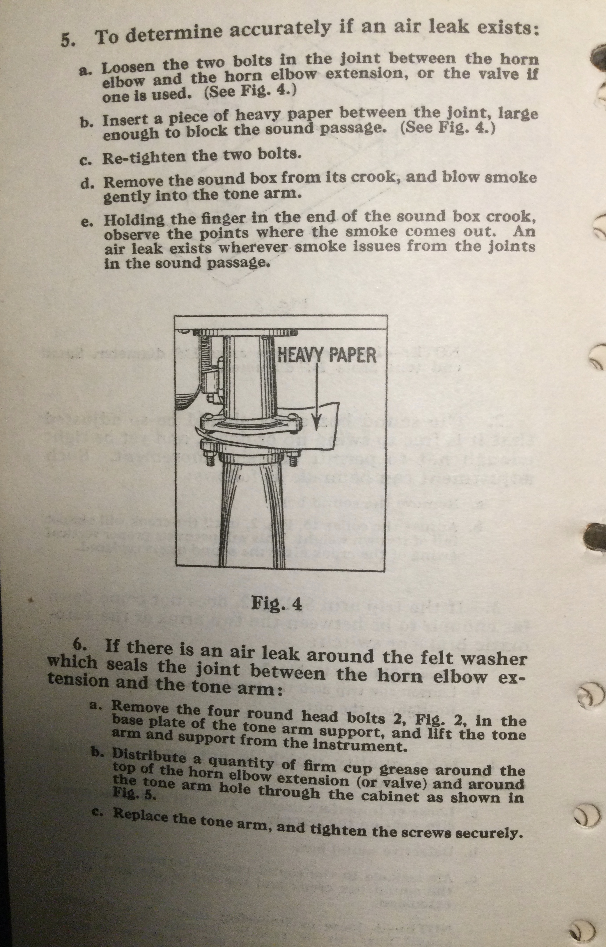

I like item 5-D regarding blowing smoke to determine air leaks.
Who can I bum a cigarette from without buying a whole pack?!

Bob, that is a good point but I’m sure they had one of these in mind for the smoke test. Be sure to add either the Victor or the Edison tone arm adapter to your order. :)
As a word of caution, don’t blow or pump too vigorously or you may displace the grease meant to seal the sound pathway.
