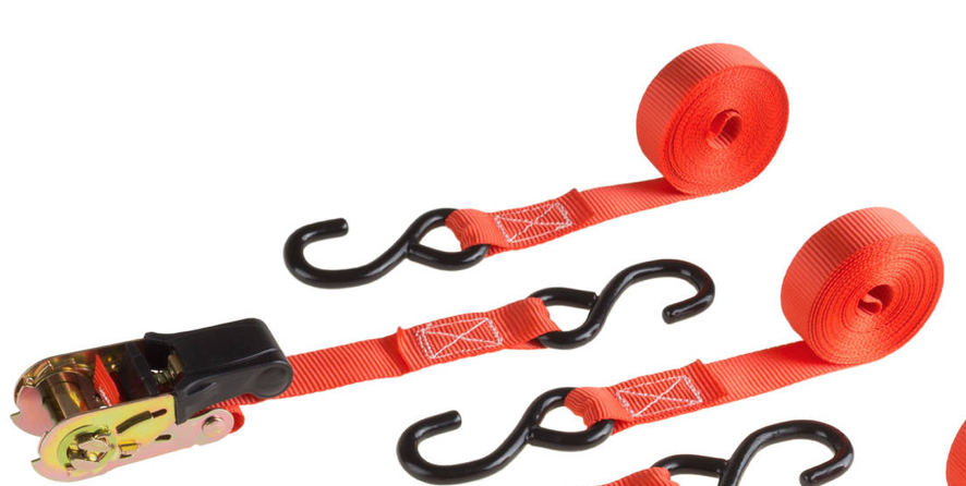

- Posts: 6851
Re: Need help fixing splintered Gem lid
A small adjustable ratchet trailer tie down strap could be used as a clamp... They are good for clamping cabinets together, as well.

Yup, a set of pants belts works too. the ratchet tie downs worked great for chair legs too.Curt A wrote: Wed Jun 02, 2021 9:20 am A small adjustable ratchet trailer tie down strap could be used as a clamp... They are good for clamping cabinets together, as well.
