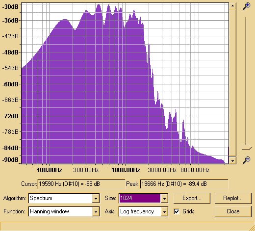

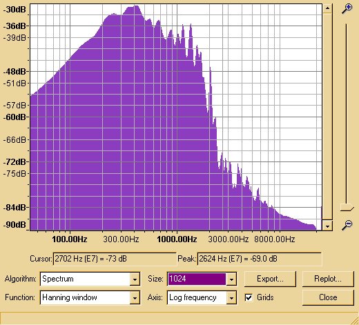

Re: Playing to the carpet.
The height of the horn does matter - insofar as it can make it more inconvenient to get your ears on axis with the horn.
I have recorded the same disc twice with the horn on axis and 30 degrees off axis. As you can see from the spectral analyses, there is significant loss of both low and high frequencies when listening off axis.
(Not recorded in an anechoic chamber so the room dimensions and fittings obviously will also have some impact. )
- Posts: 4673
Yes, with the second recording we're listening to the echo of the room.when I recorded from my 194 I placed the mobile phone on a music stand on front of the machine, height and position adjusted so the mic is in the axis of the horn (roughly). Other times I sat in a low sofa, holding the phone in similar position.
