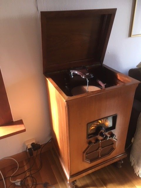

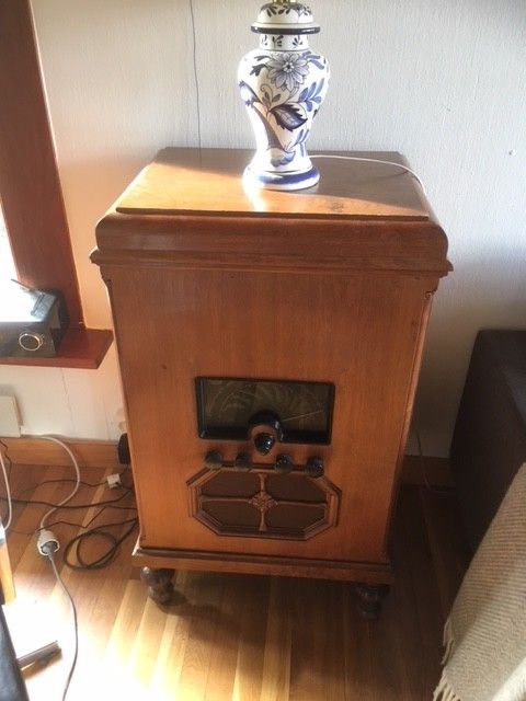

Does someone know this machine? I normally don't pay much attention to electric radiograms, but this one caught my attention.
I have tried to use Google, but could not find the model. Approximate year of manufacture would be great to know. I read Capehart made decent machines in their eraly production.
It is for sale in my area, or at least approximate area.

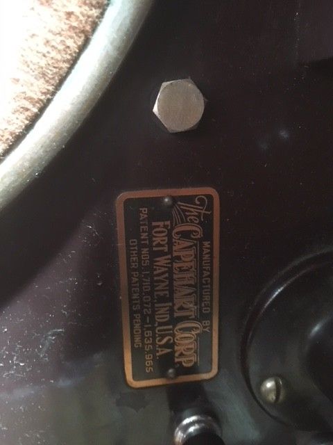

The changer in the piece is a Capehart Model 10-12, late 30's, early units had a magnetic pickup (horseshoe type) later ones used a "B" series Astatic cartridge.
Philco, Atwater Kent and other manufacturers used this model in their radio/phonos. Was not an intermix changer you had to pre adjust the size of the record you loaded.
Can't say if it is original to the cabinet you show. The cabinet and name sounds/look British, I would guess it might have originally had an early Garrard RC - changer in it.
Chuck
Chuck

Chuck has it right. That is the first version of the 10-12 changer, also known as a 10-12A. It was marketed from 1930 to 1932 under the Capehart name. After that, there were several who branded the same changer, GM, Philco, Farnsworth, and others, through 1938 or so. All of them are very reliable and easy to load.

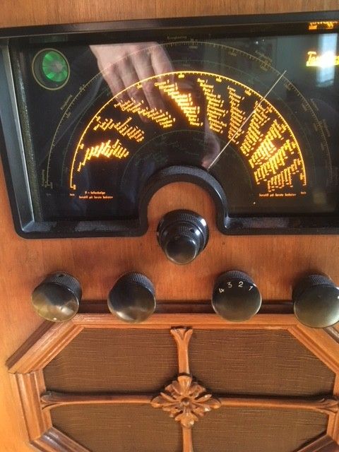

What is unusual is that the radio appears to be a later vintage than the changer. The fact that there is an eye tube places the radio in the later 1930's.
