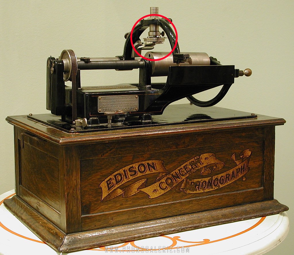

I’m after one of these for my Edison concert duplex? Should I make one myself or look for a parts vendor?

That’s going to be a tough one to find. It extends the entire reproducer, not just the stylus (which is a tiny sapphire mounted to a stylus bar on the weight).

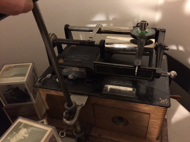

Might be easier to get one of the Edison Concert conversion carriages for playing standard size cylinders. See picture.
Doug
Doug
- Attachments
- edison concert with converted carriage.JPG (89.82 KiB) Viewed 569 times

I never knew such an adaptor existed and I think the chances of finding one is extremely low.
If this were mine, I think I'd attempt to make my own. It should be easy (& cheap) enough to make using the top of a reproducer or recorder with a sleeved tube and thumb screw soldered to the underside.
You might have to experiment with its length a little to get it just right, if nobody can give the correct measurement from an original.
Then you don't need to alter anything on the machine itself, and if you're lucky enough to find an original in the future it's easily replaced.
