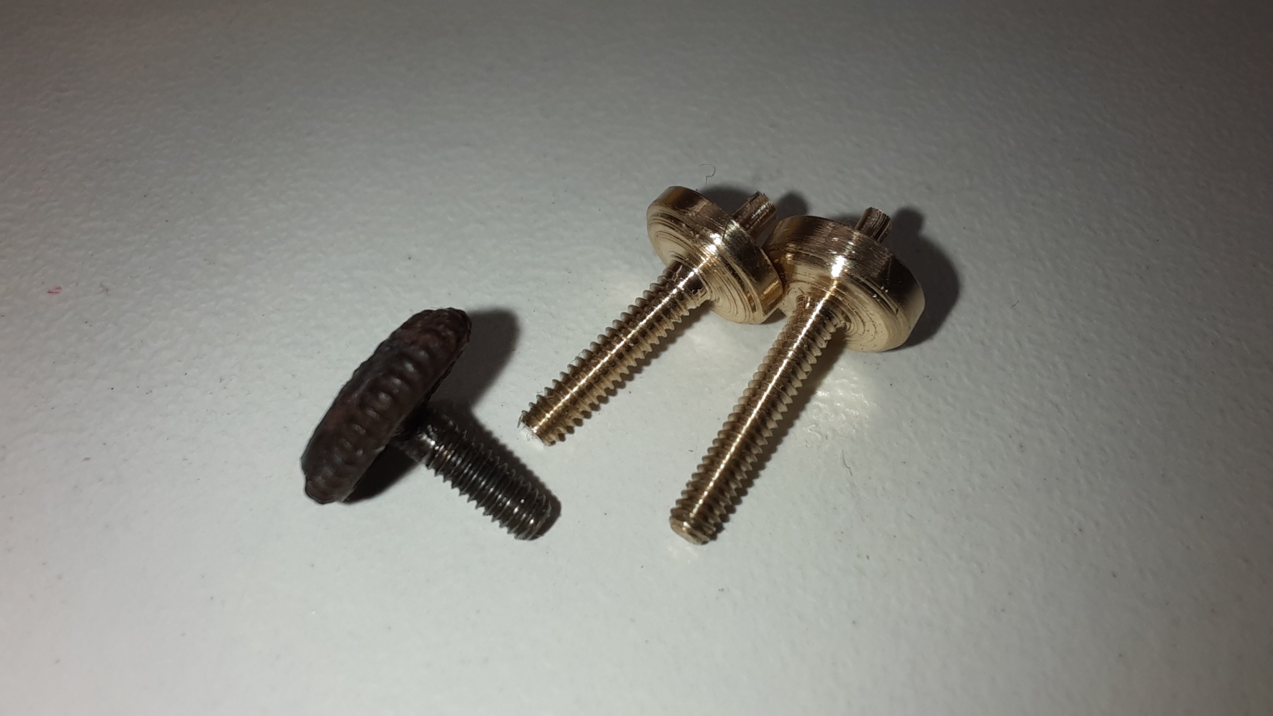

In my limited experience which has mainly been with British/European soundboxes, the BA size has actually proved to be the most used. They aren't a convenient TPI though, and with the very small sizes it is often very difficult to determine the correct thread.Governor Flyball wrote: Tue Jun 22, 2021 11:59 pm Another example of the earlier craziness is British 2BA vs US 10-32 screws. Outwardly they look identical: same diameter and similar thread pitch. However 10-32 is 32 threads per inch and 2BA is 31.6 threads per inch. A 2BA thread almost fits a 10-32 screw except it is a bit tight.
This raises the question of HMV vs Victor machines: did the UK variants uses British or American fasteners?
A case in point was when I recently made a (temporary) needle screw for a HMV 5A soundbox. I am sure I read on this forum somewhere that HMV used American threads. A 1-64 looked like it should have fitted, but didn't. A 1-72 to the naked eye looks the same but did fit. Of course that is no guarantee it left the factory like that. The hole could have been retapped, but in this case I think not
