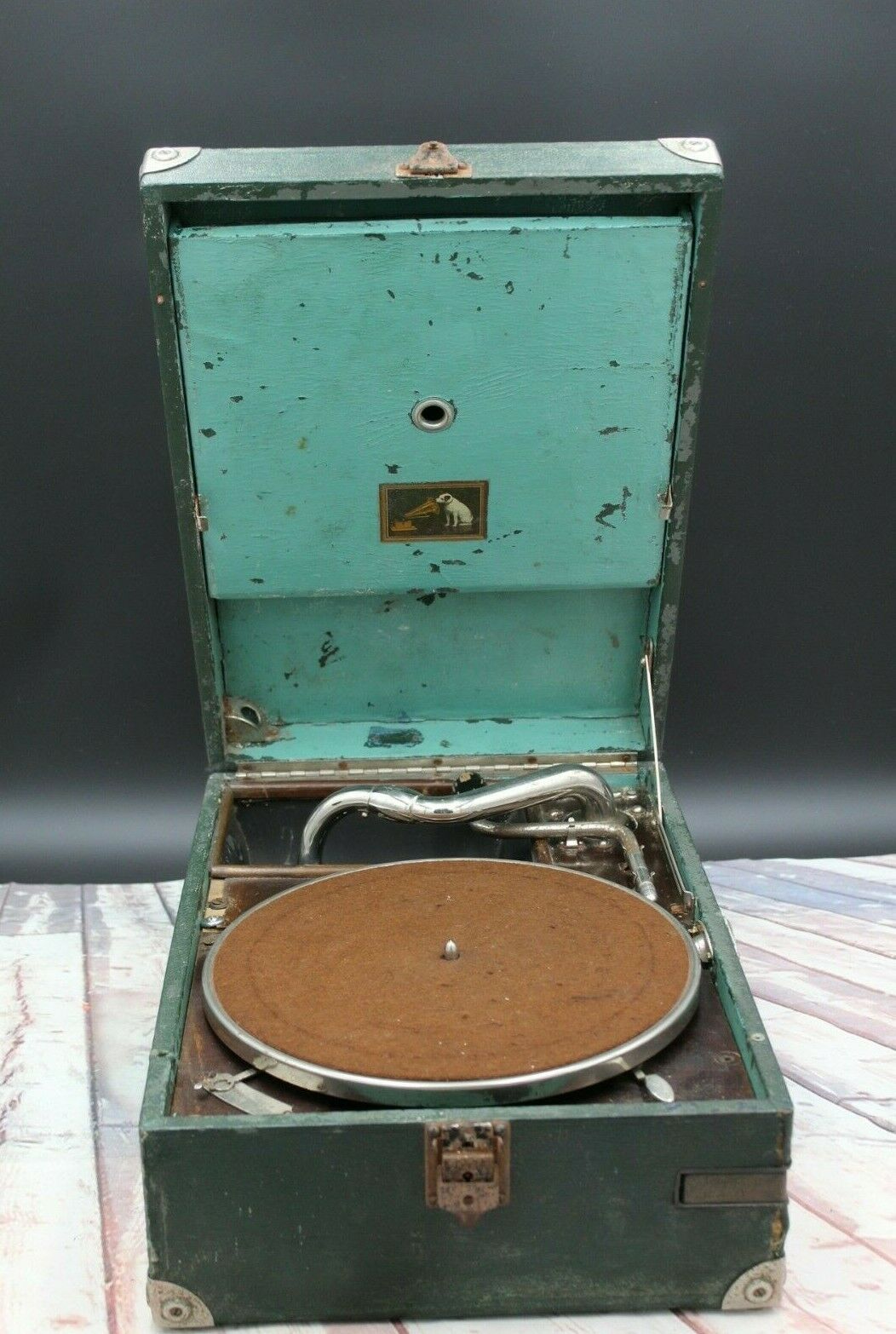

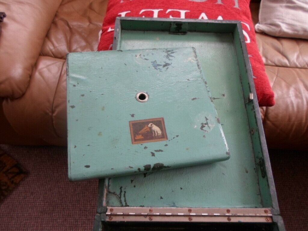

I can see from an old ebay posting (image 3) that it was once indeed whole but strangely had both the lid and the tone-arm-board winding handle clips - which, assuming that the clips in the lid were original, suggests that the innards in this image are not original to the case, which also possibly explains why someone had to drill a second hole into the side to fit the winding handle (image 4), which ALSO suggests that HMV did indeed make other slight changes to the machine over time, specifically to the dimensions/configuration of the motor board/tone-arm board, placement of motor etc etc etc. Which also suggests that I’m going to have more of a hard time finding parts to put this machine together (all of the complete editions that have the winding handle clips in the lid seem to be way more expensive and the ones with the clips on the board seem to be way more common) . Lots of also’s there.

Not sure if I was totally clear with my original post: I only own the empty case, the picture of it with everything else in it is an old eBay listing that I found - but that’s unmistakably the case that I’ve now got. And yes, I’m presuming it wouldn’t have been made with the clips on both the lid and the board, and also that the boards would have also been green as suggested, so it looks like at one point someone put all the innards of another machine into this case, and then at another point they were all taken out again. I’ve got a feeling that the clip on the lid is original, though it’s hard to say.

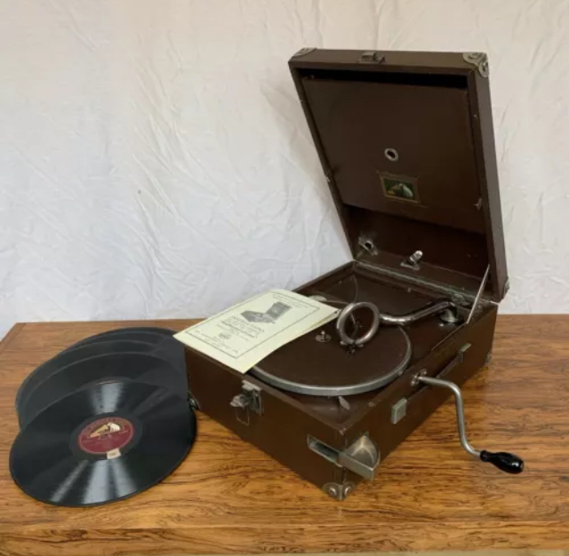

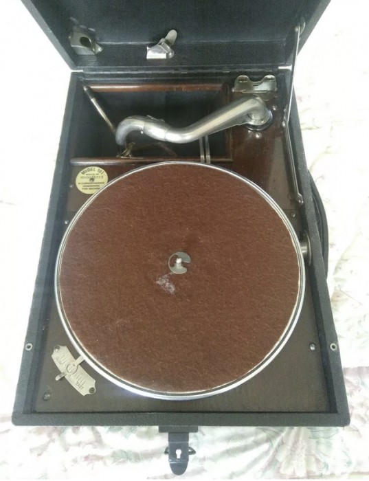

Posted a couple pics of 101’s with the clips in the lid - a lot of these seem to be coloured. The coloured ones came later right?
Toby
Toby
Posts: 4694
Re: The Evolution of the HMV 101
Toby, the last two photos aren't green 101s. The upper one is a black model, with wooden boards and black horn. The photo is bad, anyway. The lower photo seems to be of a brown 101.
The colored 101s had nickeled (or chromed, I cannot differentiate them, although gurus in this forum can) hardware, all except the luxury model in red leather which had golden hardware. Apart from this one and the black, later colors available were blue, brown, green, grey and red, all in rexine with silver hardware, and the felt of the turntable in same color as the rexine. Earlier colored models were brown crocodile-pattern and grey sneak-like (I may be wrong with the grey...). The greys I've seen or owned (rexine) were not really grey, the color was more like a bit yellowish... Seven different models in all.
Knowledgeable people here may correct me, I'm talking from memory. The same Dave Cooper has a great collection of colored 101s in different variants which were shown in exhibitions. The book has a photo of one of these events with that impressive array.
