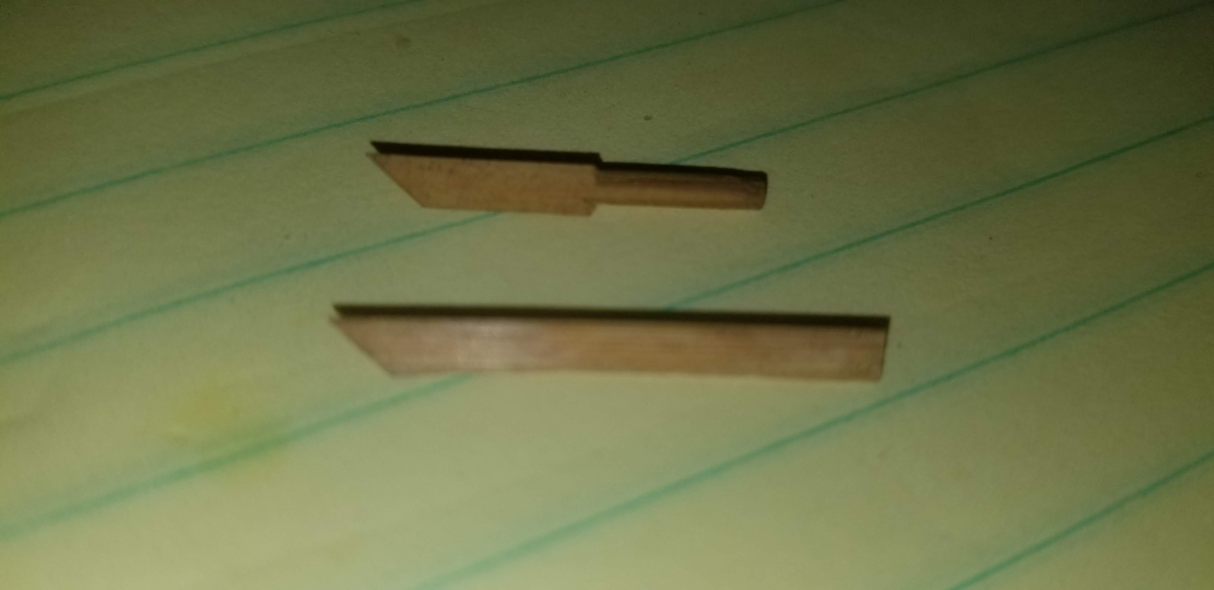

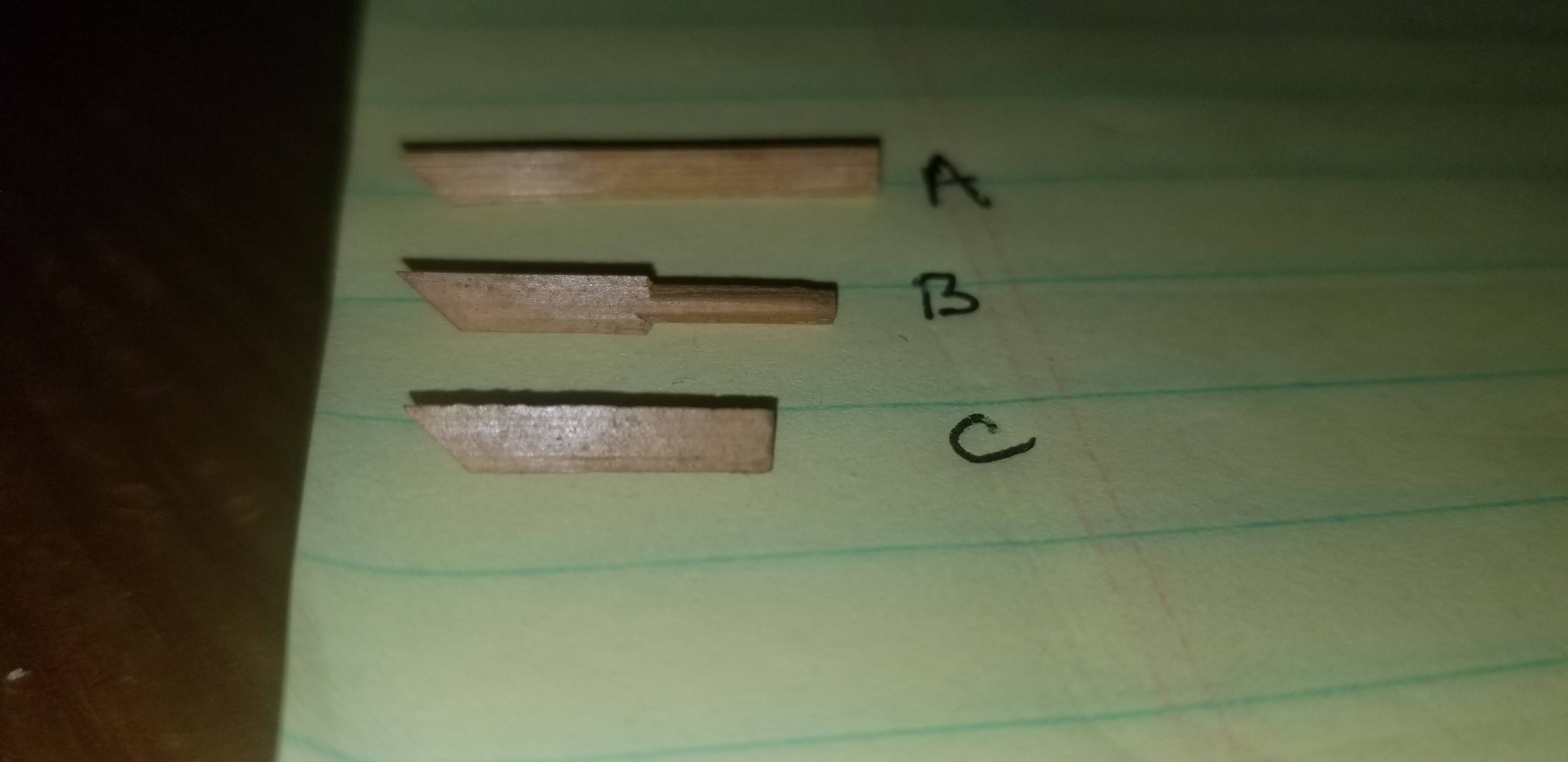

I have no experience with fibre needles, but I recently found, in a box of parts, a plain clear envelope with 103 fibre needles, as well as an Alto scissors-type cutter (which I imagine is quite common, so no need to post a picture of it here). On most of the needles the shaft is uniform all the way down (A), but on some it gets significantly thinner about halfway up, so it looks like a knife with a handle (B). A few are uniform but much shorter than the rest (C). I don't know if they started out looking like these or not, but since the examples are pretty uniform within each type, I suspect so. If anyone can tell me who made each one, I would be really interested to know.
So, I have many questions about this find: First, did people make their own fibre needles, or did they always buy them? If they made their own, what did they start with? Are fibre needles reusable? If so, how many times? Is the purpose of the cutters to make new needles, or sharpen used ones? If it's the latter, how often are you supposed to sharpen them? What is the proper way to do so? Why did/do people use fibre needles? What are the advantages and disadvantages of fibre vs. steel? And how does one properly position a fibre needle in a triangular Victor needle chock? In other words, what should the point look like hitting the record surface?

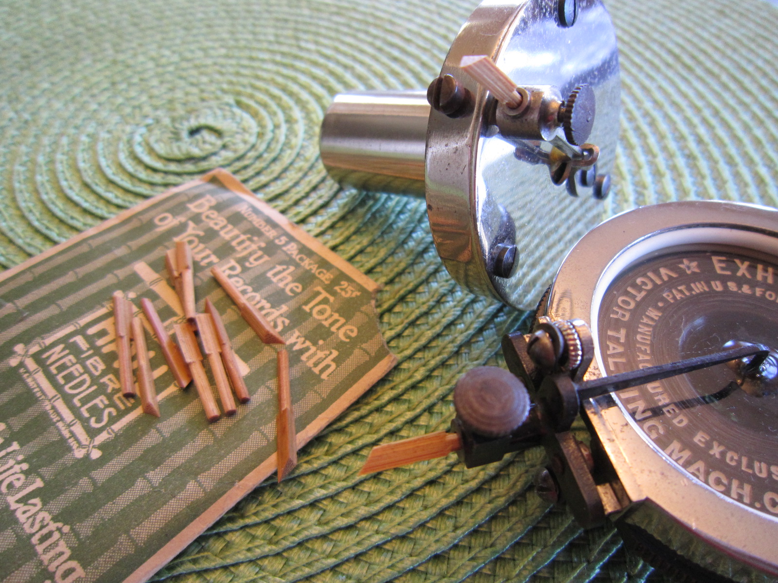

Here you go!
Long thin = softer volume
Short thick = louder volume
Round end = use on early round hole reproducers
Cheers, Bob S.

How many questions! And welcome to the marvelous world of fiber needles, in this case, the famous bamboo triangular needles.
Among all different types you apparently see, there's only one thing important. These needles are cut from the bamboo stick, in this triangular form, and if you look closely to them, they all have one side with the shiny and very hard outer shell of the bamboo.
This side is the one which plays the grooves. The triangular stick you'll see it's cut in a point; this point must be placed down, towards the record.
A thread wherre you can see the instruction leaflet for using bamboo needles.viewtopic.php?f=2&t=4410
You'll see there the most important information.
Since their invention, near 1906, many gramophone makers began to make the nedlechuck in the soundboxes with a triangular hole, so you could use these needles. But many others didn't, that's the reason of making some bamboo needles with the upper end shaped as a standard cylindrical needle, to be used in soundboxes that have the normal round needle hole in the chuck.
They are so useful and harmless to records (shellac, not vinylite) and their sound is strong and warm, very pleasant, as they filter out most of the hiss. Best is to play new records or in good shape. Some records are a bit rebel, and need to be learned to play with these needles, several attempts will fail, until the grooves are impregnated with the oily substance of the bamboo, or polished by the needles, so suddenly they will work. Worn records also don't go well, and will eat out the point of the needle before the side is ended.
Studying the shape of the point and your cutter, you'll discover how the needlepoint must be placed in the cutter to cut a new slice from the steeped point so you have a new fresh point.
Initially needles could be up to 1" long; you must insert them in the chucke of the soundbox so they protrude ½" or a bit less, like a standard needle. You'll find that you can play several sides until a strong music, a worn passage or simply the wearing out start to make it sound blurry, then you have to extract the needle and cut a fresh point. Other times the point will break in the middle of a record and play no more... it depends on the quality of the surface of the record. As you go on playing and cutting, the needle becomes shorter, so you have to insert it less and less, until it is too short to fit, then you discard it and take a new one.
The ones which are shorter may be from another brand, or that they have been already used and sharpened some times, so they are thus shorter. But if sufficient long, they still can be used.
