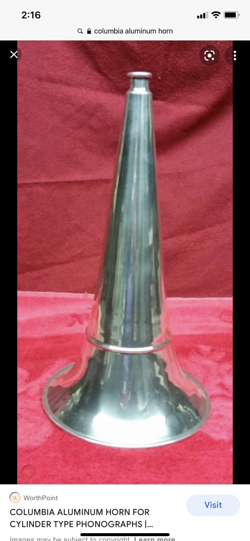

The original 14” Aluminum Columbia horns are hard to find. In nice condition they sell for around $275/$350. For that money you could buy a nice original crane and a large flowered horn.

They did make some nice reproductions of the Aluminum horns years ago now. They are also hard to find and sell for around $150

And thank you for the picture of the original horn

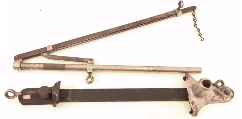

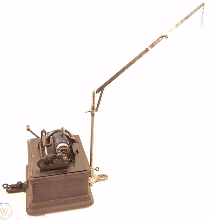

I would avoid anything that clamped on to that gorgeous cabinet. You might look for a free standing floor crane.I'd rather have the big horn with support. Not super sure on what to look for though.

There is a crane that works well with this Columbia cabinet. The best way to describe it is that it has a steel strap which runs under the cabinet, with a crane mount attached and a sliding "clamp" piece that holds it firmly to the outside bottom molding. I don't remember who made it, but it does not damage the cabinet and will support a large horn. Someone can probably identify the crane I am referring to...
I just found the base part for sale - all that is needed is an upright portion (most types will interchange).
