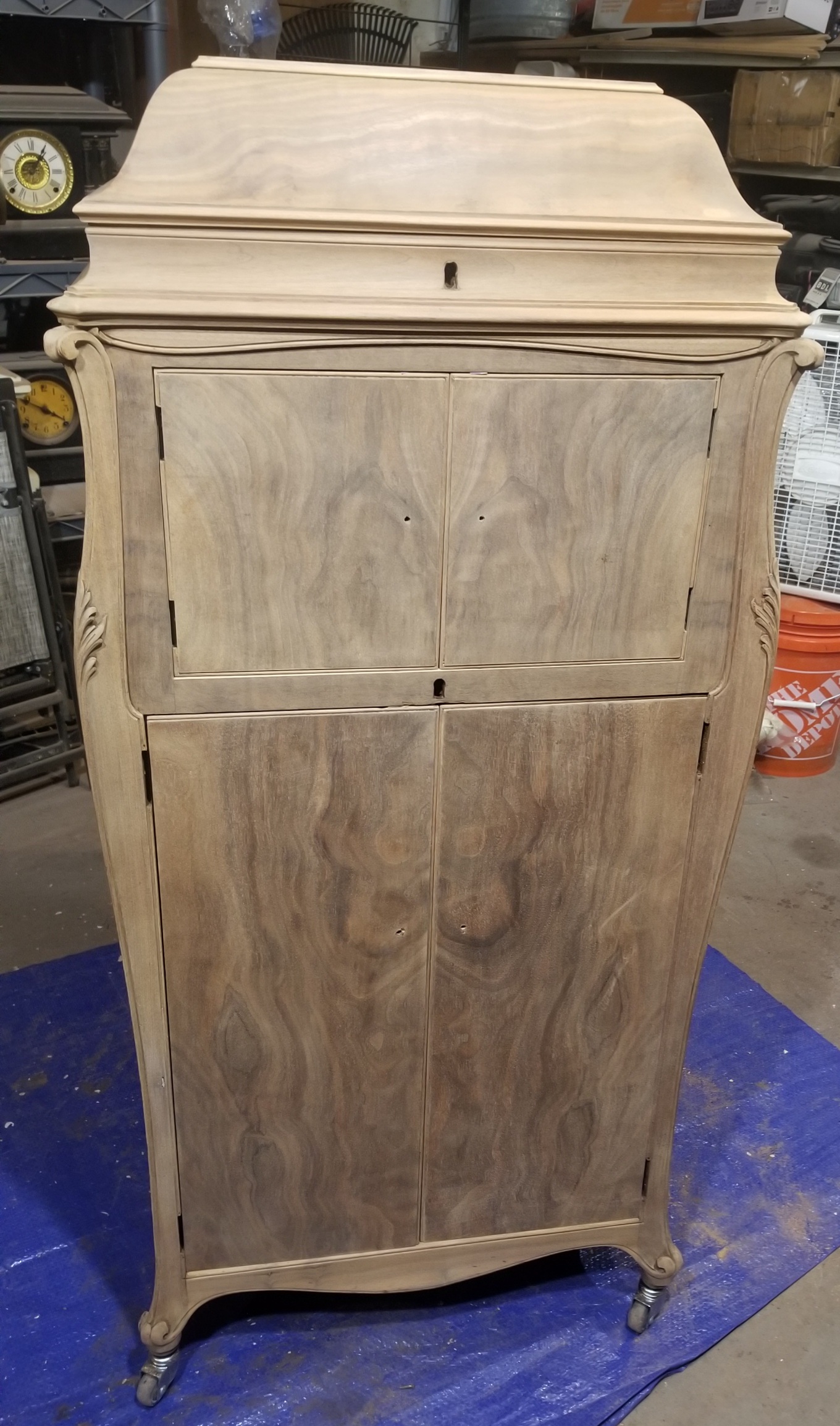

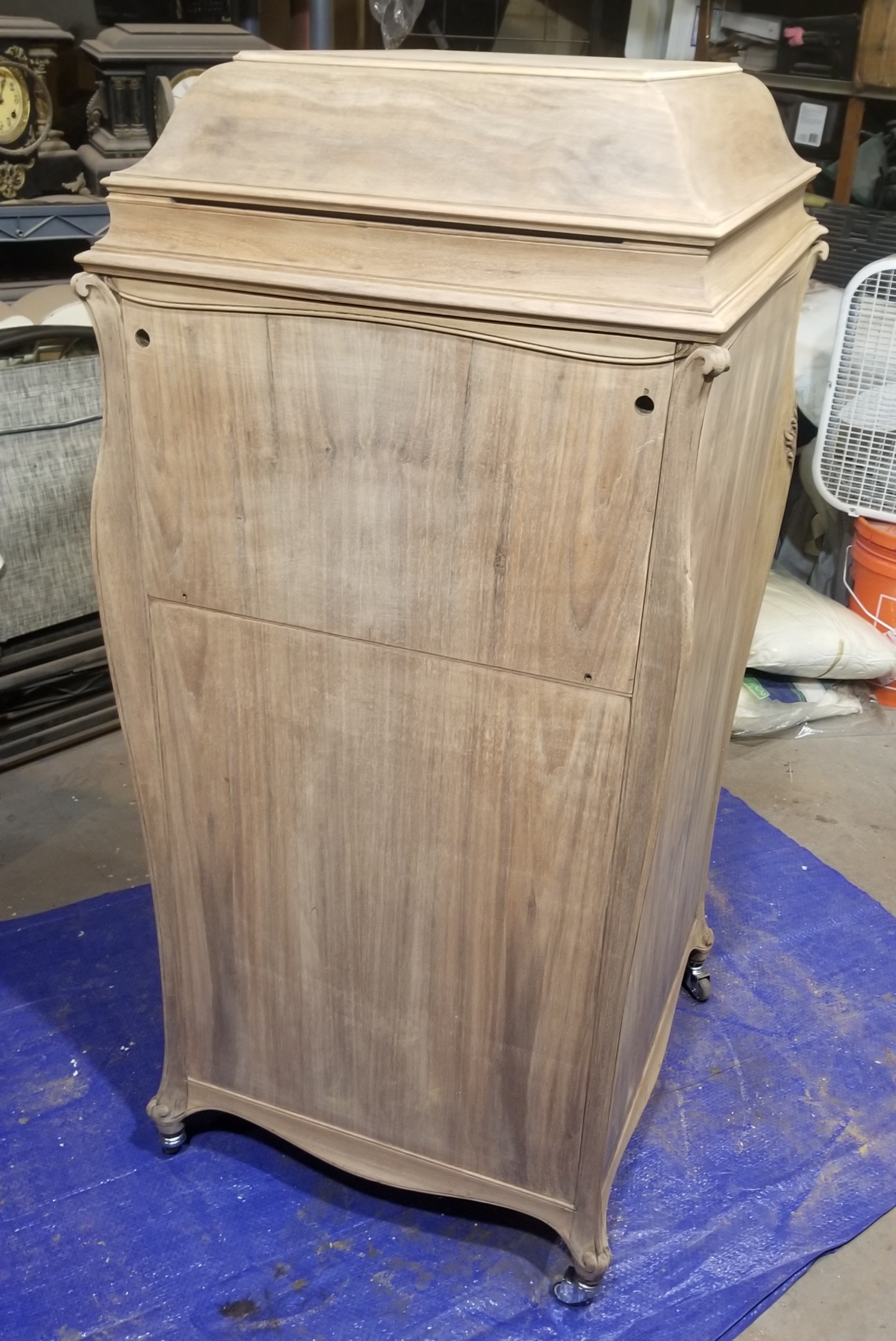

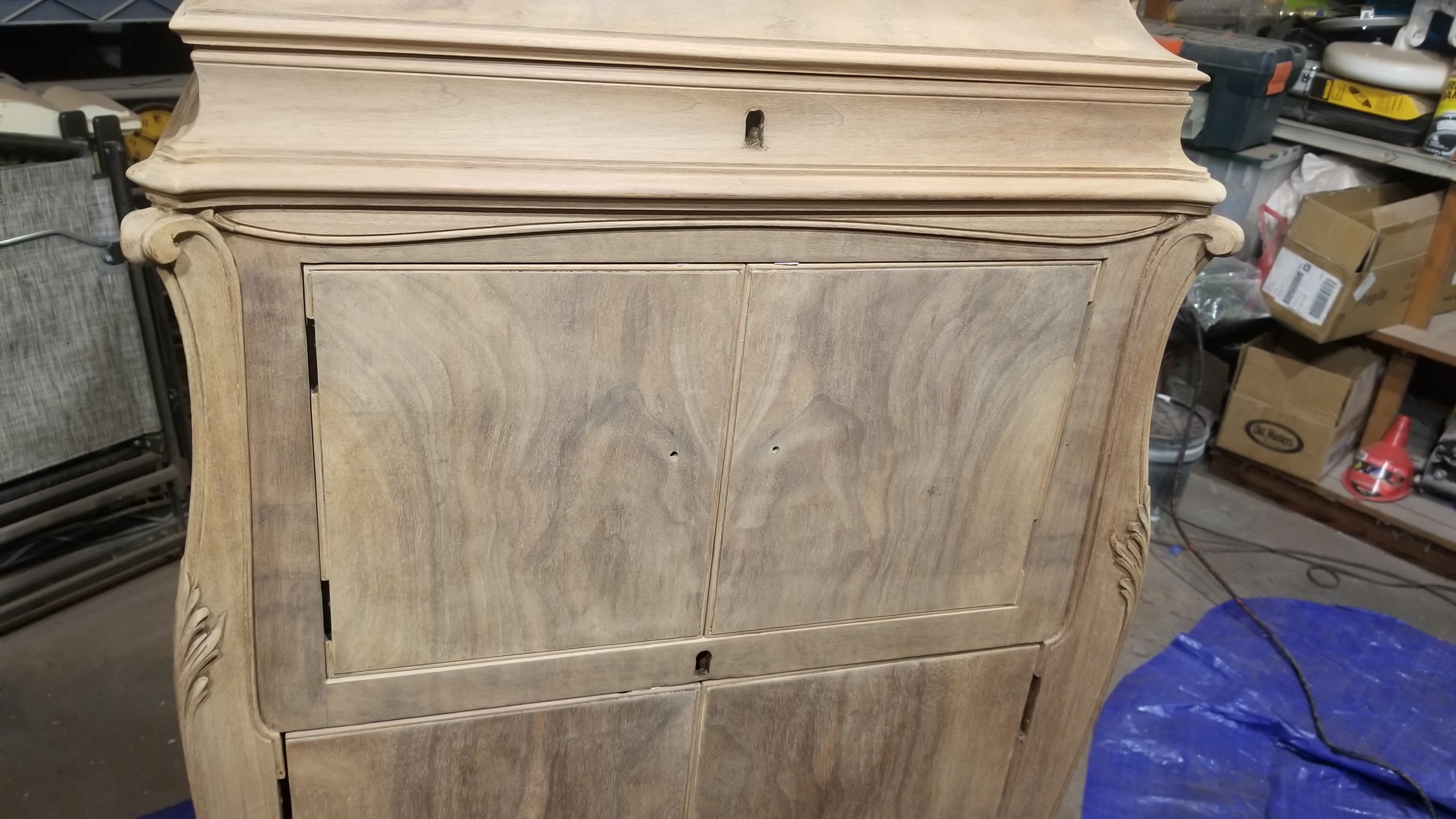

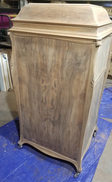

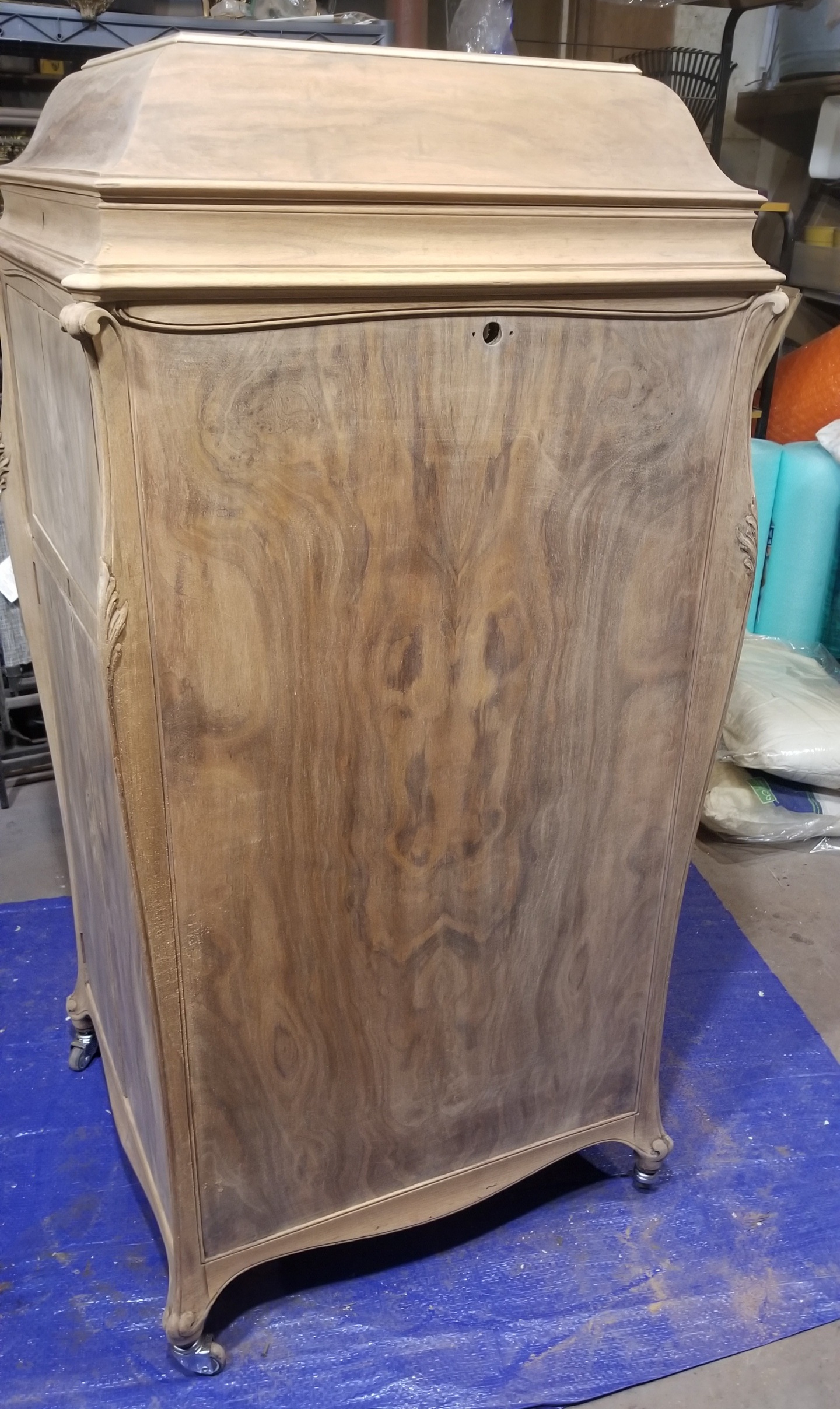

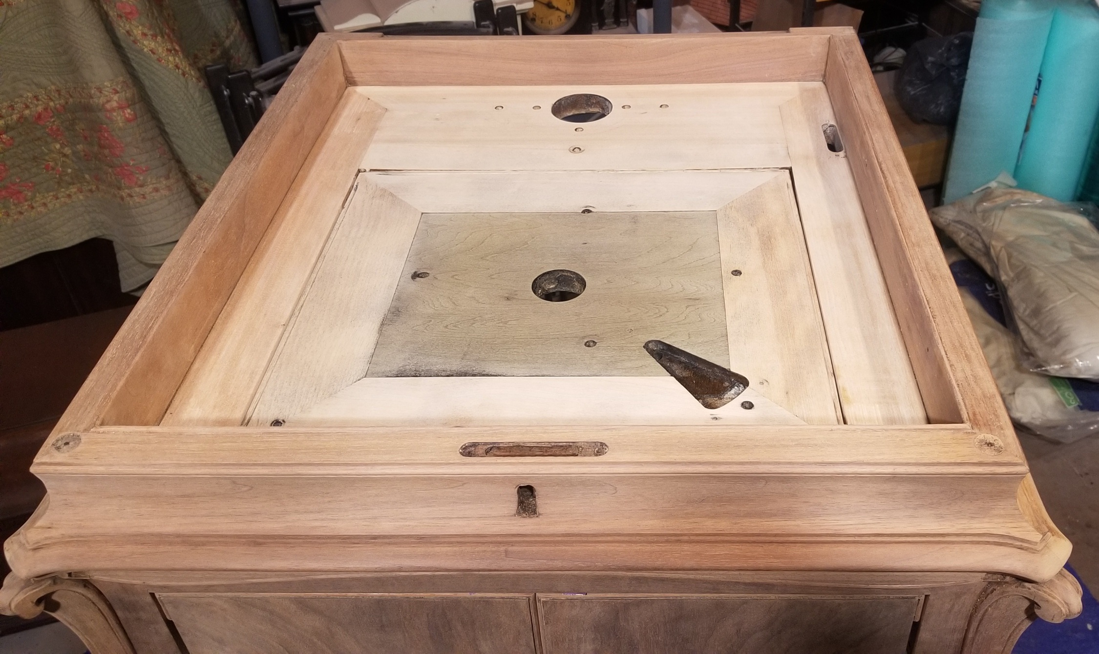

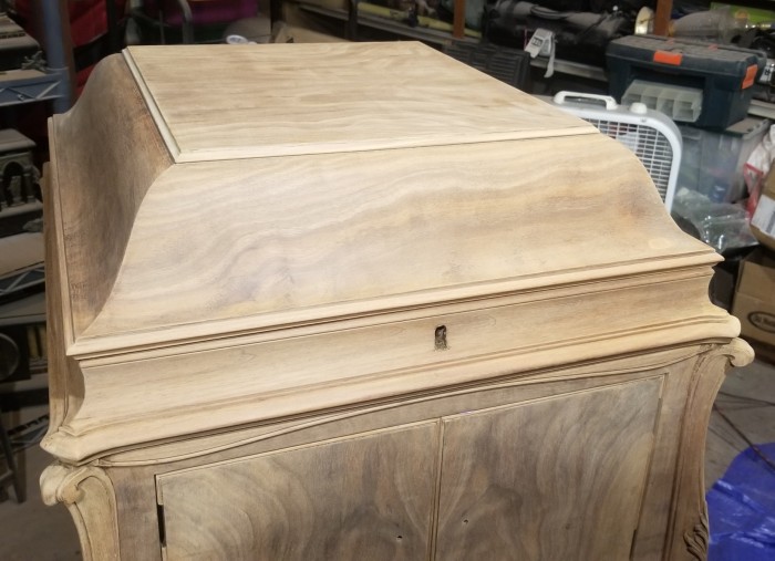

Finished stripping and sanding to 220 this 1917 XVI in American walnut and thought i would post pictures, really beautiful wood. Its going to be stunning when i add color and clear coats. The dye will really make all that grain stand out, stay tuned...

I've always thought that all the staining, varnishing, etc only serves to make the wood look as if it was soaked in water. I mean, Do you remember the look of the dry wood when you water it? Then all the grain appears, the wood takes that warm and bright color...
So what we do with the treatment is to make the wood look permanently that way! :D
Now, seriously... Johnsheff... We're eager to see the wonders you do to these machines again! Keep us informed. Thanks! ;)

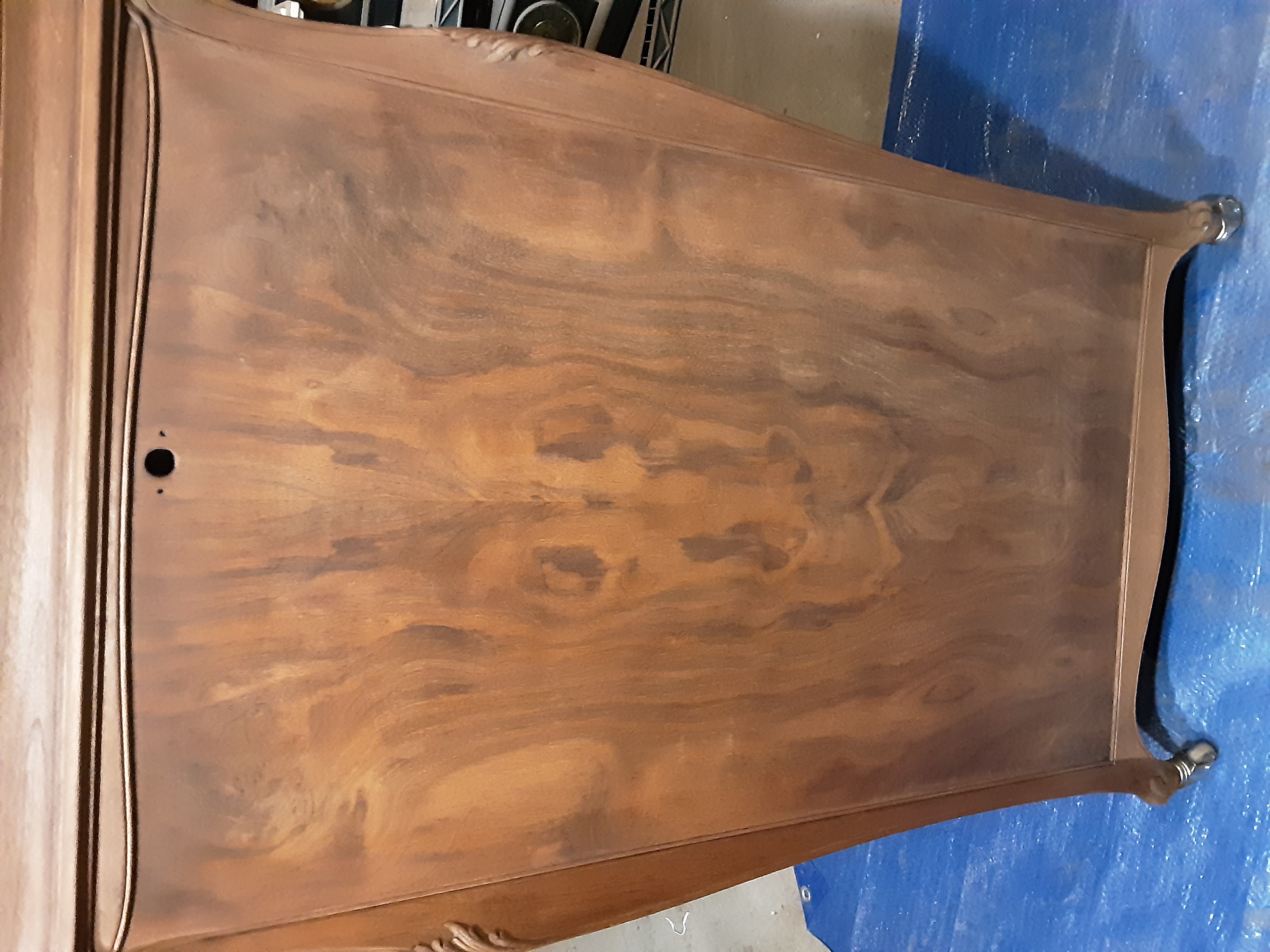

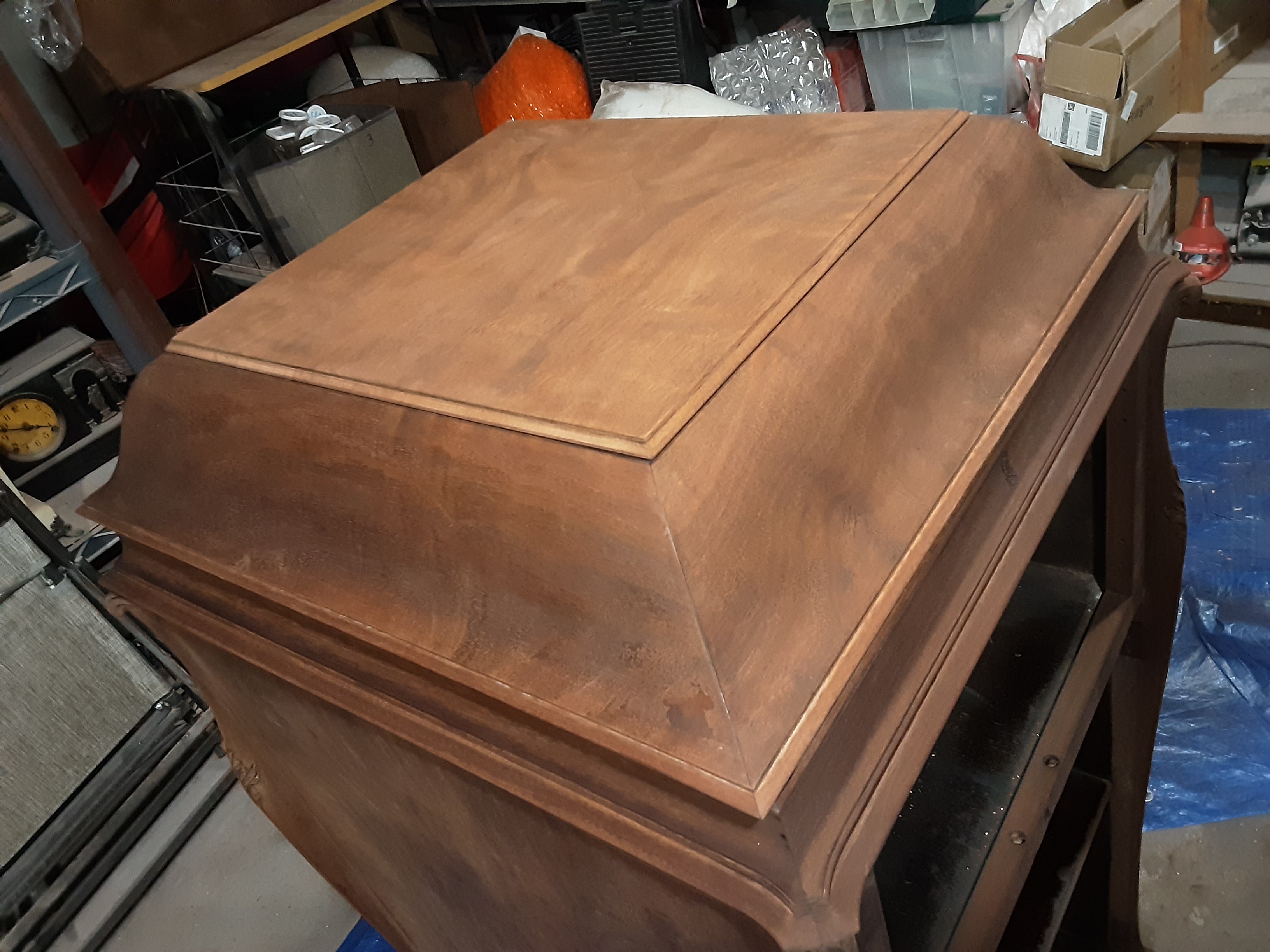

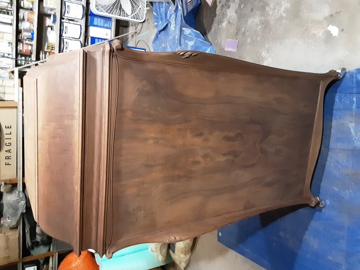

The
Here is the Mohawk dye sprayed on 75% diluted with double pass with the spray gun. For dye, spraying is the way to go for even streak free color. The next step is mohawk vinyl sealer then mohawk finishers choice satin lacquer to really make it pop. The clear coat really helps to protect the wood from who knows what this will be exposed to in the next 100 years. I think its goimg to hold up much better this time around. Will post more when i get the clear on.
Posts: 4671
Re: A 1917 XVI Victrola in Walnut - naked
The walnut 'faces staring at you' are starting to appear.... There's an 'another world' cross-eyed horse looking at us below the crank hole... :D At the opposite side, the same horse is starting straight!

Inigo wrote: Sun Jul 11, 2021 2:29 am The walnut 'faces staring at you' are starting to appear.... There's an 'another world' cross-eyed horse looking at us below the crank hole... :D At the opposite side, the same horse is starting straight!
Yea, i noticed it to, very strange figuring in the wood. It was not very noticible before because the finish was sun faded but really stands out now.
Victor VII
Posts: 100
Joined: Fri Oct 21, 2016 9:14 pm
Post by Victor VII »
This kind of figuring (especially where faces appear) is most often seen with Circassian Walnut. Let the usual Circassian vs American debate begin...
