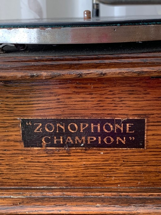

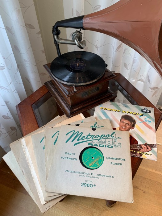

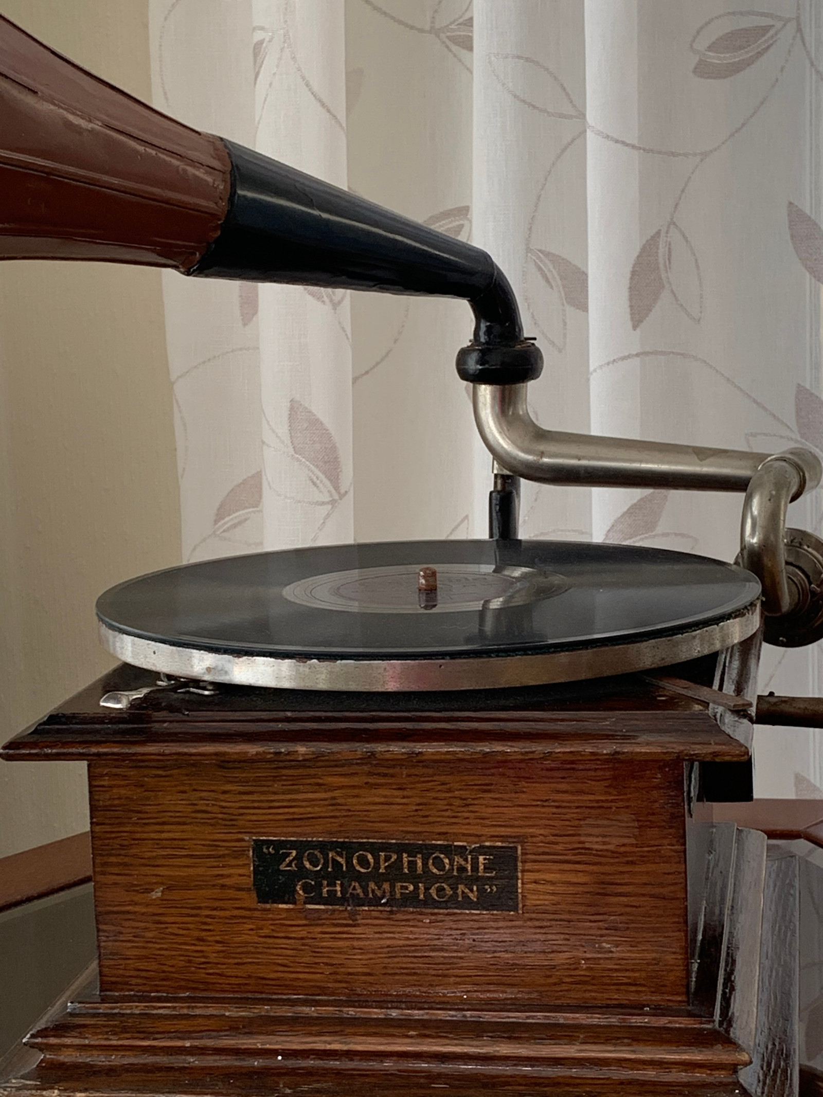

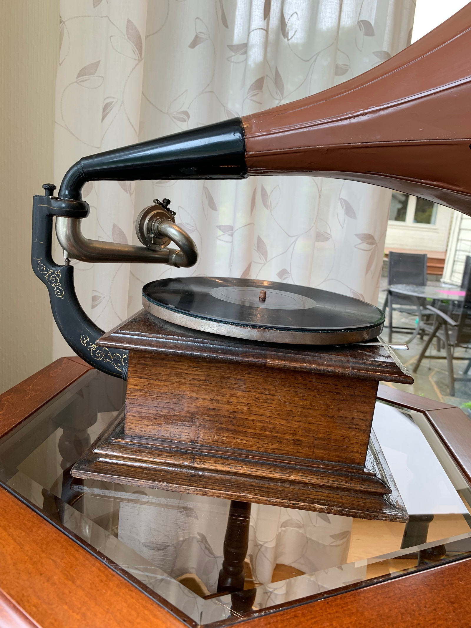

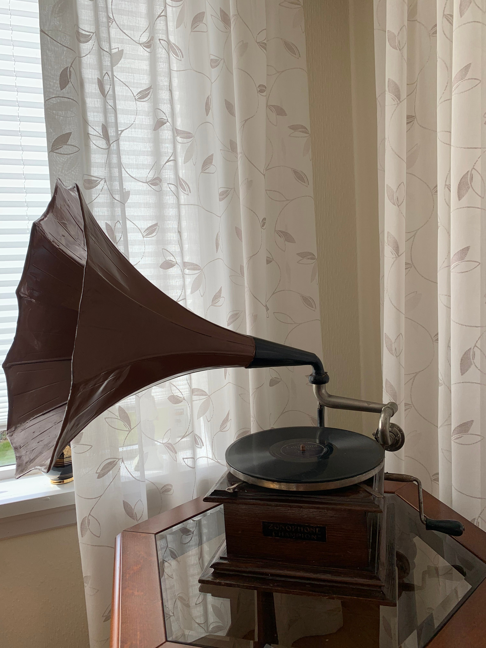

This beautiful horn gramophone is for sale in my area, priced at € 400.
I could not find good photos of the machine in my HMG book so I upload photos for reference, and wish my wallet was bigger right now.;)
Out of general interest, what price level are these sold at on auctions in the UK?
All this said, when taking a closer look, the winding handle seems positioned at a strange position to my eyes....or? And the turntable...seems far too big?

What looks strange about the crank? You have shown various views, but none showing the side with the crank...
The turntable looks too big, but that doesn't mean it was re-motored, just a change of turntable...
Are there extra holes in the case?

If you look at page 58 of HMG you will see this machine but badged for G&T so you can use these pictures as reference. Page 222 explains that the New Victor was also sold as the Zonophone Champion.
Perhaps the seller has been careful not to show the winding handle side...
The horn elbow, winding handle, brake, speed control and soundbox are not correct. Possibly, well likely, the machine has been remotored. I would avoid at 400 euros. Save your euros for another bargain!

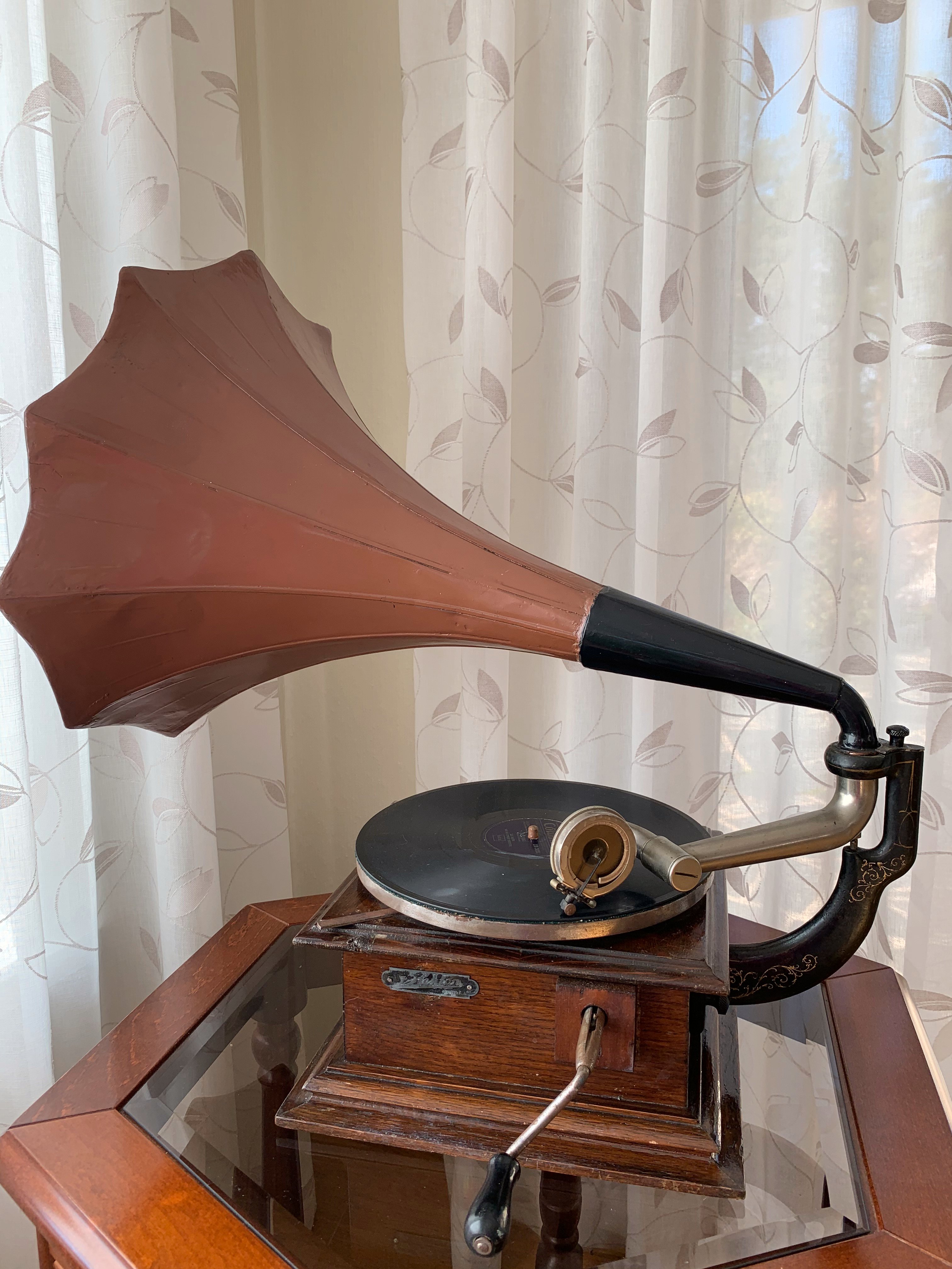

Thanks for adding your comments and observations, I was able to get in touch with the seller and he had no idea the gramophone was a frankenphone.
I am uploading the last photo received that confirms everything said. Re motored, monster...etc. It is a terrible photo, how someone could ruin a gramophone this way....
Interesting to know though that a complete and genuiine Zonophone Champion would not reach more than € 300 in the UK, I would have thought they were more sought after.
