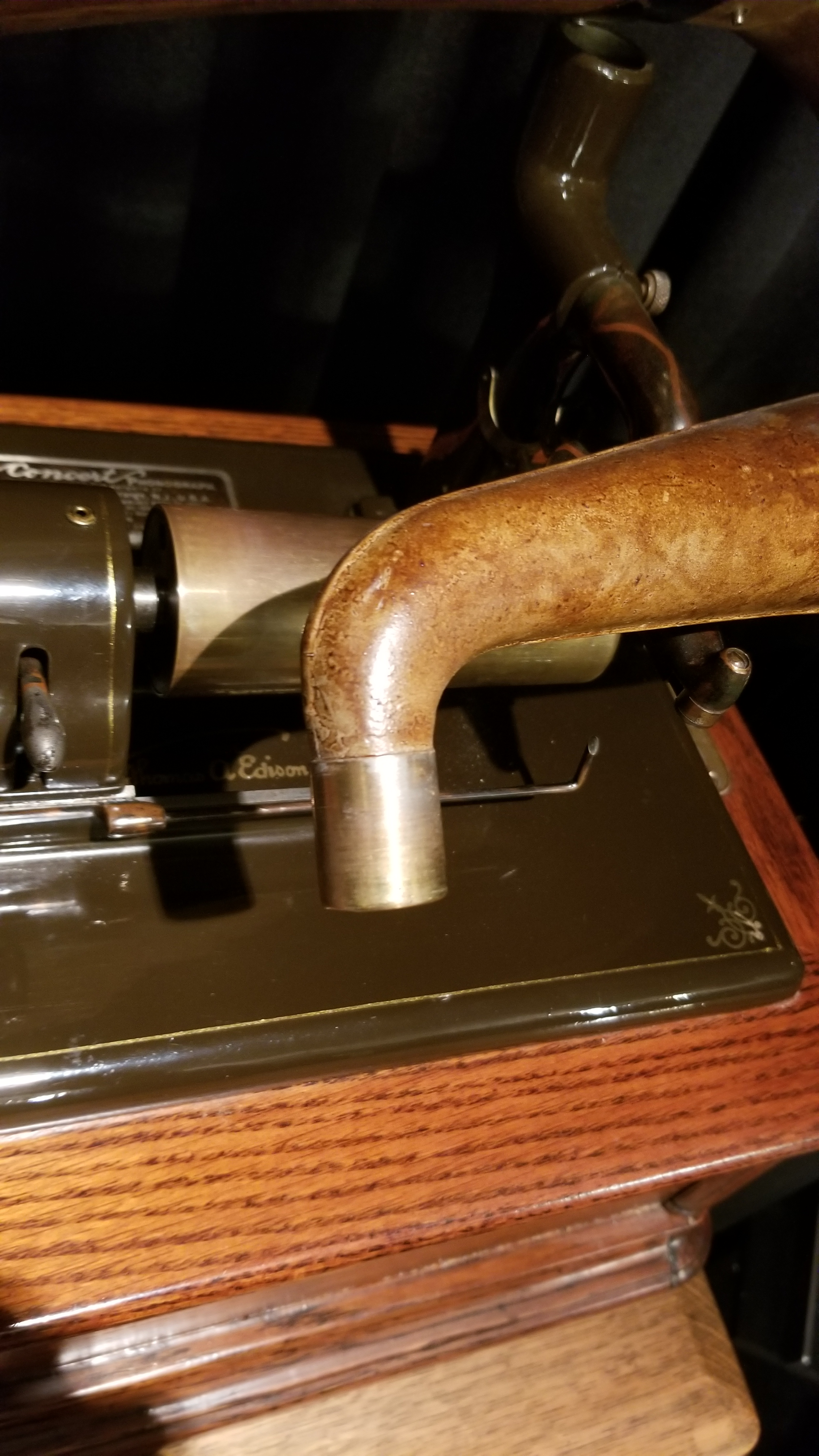

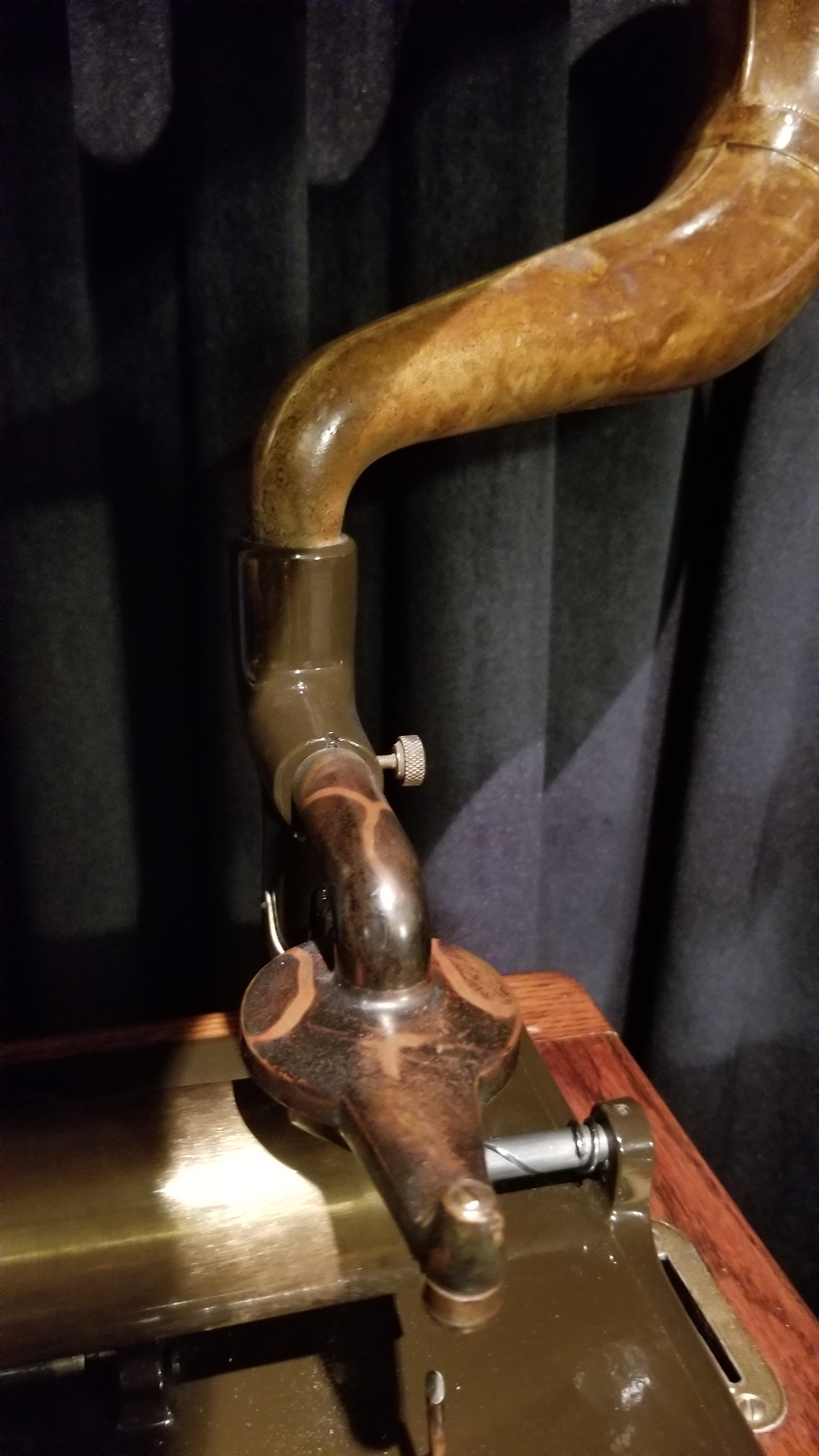

I am going to look at an Edison Opera (Concert) in a couple of days time with a view to purchasing it.
The seller reports that it is in perfect working order, but that the small end of the horn elbow has been modified or repaired in the past where it fits into the reproducer mounting.
Could some kind Opera owner please post some closeup pictures of the elbow fixing so that I know what it should look like, and can see what would be needed to restore it to it's original appearance.
Any other advice for a prospective Opera owner would be much appreciated. For me it will be a major purchase.
Roger.

Roger:
Here are a couple pictures of the horn connection on my Opera (tagged "Concert").
As far as purchase advice, look for cracks or seam separations in the horn. Check to see that the sliding autostop piece and small record brush (attached to horn stanchion) are present. These are expensive to replace.
The straight spring (resembling a short piece of wire) running through the mandrel shaft and flywheel (underneath the flywheel cover) is often broken but easily replaced. You can check this by turning the mandrel both ways and letting go while the machine is stopped. The mandrel should gently return to the rest position if the spring is unbroken. The motor should run very quietly with an even sound.
If possible play a loud-volume cylinder (Uncle Josh's loud talking is an excellent example) to see if you hear any pre or post "echoing." This would indicate a worn stylus that would need replacing and the expense should be taken into account.
Good luck, and I hope you post pictures if you get it!
Bob
