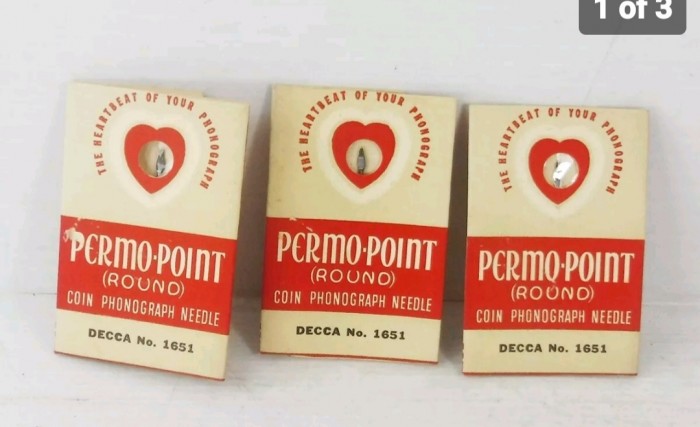

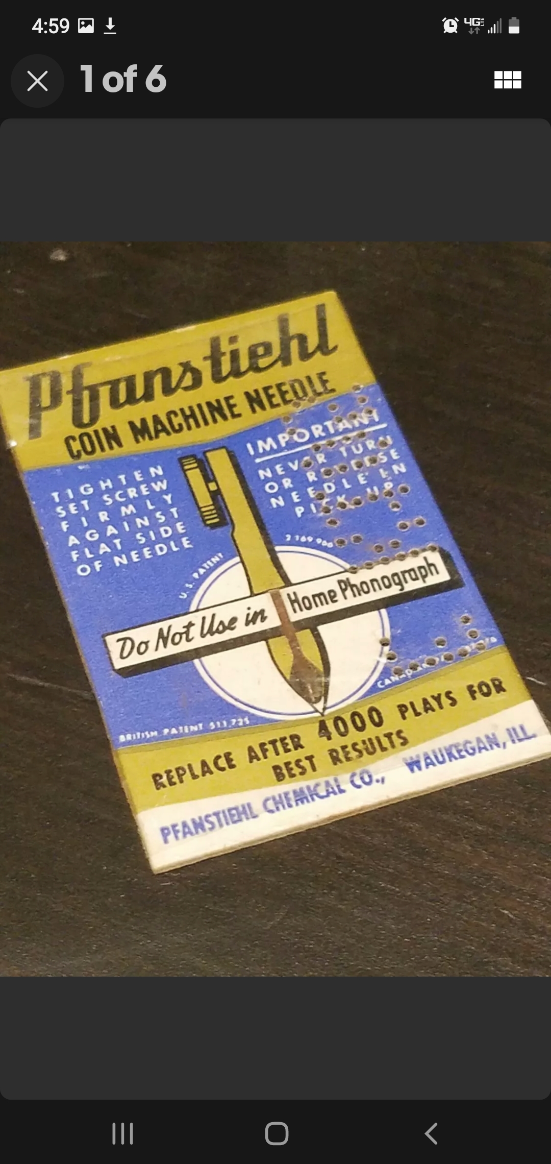

Ok I am really new to phonographs and would like to ask all the more experienced members what is the difference between a home phonograph needle and a coin machine needle? I see that the coin phonograph needles sometimes have a jeweled point. Then you have the "permanent " needles too. I saw that some coin phonograph needles say not for home phonographs. Can anyone please explain this to me.

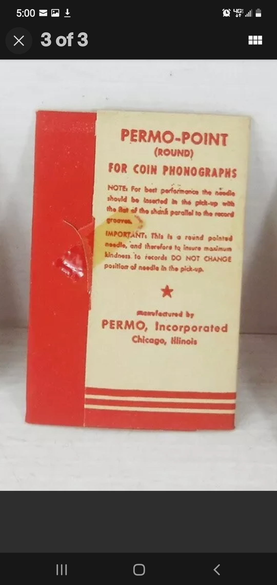

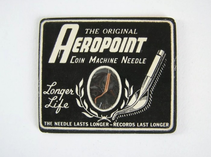

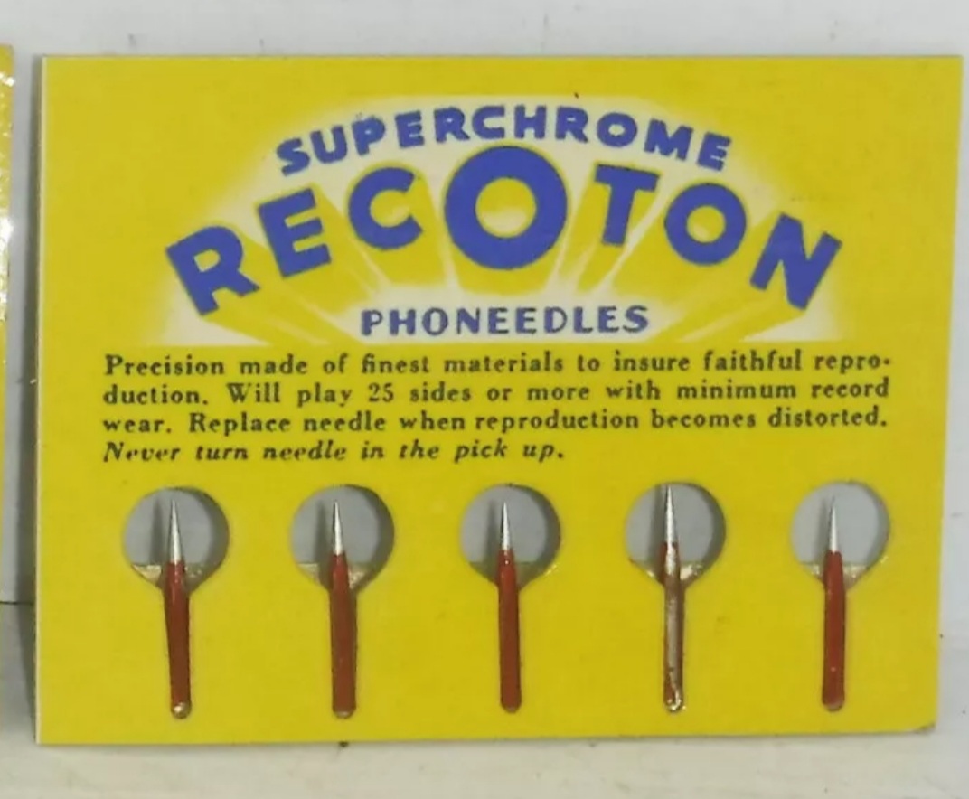

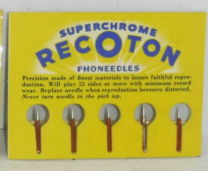

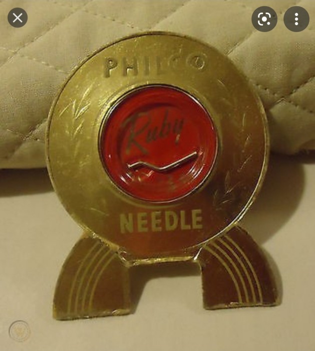

I saw some needles on ebay that I never seen before. A good friend of mine gave me a Philco ruby needle to try out. Thanks again you guys are great.

Most references to phonographs and needles on this forum refer to early wind up acoustic phonographs. The needle packs that you posted are mostly for commercial 78 juke box "coin machines" and that is a different subject.
The statement "Do not use in Home phonograph", does not refer to an Edison "Home" phonograph, it just means they are not made for home use in a typical consumer type phonograph.

I tried the ruby needle and the surface noise was almost unnoticeable. It sounded really good. Just wondering if it's going to damage my records.

Yes, it will damage them. I would suggest going in & buying proper steel needles, and then try some fiber or thorn needles eventually to see how you like them.BigC wrote: Mon Aug 02, 2021 9:19 pm I tried the ruby needle and the surface noise was almost unnoticeable. It sounded really good. Just wondering if it's going to damage my records.
