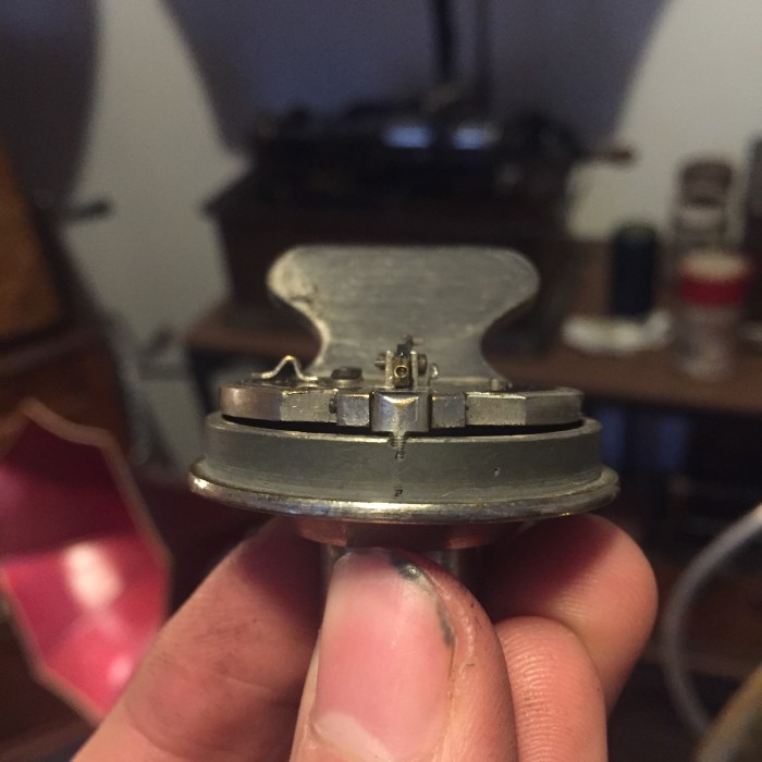

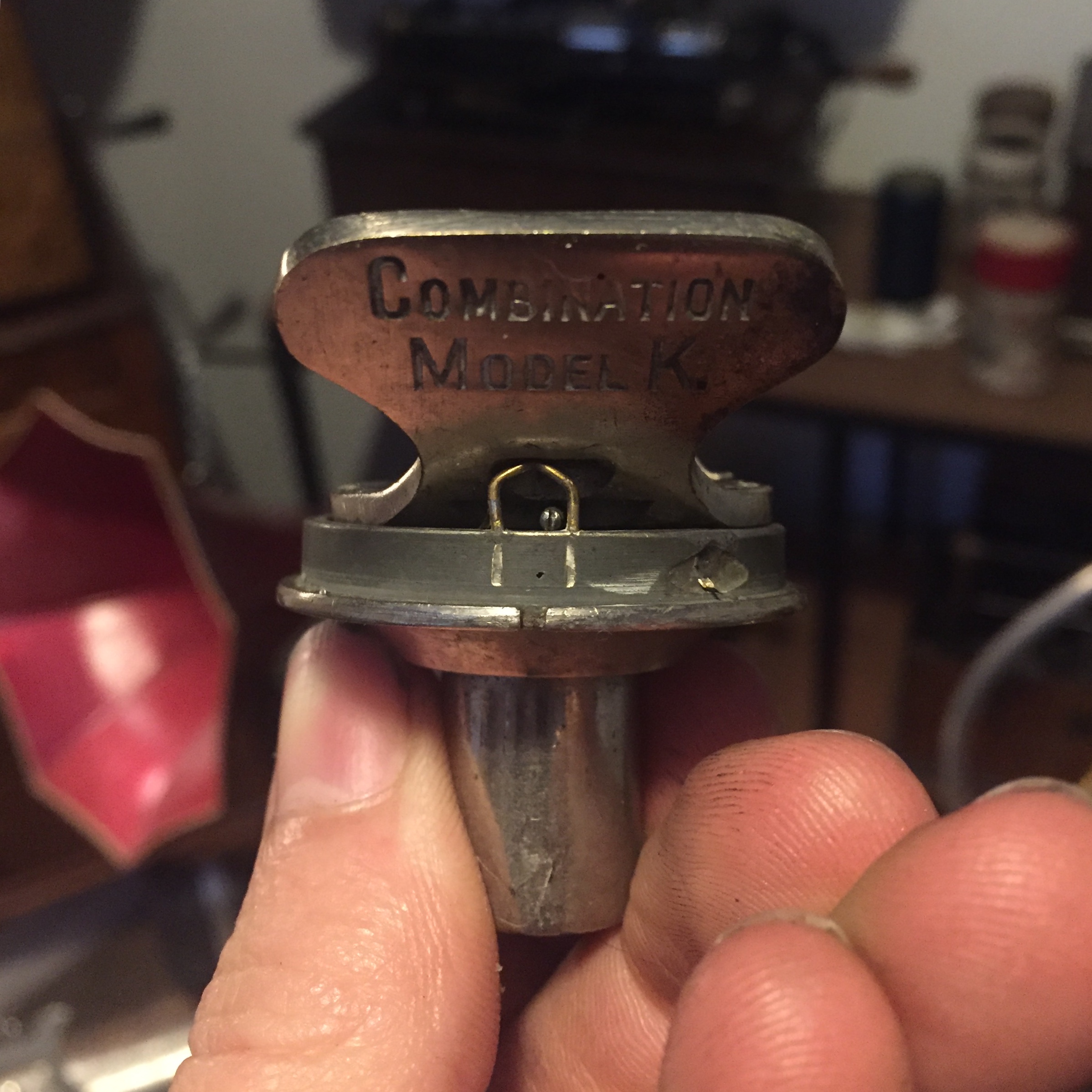

These photos may show why I’m rather fond of the idea of switching bodies, theres very little supporting wall for the thread or limit loop

I see that the wall is thin at those two points but when in the carriage this should not be an issue. I would consider leaving it as is for now. If something should happen to it at a later date you always have your option of swapping out the body.
Rich Gordon
Rich Gordon

And why the wall is so thin? Did you grind it out something? Or it was originally this way?
If there is room for it, you could add a layer of jb weld or something to strengthen it, then grind and polish to have a reinforced wall. Still you preserve the original with a bit of visible repair, not a bad arrangement...

Read the original post.
“ someone at some stage has chucked it in a lathe and shaved some from the outside of the body to keep it in service”
Rich Gordon
