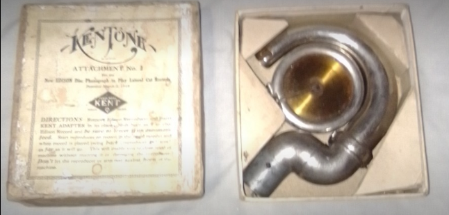

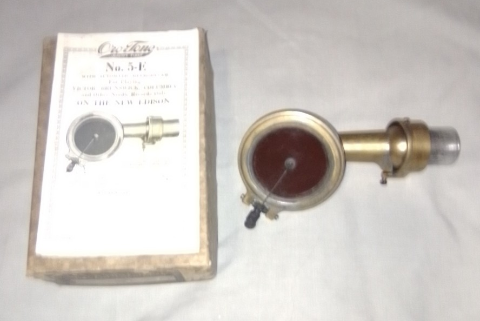

I've got 3 lateral adaptors.
An Oro-phone No.165
An Oro-tone No.5E
And a Kentone No.2
None of mine are designed to play vertical cut discs, so only play ordinary 78 records.
The Kent adaptor doesn't have the original soundbox so I use a German "Portuna", which is an oversize Victor/HMV No.4 copy.
The Kentone 2 is the one I like best, mainly because unlike the others it's not made entirely of potmetal.
The joints all move freely but I did have file a tiny amount off the end where it fits into the neck of the Dimond Disc horn so it will seat properly.
I had to do the same to the Oro-tone 5E.
The 5E however can occasionally skip a groove because it doesn't have much lateral movement to compensate for the difference between the feedscrew and record groove.
I've never encountered any problems at all with either the No.165 or the Kent.

- Oro-tone No.5E
- Screenshot_20210824-234456.png (140.84 KiB) Viewed 929 times
- Kentone No.2
- Screenshot_20210824-234317.png (244.62 KiB) Viewed 929 times

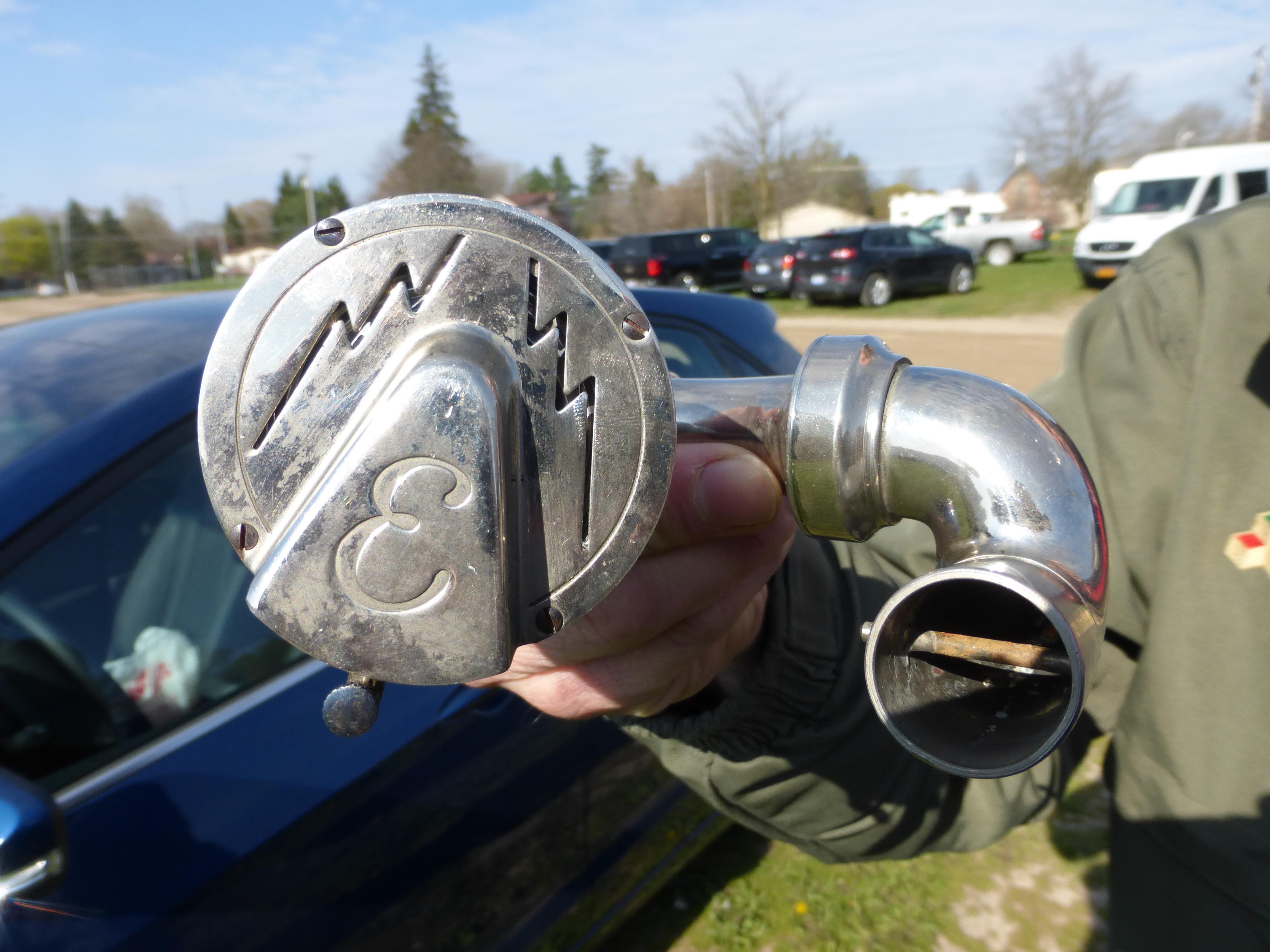

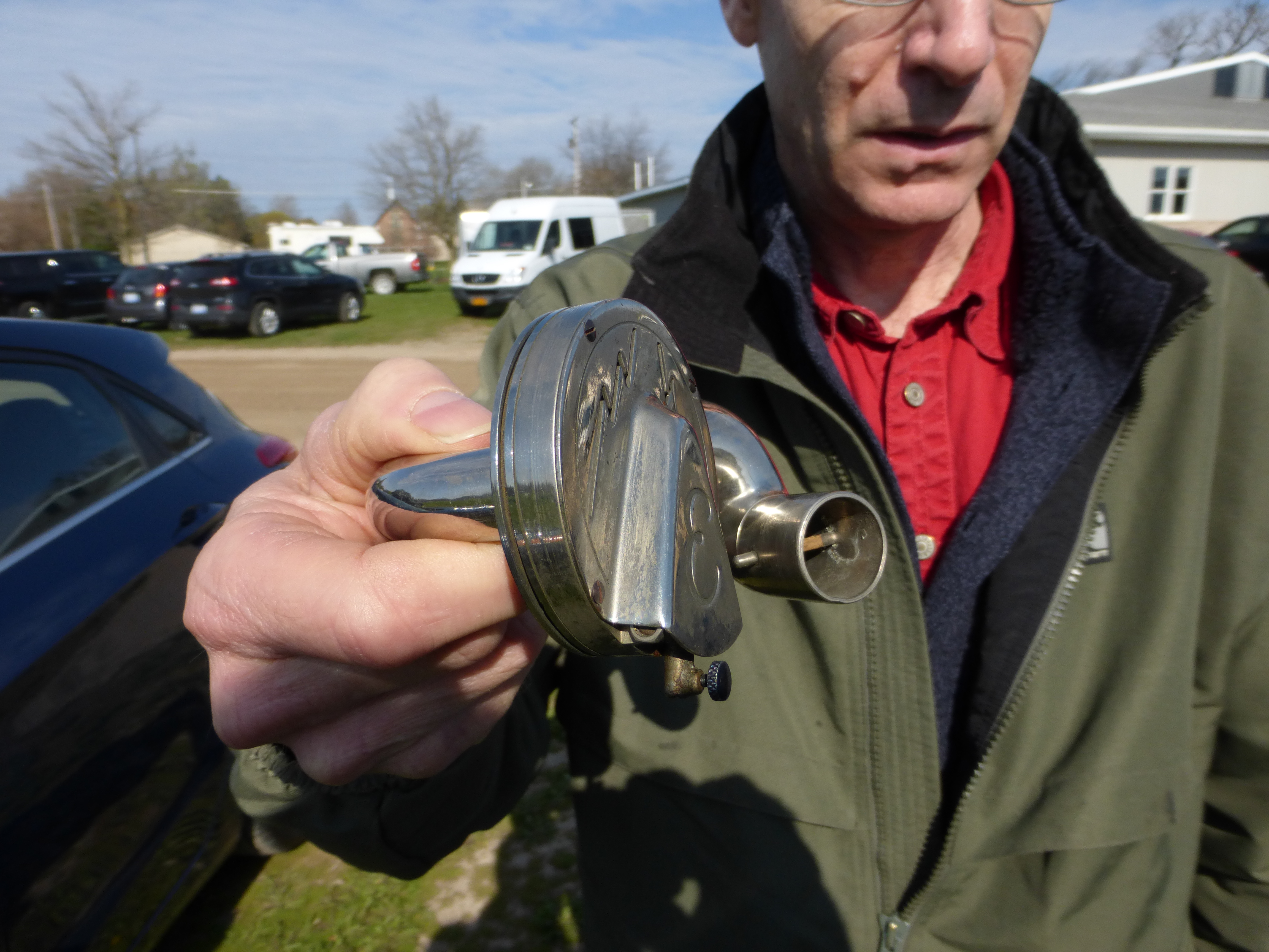

I did find one that works very well for 78s on an Edison DD player. It is the Orophonic, made by the Oro-tone company, and was made to sound like a Victrola orthophonic. It plays 78s very well. Edison made one just like it to play his new 78s on DD machines, except his has his name on it. I also have some of the earlier ones which mostly are not satisfactory.
