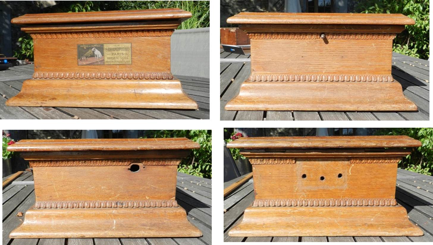

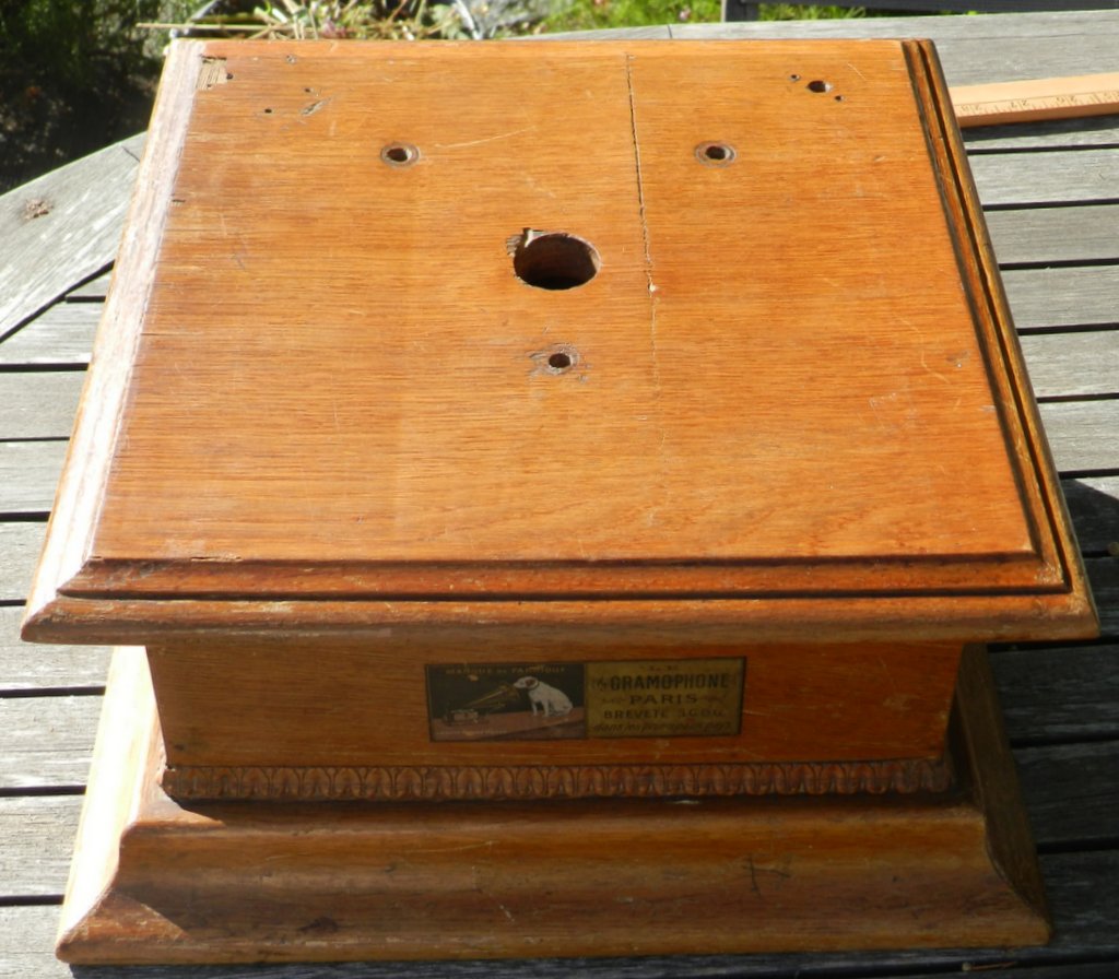

A friend of mine found this nice but empty cabinet. Considering the logo and the fact that it is a back-mount model, I think that it was made around 1904/1908 but I don’t know which model it is.
Dimensions: 33 by 33 by 16.5 cm (13" by 13" by 6.5”). The same dimensions than the Vic I but a different cabinet. I don’t know either if it was a single or double spring.
Thanks a lot for your help,
Jeff

I'm pretty sure it was single spring. It's the French version of the Junior Monarch.

Steve is right this a French Junior Monarch.
This is larger than a Victor 1 though, which is normally around 11 inches square and not as high. Junior Monarchs always had single spring motors. The condition of the case looks generally nice.
Jamie
