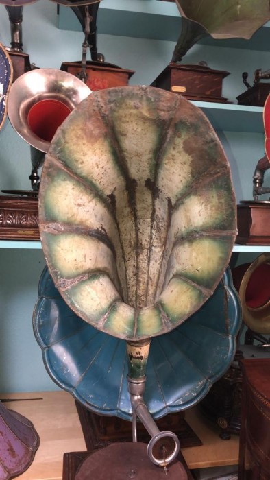

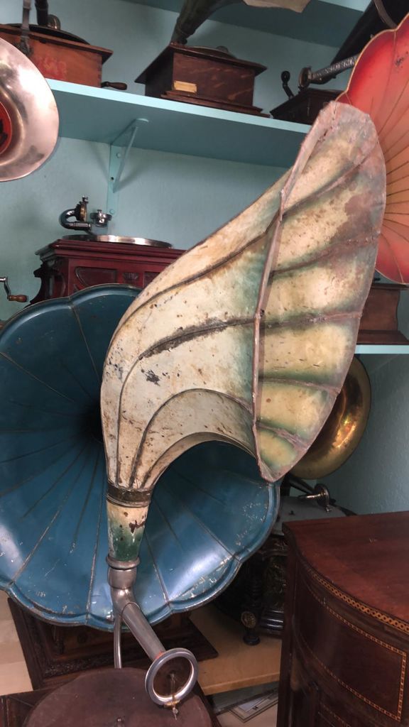

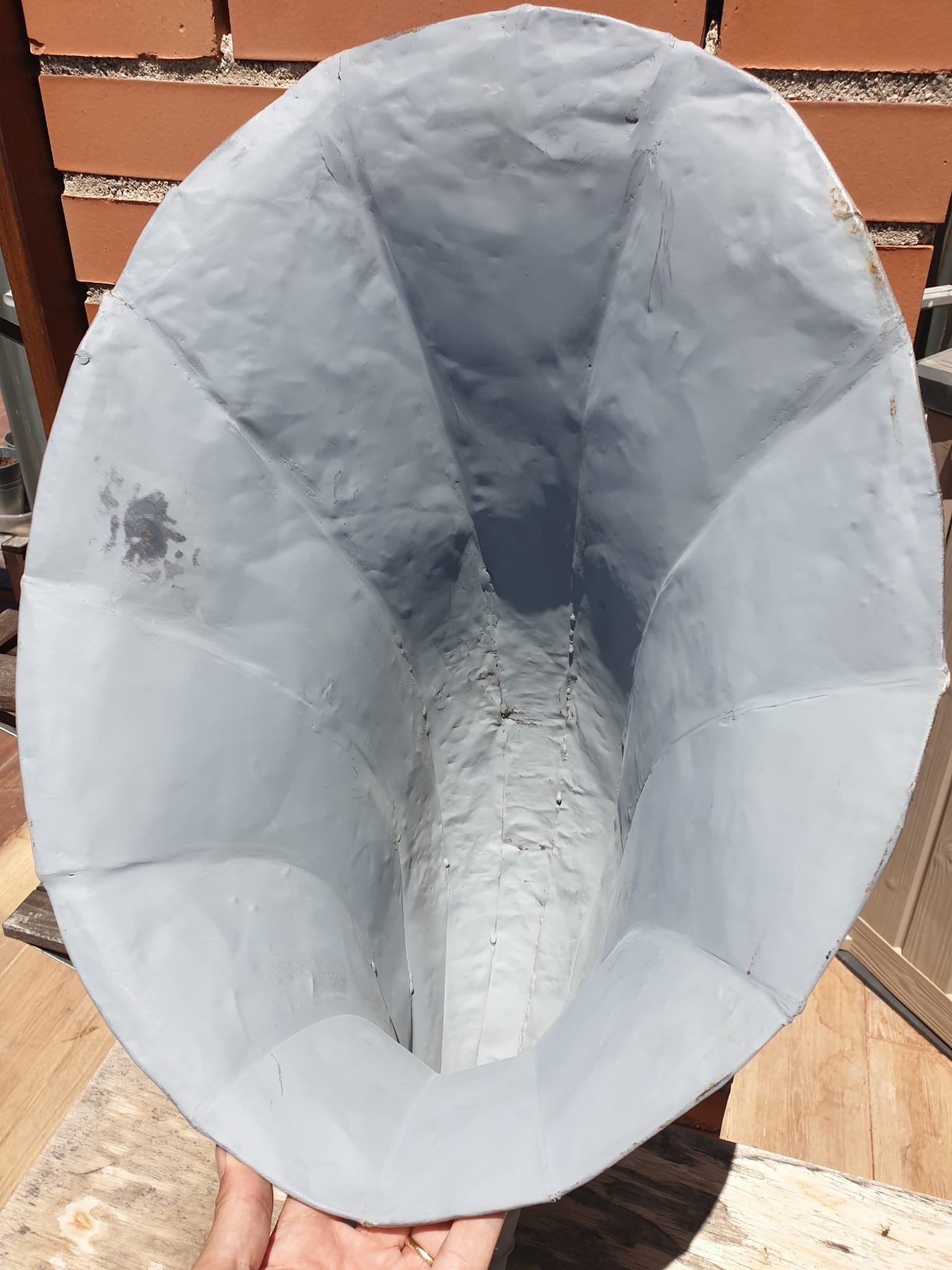

All began around one year ago when a friend asked me If I could restore a very derelict horn of a Mecanophone he recently bought. The horn was heavily rusted, had lumps of lead and tin everywhere and was severely corroded to the point of been perforated in many places. And it had wrinkles like a crushed paper sheet everywhere and the lower cone was crushed.
I told him that it was on the very edge of not been salvageable. He suggested me to use bondo and paint over it and I told him that bondo was not an option for me. In any case, my agenda was full for the next several months so I didn't accept the job.
This was the horn:

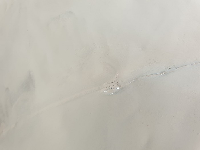

Second chapter: Things cannot get worse.

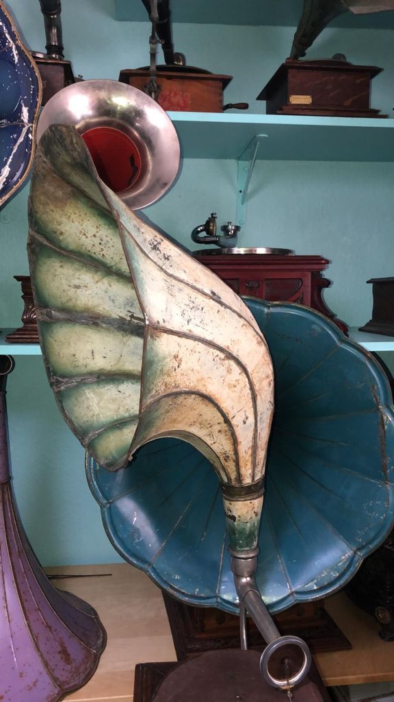

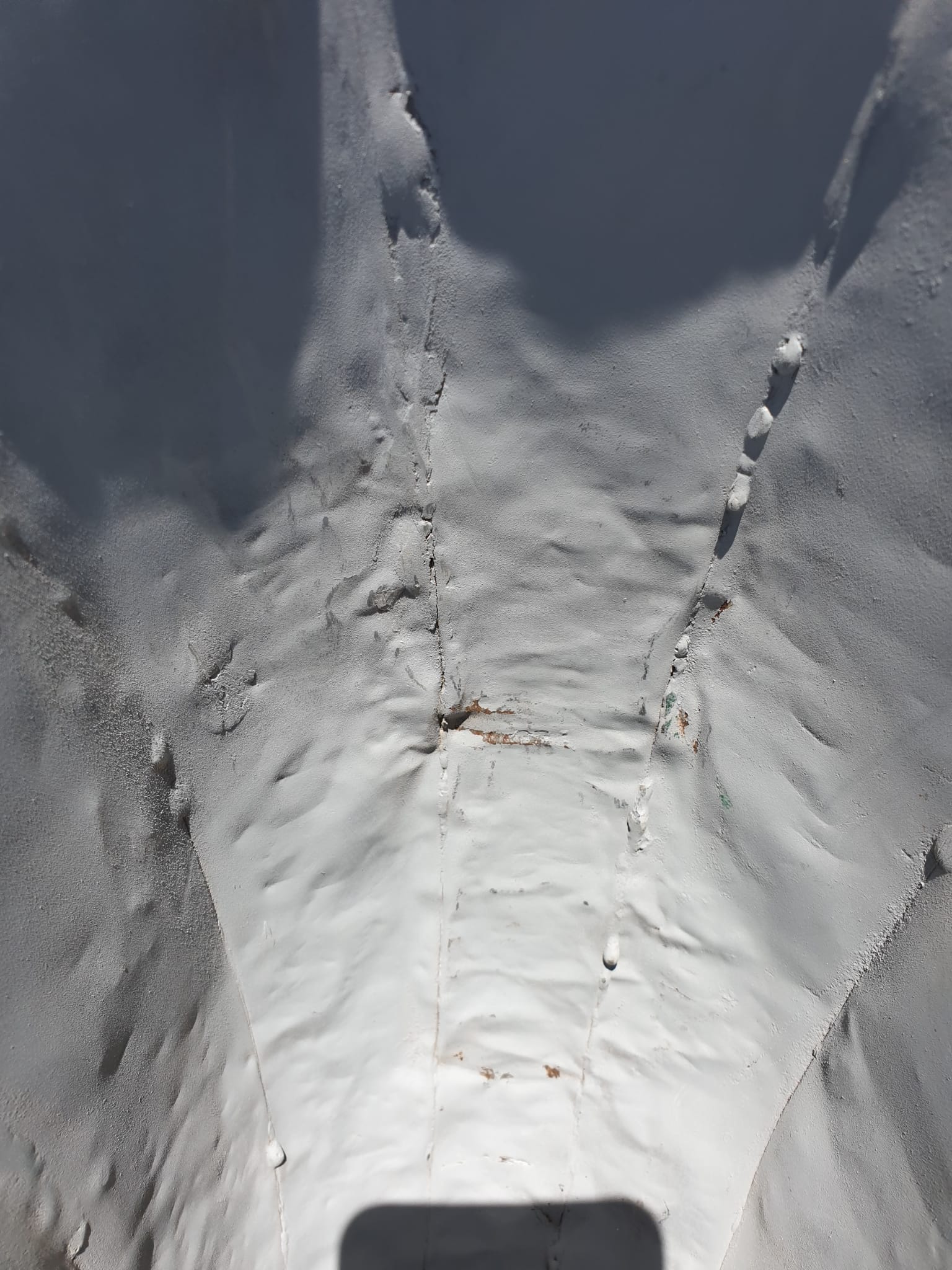

A few months later, my friend called again. "Hey Pedro, do you remember the Mecanophone horn? I sent it to another restorer to fix it and make it easier for you to paint it and he told me that he did his best..."
Long story short, this is what arrived to my shop: Wrinkles everywhere, bondo and primer liberally spread over the rust, several perforations and the cone still crushed making the horn to lean forward like a tired beast.
I was so disgusted with what was done on the poor horn that I left it untouched for 3 months in the corner of the shop.

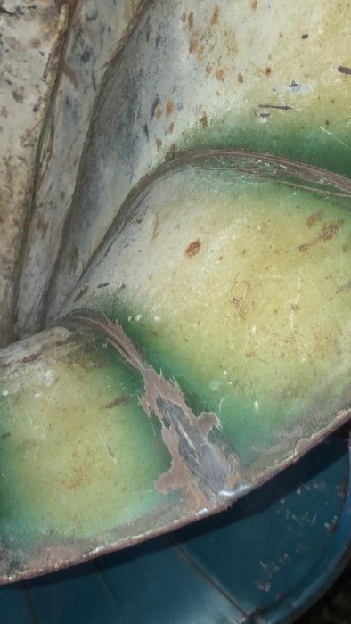

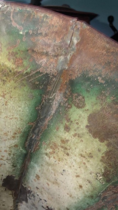

Chapter 3: The horn is definitely dead but he donated its organs.

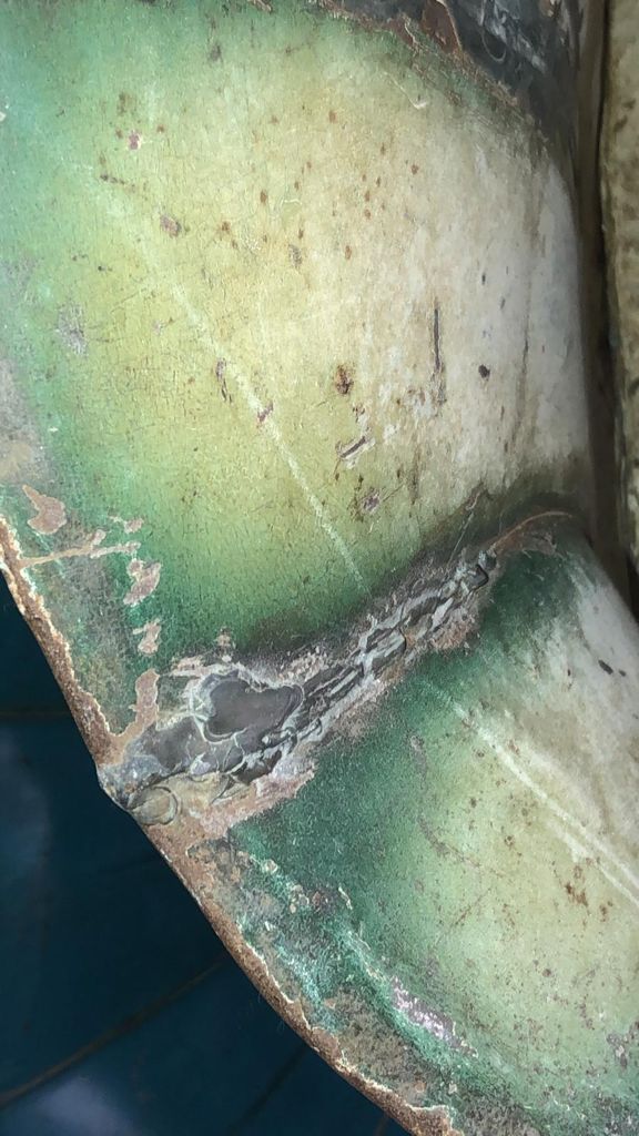

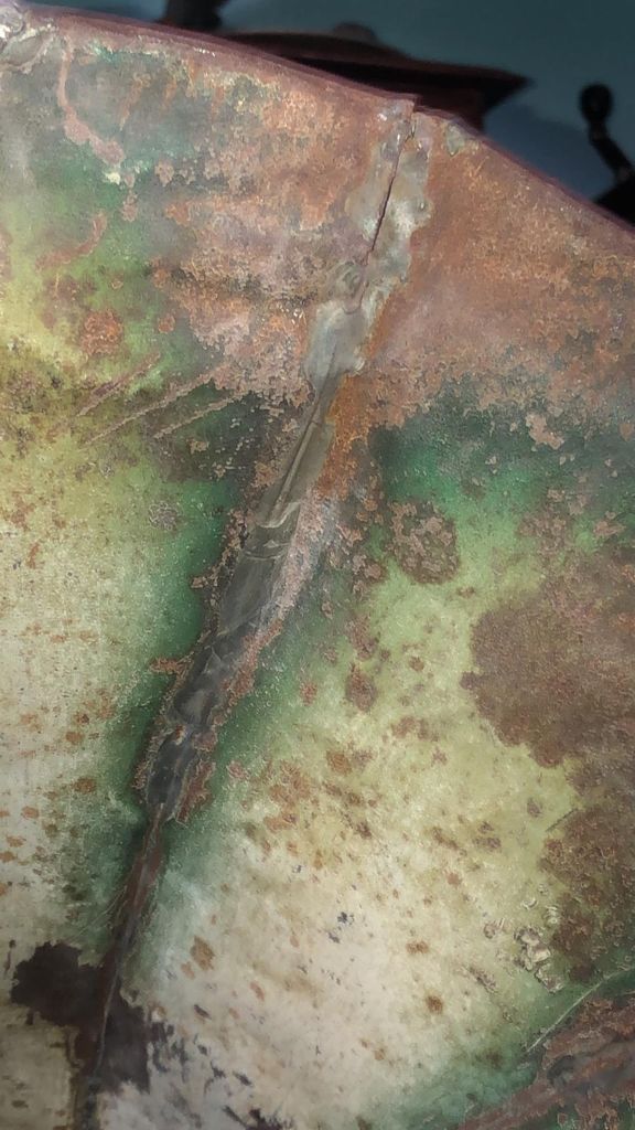

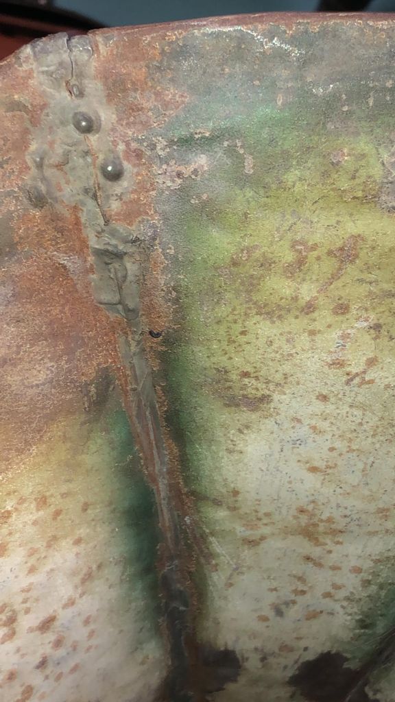

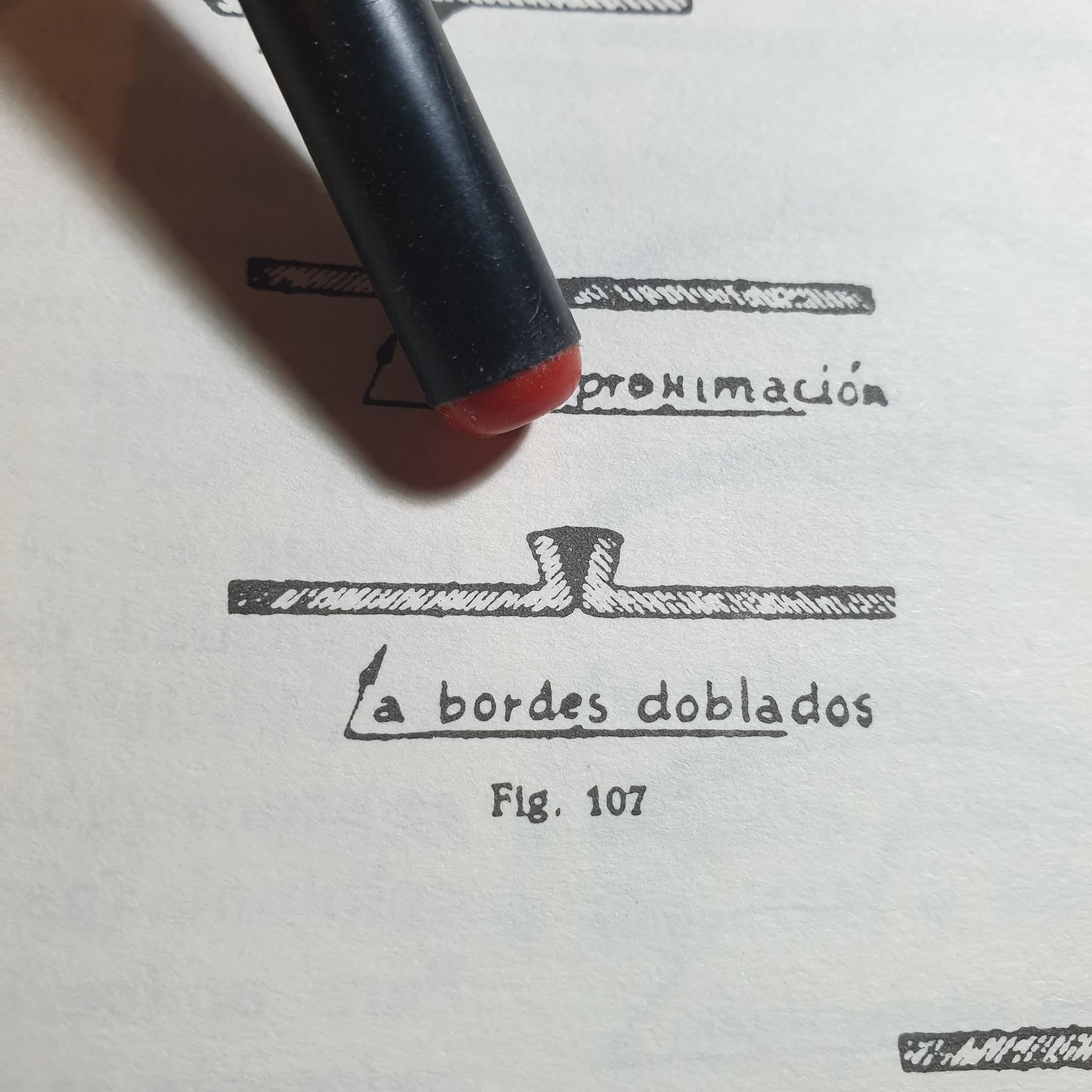

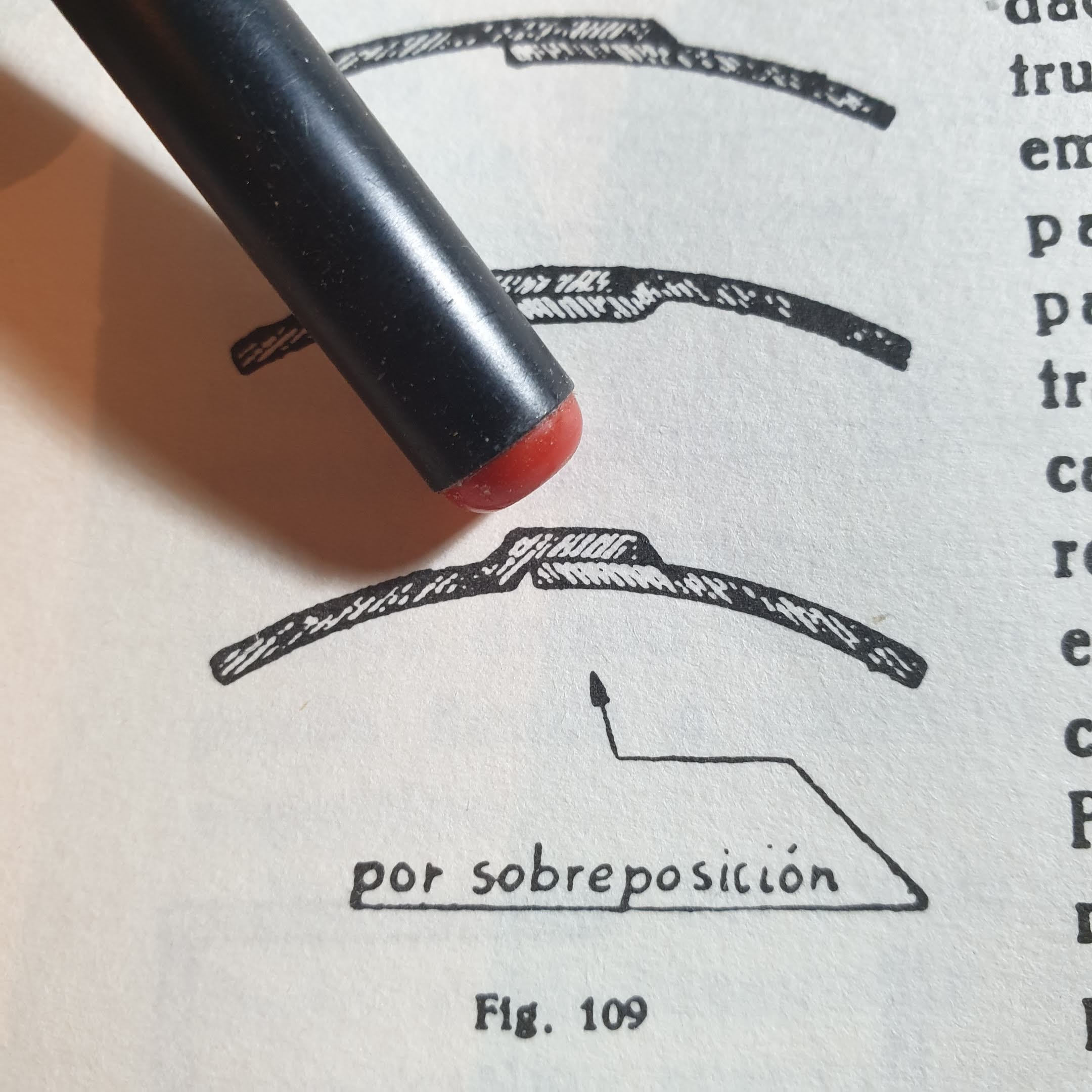

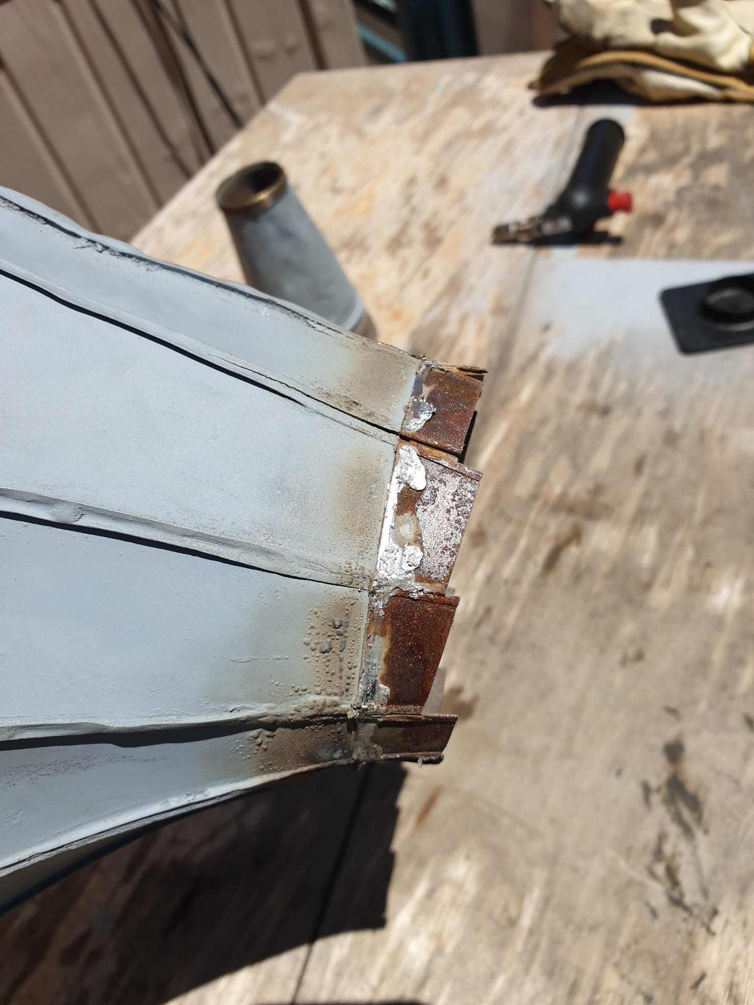

When I finally decided that it was time to try to restore the horn, I started to do a deep assessment of its condition. Its a very unusual horn because of its shape but also because of the technique used in its construction. The petals are not attached in the usual way:
And not even soldered like the Spanish HMV horns: But using a very primitive technique like this: Later, I understood why this technique was chosen but I will reveal that later.

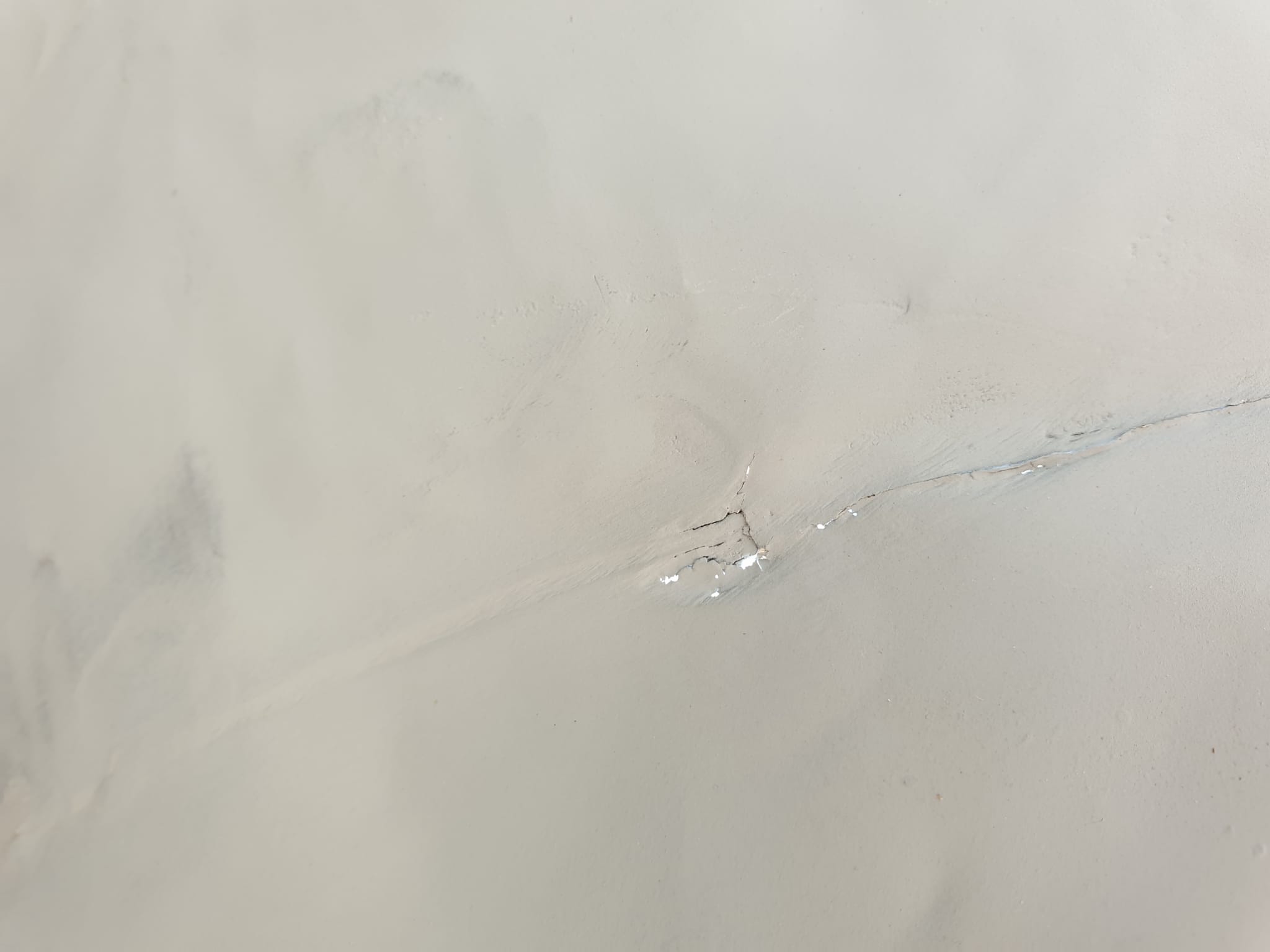

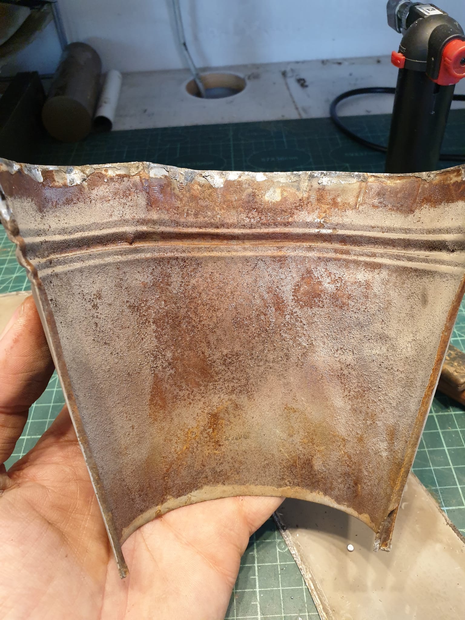

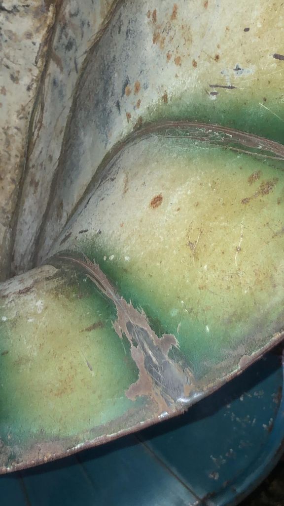

Once I started removing the thick layer of bondo and thick primer that was applied directly over the rusted tinfoil, it was literally falling in flakes in many places leaving holes everywhere. Also, someone had tried to hammer the wrinkles without knowing how to do it and the metal was stretched and deformed in large areas. The icing on the cake were the big blobs of tin and lead everywhere and specially abundant in the most difficult areas to reach.
I called my friend and told him the bad news. The horn was beyond repair BUT I had a plan: To make a replica!

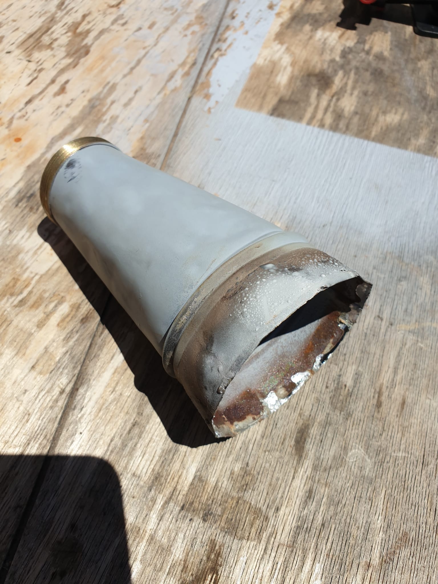

We agreed on the price and I started to dismantle the horn in order to make blueprints of each petal and cone. I was quite lucky to manage to find one petal of each shape with almost no holes. That's all for today.

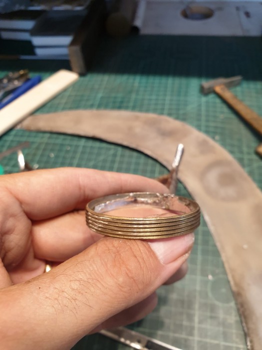

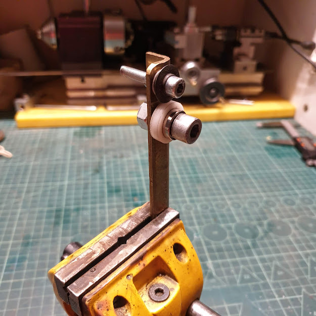

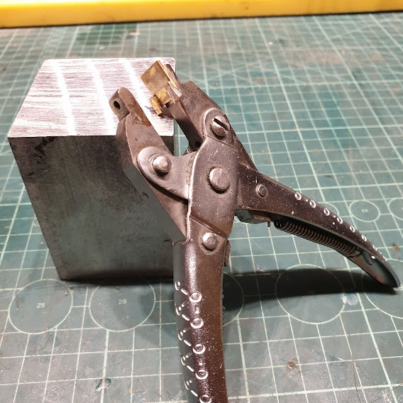

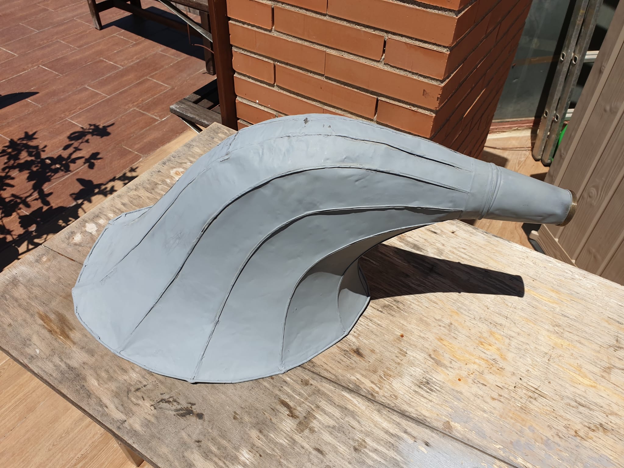

Chapter 4: A new horn is born

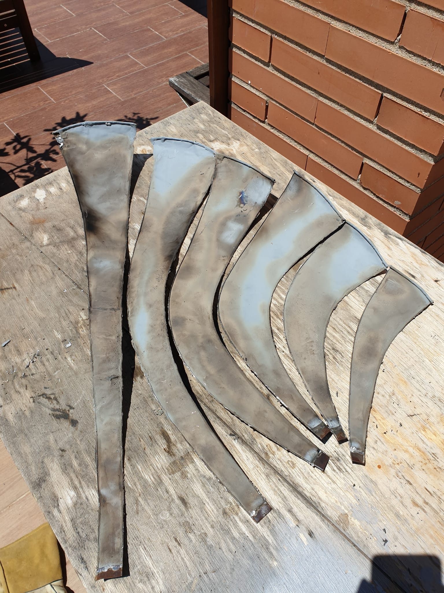

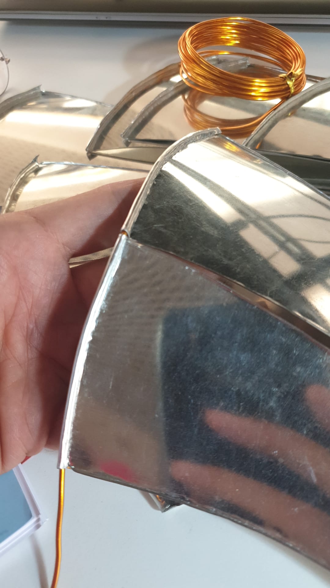

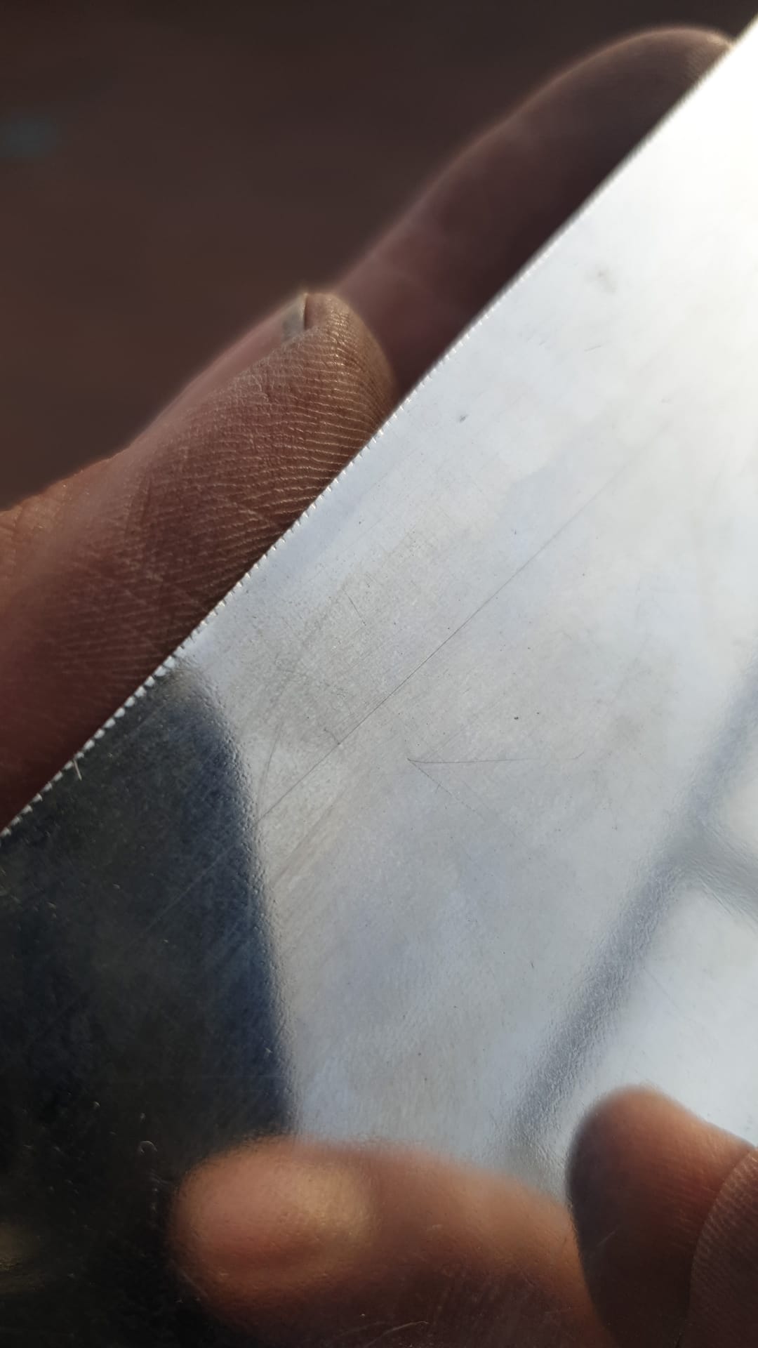

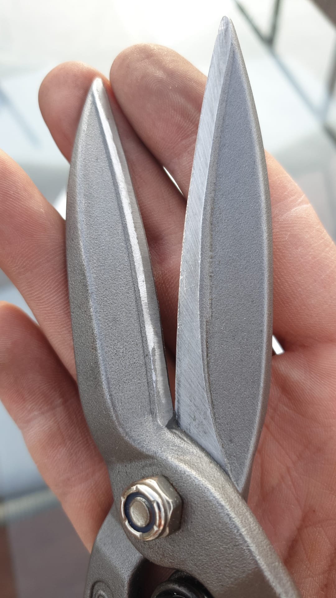

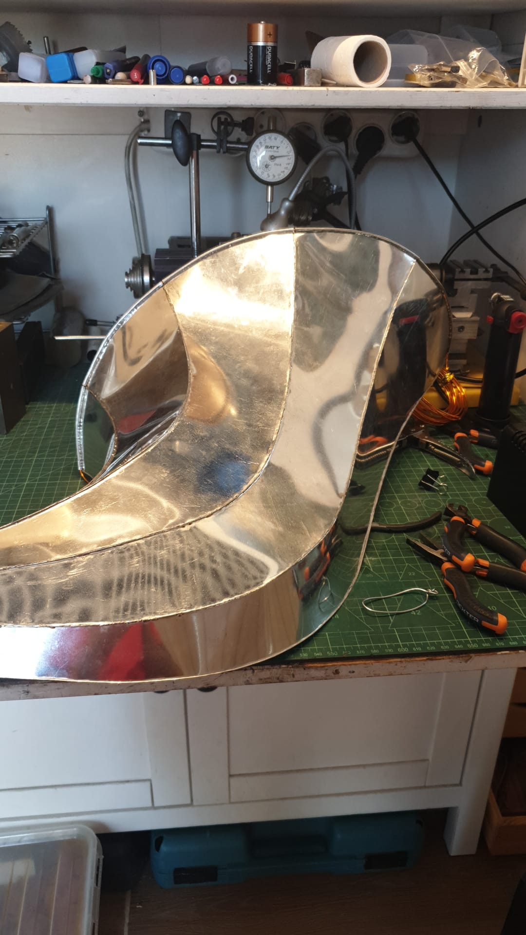

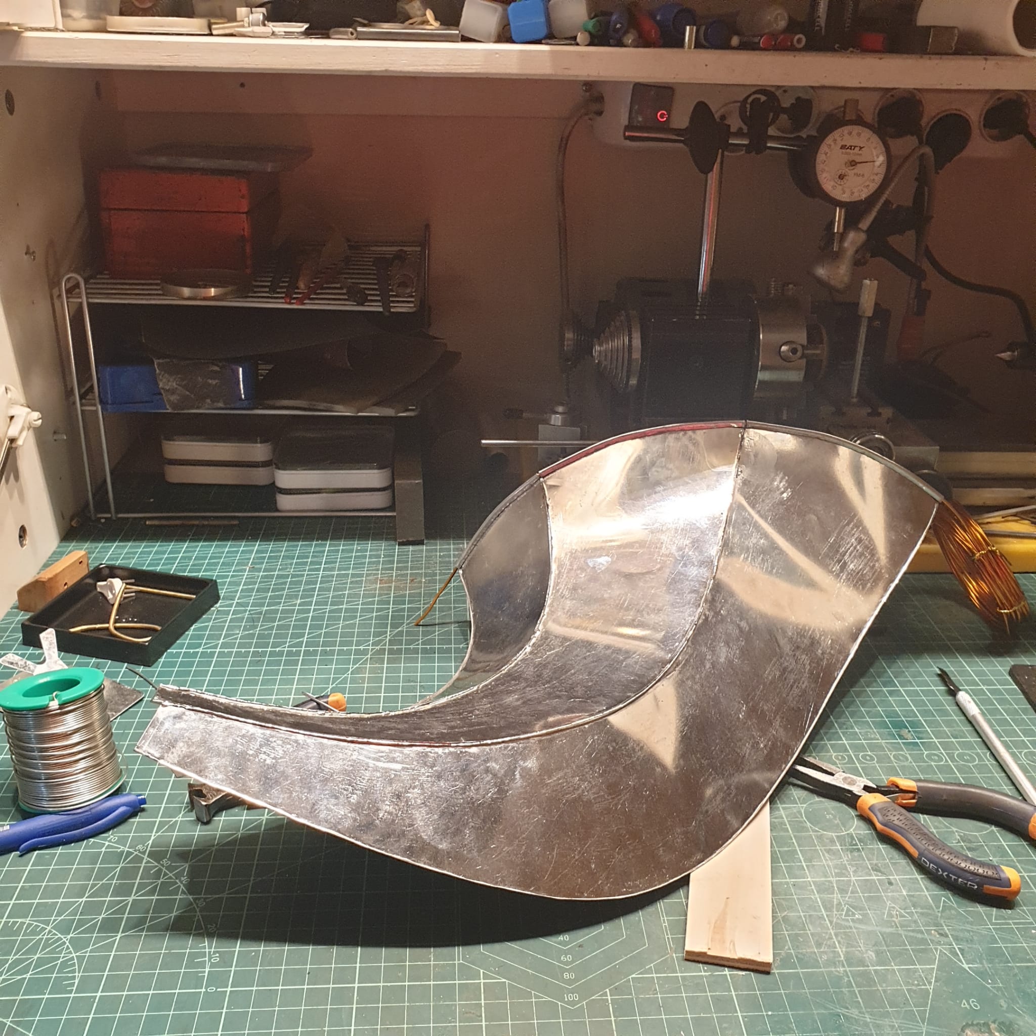

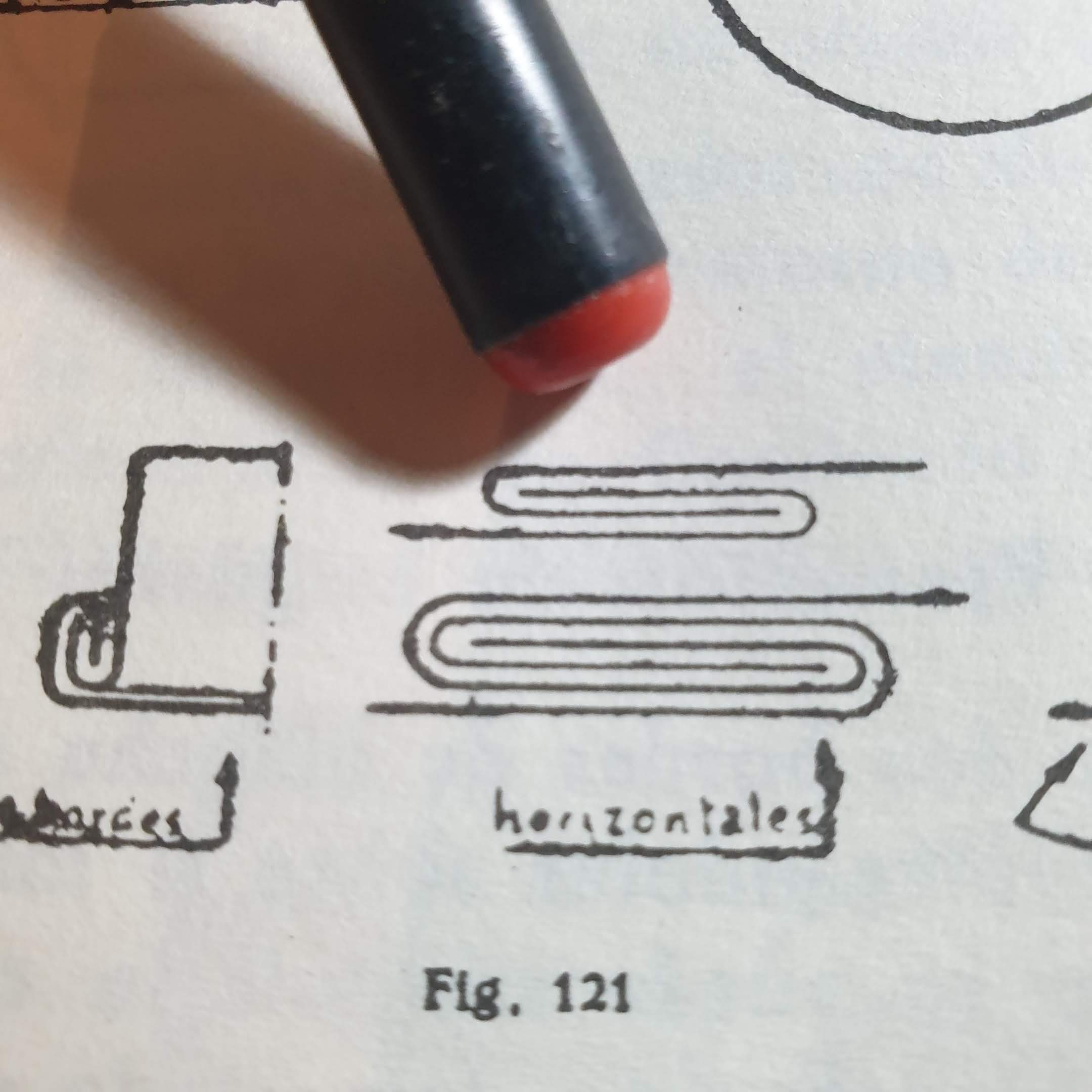

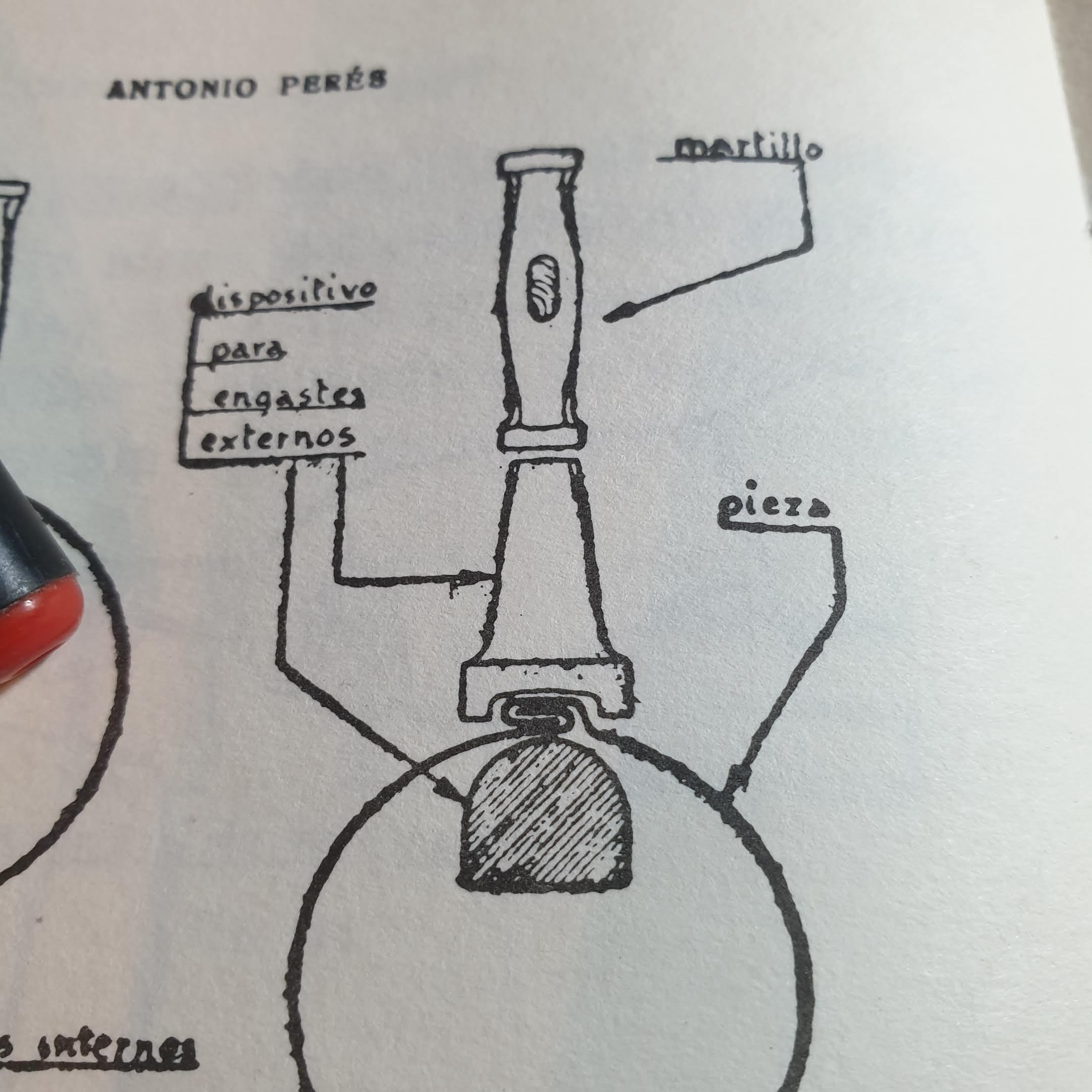

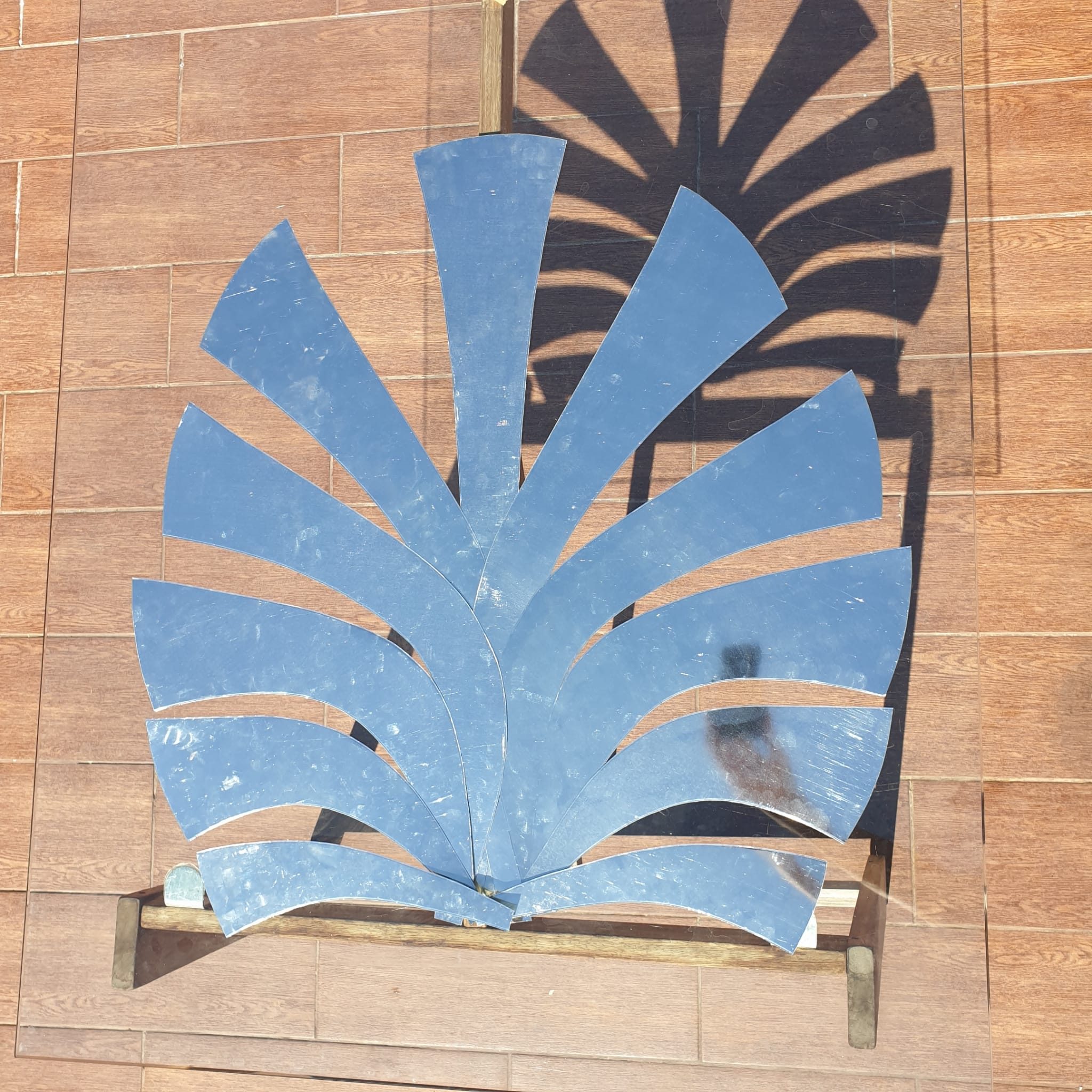

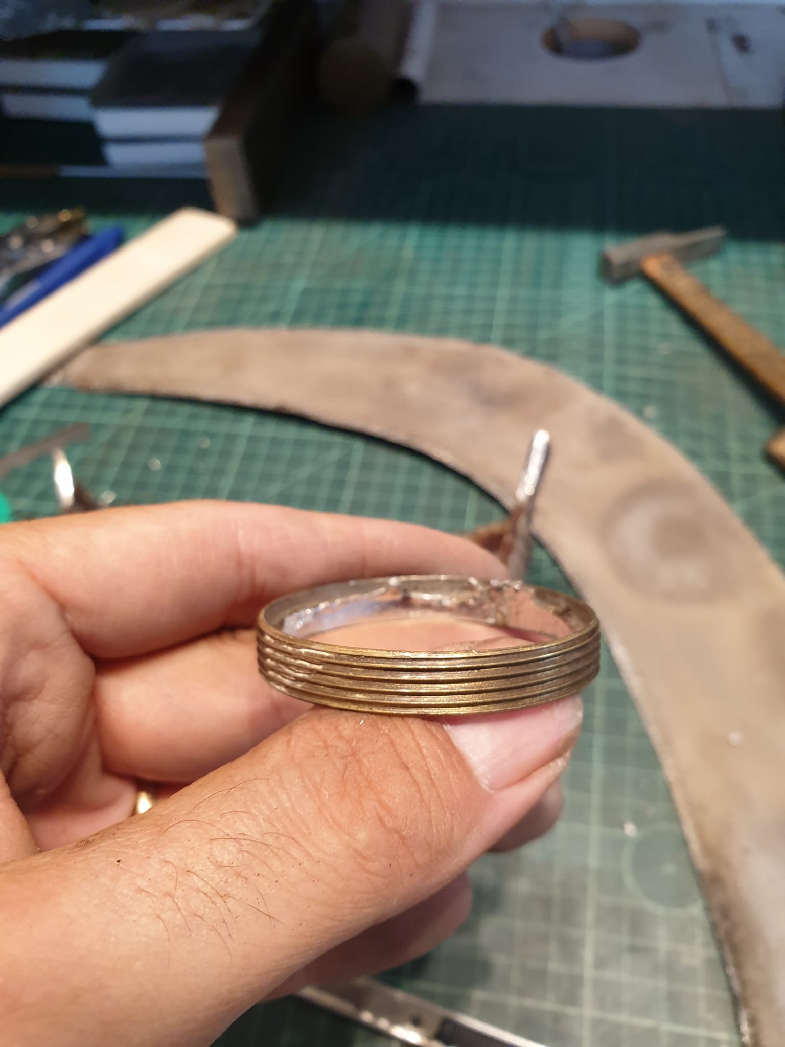

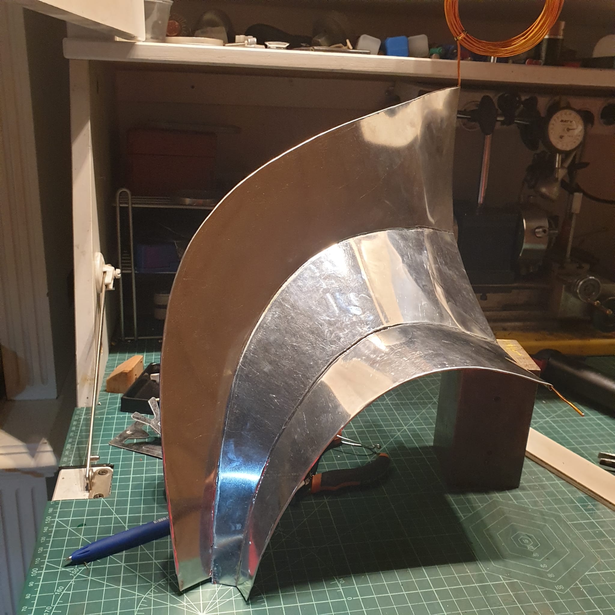

So, after a visit to my favourite metal supplier, I came back to my shop with some shiny tinplate of the exact same thickness as the original. After straightening the old petals, I traced the perimeter of the first one and cut it with my brand new long throat tin scissors only to discover that the blades had a very thin indentations that leaved a serrated edge on the tinplate!!! I dismantled the scissors, grind a new edge on the blades and now they cut the tinplate like butter and leaving a razor sharp edge. In a couple of hours, I cut all the petals and made a fancy picture of them. Next task was to create the bent edge on the petals to make the surface to solder them. For that, first I looked for the price of the machine to make it and I quickly decided that a home made version was the best option. I made a much simpler version with the blade of a pipe cutter and some pieces of scrap metal. Total cost 10 cents. 10.000 times less than the professional and motorized version. Once all the edges were done, I started soldering them. The front edge needs a copper wire core and to be bent around it. For doing that, another tool is needed and again, I made it. They are a recycled parallel jaw plier with some brass tabs soldered to make the "bite" on the tinplate always at the exact same distance. And the horn started to born! Time to go dinner. Next chapter very soon.
