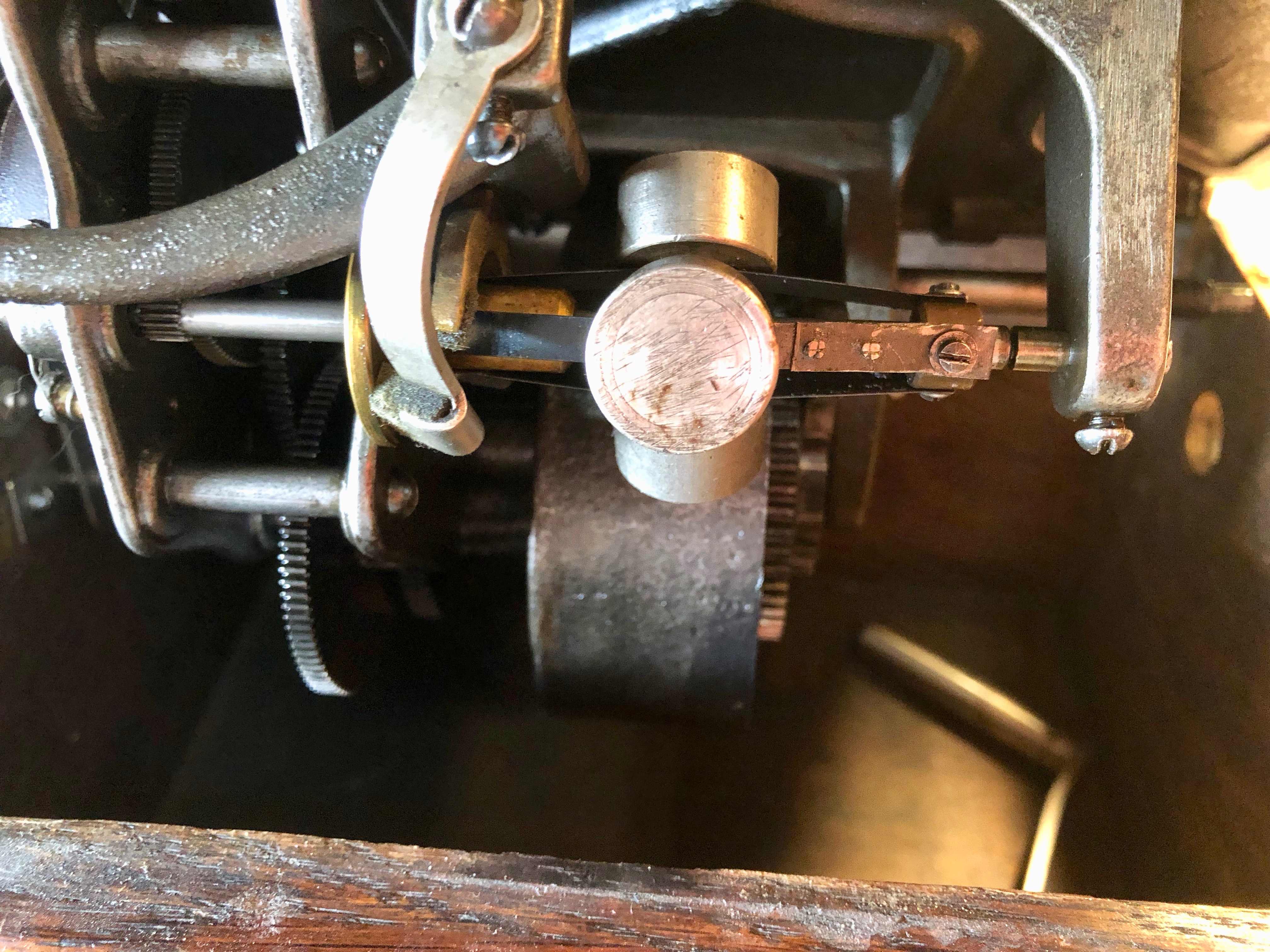

With the exception of a slightly different design on the lower belt pulley, the motors appear to be identical. I think that I'm going to try and switch out the entire governor. We'll see what happens.
Here is the bad spring. Somebody got creative. :(

While at first glance the motors appear to be identical, they are not. The bull gear and it's mating pinion are different on the two motors. The whole motor will interchange, but not all the gears from motor to motor. I hope I made sense!
Dave D

Thanks, everyone. I only needed to switch out the governor between the two machines, nothing else. The Fireside retains its original motor, with the governor from the Standard. That seems to have worked perfectly. The Fireside is running great and it sounds perfect. I see no difference between the two governors.
