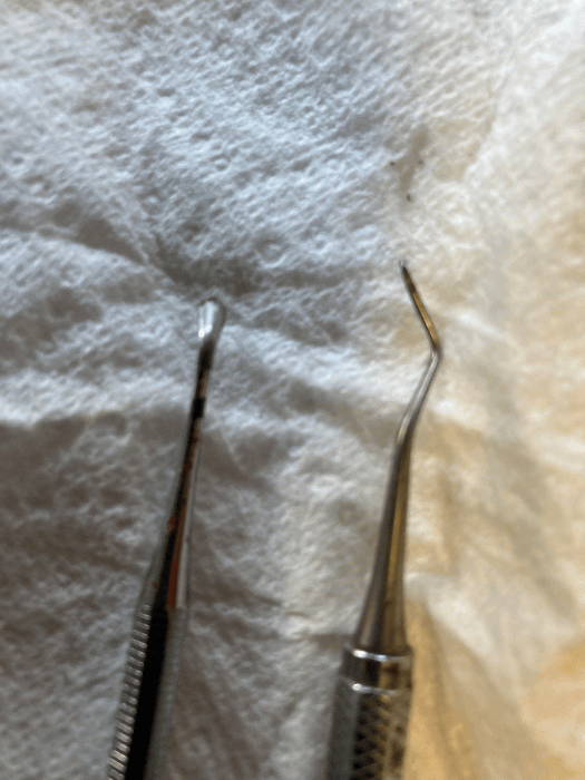

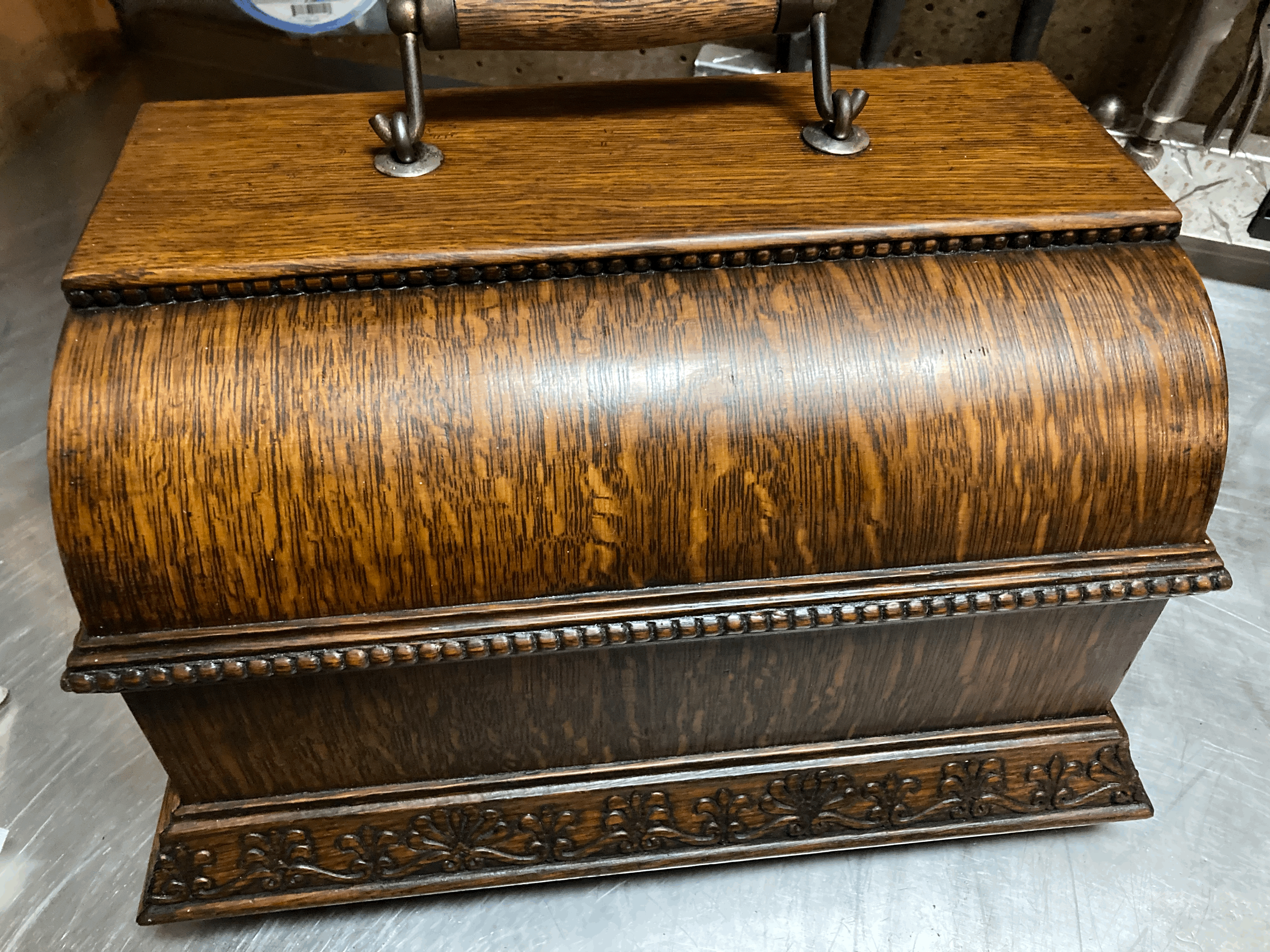

I clean cabinets with Goop or GoJo. For a light cleaning I apply the cleaner with a rag. But I frequently use 0000 steel wool that is soaked with cleaner. It seems like there are always a few paint specks on a finish. I clean one panel at a time, generally with soaked steel wool, and the cleaner softens the paint speck. I've found that if you disturb a paint speck and go over it again with soaked steel wool the speck is gone. I have a few dental tools that I disturb any specks. The lid for this Columbia AB was freckled with specks and now it looks terrific.

Those dental tools are a marvel. When I go to the dentist I always ask and comment on the drills and tools... While sitting in the torture chair, I always wonder what could I do to my gramophones and soundboxes with such fine tools...
They even have high quality precision screwdrivers and wrenches for the tiny screws and nuts of the implanted teeth....
Next time I go to the flea market I will visit the old dental tools stall...

The Columbia AB does indeed look terrific now - well done.

Just ask your dentist for any surplus used or broken tools, and the odds are high that you will be given some!
- Posts: 4682
Re: Removing Paint Flecks
Great idea, thanks. I'll ask next time, although maybe for any sanitary protocol, they cannot give them to me! My dentist is kind of organization depending on the university....
