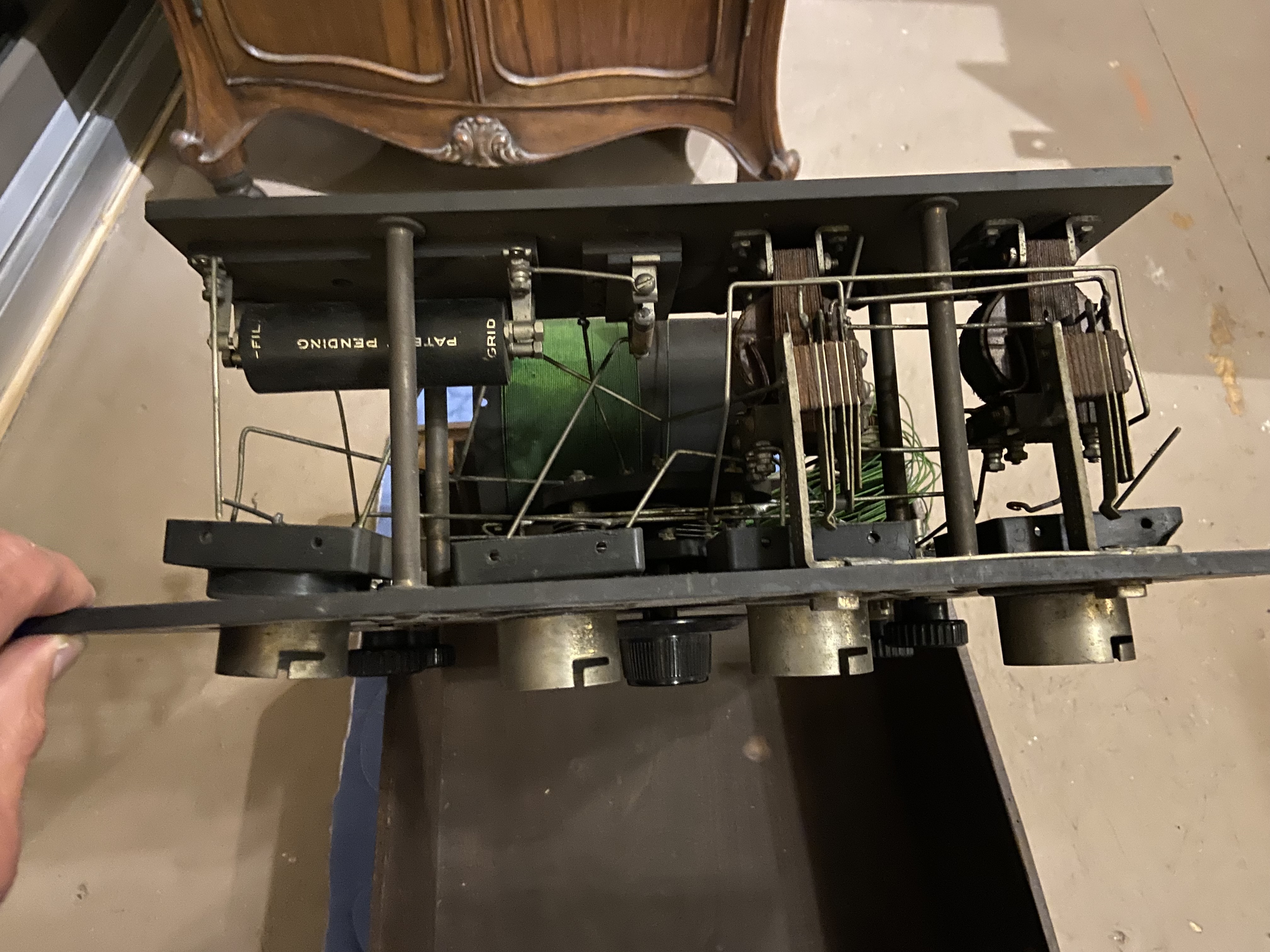

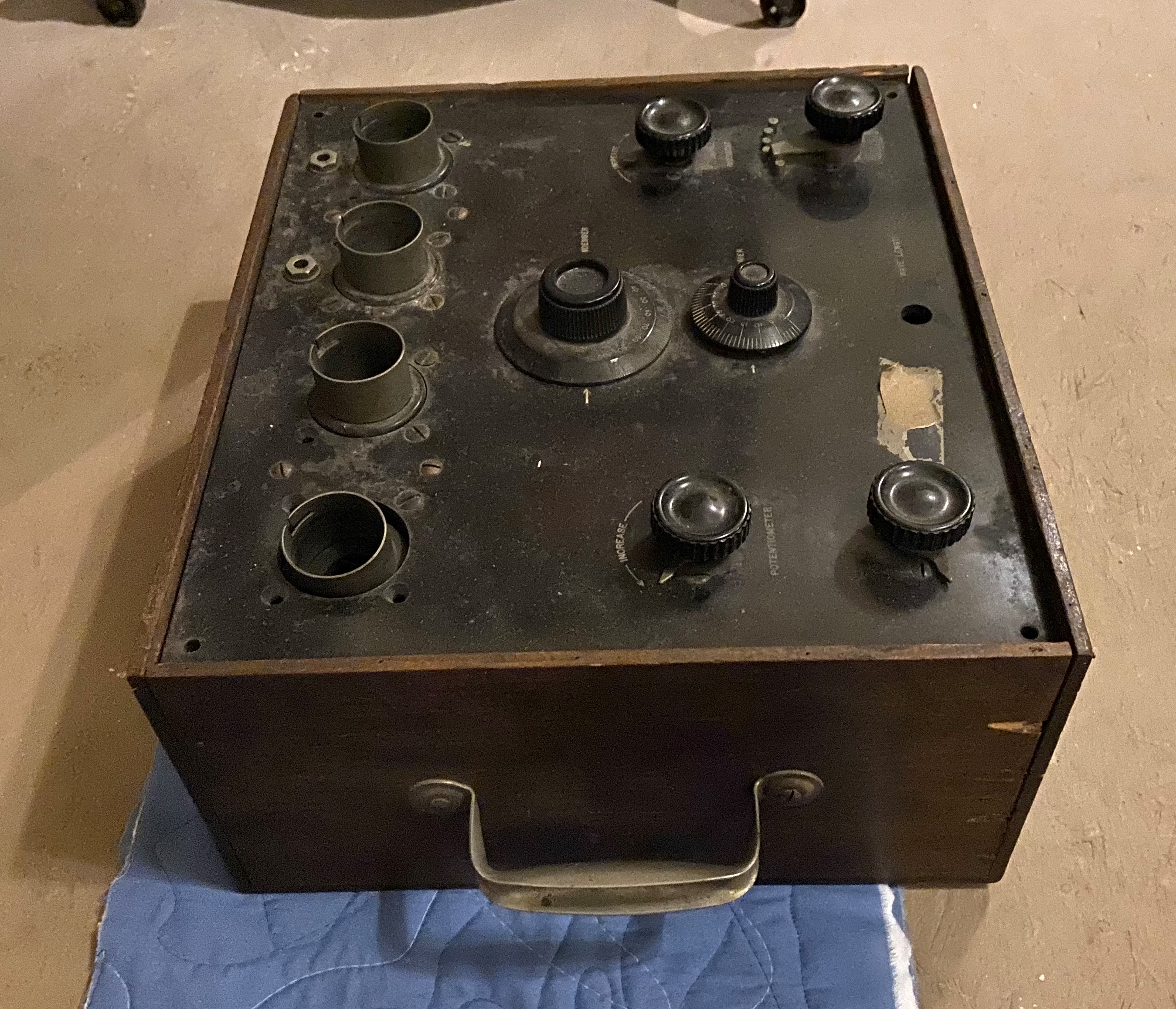

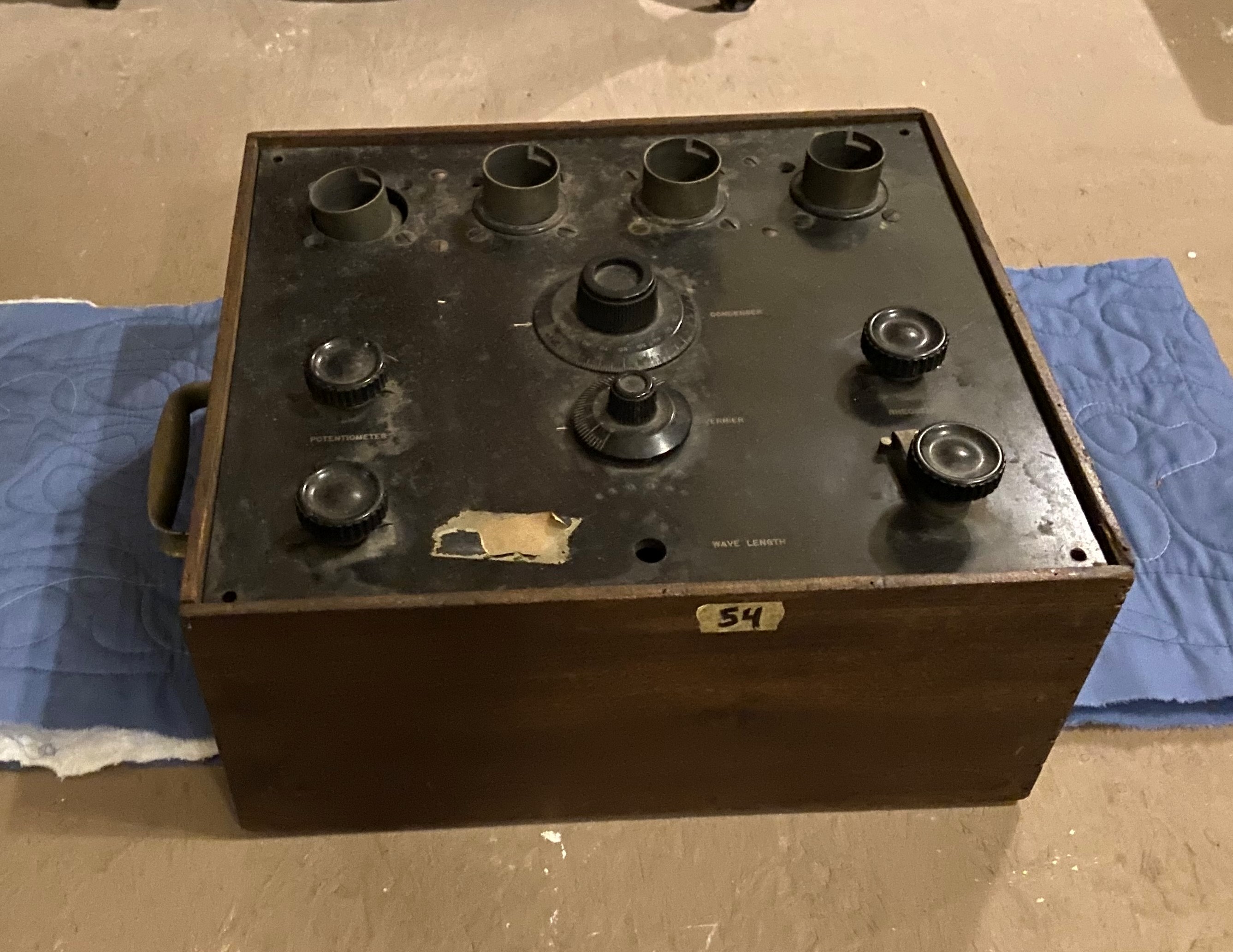

The Victor company had no interest in selling radios in 1922. They were interested in preventing anyone else from using the Victor name to sell radios. In order to copyright a name you have have sold product. As I heard the story they produced 25 radios and sold them to their distributors. Here is one I found in an old RCA storage unit years ago. It looks like it may have been a "portable" version for testing. Notice the VV-50 handle? You would think the Victor company would have made a nicer cabinet. But it is not. It looks like Victor may have bought some Federal receivers and took them apart and made these 12" x 12" radio panels. The tube sockets, RF coils, knobs, and inter-stage transformers all look like stock Federal parts. Maybe Federal was involved in the build? I am not sure we will every know. Some day I need to do something with this. Right now it is just a cool VTMC artifact that has been abused over the last 100 years. 238

That is really interesting. I would like to mess with a 3 dial tuner radio of 100 years ago to see how they pick up a station.Skihawx wrote: Mon Sep 20, 2021 8:19 pm The Victor company had no interest in selling radios in 1922. They were interested in preventing anyone else from using the Victor name to sell radios. In order to copyright a name you have have sold product. As I heard the story they produced 25 radios and sold them to their distributors. Here is one I found in an old RCA storage unit years ago. It looks like it may have been a "portable" version for testing. Notice the VV-50 handle? You would think the Victor company would have made a nicer cabinet. But it is not. It looks like Victor may have bought some Federal receivers and took them apart and made these 12" x 12" radio panels. The tube sockets, RF coils, knobs, and inter-stage transformers all look like stock Federal parts. Maybe Federal was involved in the build? I am not sure we will every know. Some day I need to do something with this. Right now it is just a cool VTMC artifact that has been abused over the last 100 years. 238

got anything else that came from that storage unit? I love hearing and seeing stuff like that, or stuff from dealers that never sold, etcSkihawx wrote: Mon Sep 20, 2021 8:19 pm The Victor company had no interest in selling radios in 1922. They were interested in preventing anyone else from using the Victor name to sell radios. In order to copyright a name you have have sold product. As I heard the story they produced 25 radios and sold them to their distributors. Here is one I found in an old RCA storage unit years ago. It looks like it may have been a "portable" version for testing. Notice the VV-50 handle? You would think the Victor company would have made a nicer cabinet. But it is not. It looks like Victor may have bought some Federal receivers and took them apart and made these 12" x 12" radio panels. The tube sockets, RF coils, knobs, and inter-stage transformers all look like stock Federal parts. Maybe Federal was involved in the build? I am not sure we will every know. Some day I need to do something with this. Right now it is just a cool VTMC artifact that has been abused over the last 100 years. 238
