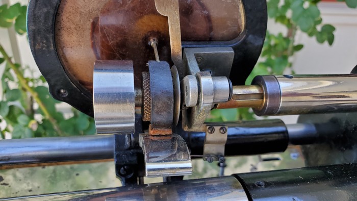

I encountered something unexpected on the Higham reproducer. Between the friction shoe and floating bar that supports the stylus arm is a yellowish solid that almost looks like a deteriorated rubber bumper stuck to the friction shoe. The only photos I have found of Higham’s with original parts aren’t quite close enough for me to absolutely determine that this is a foreign object, possibly something that solidified from an ill-conceived cleaning of the amber wheel. But before I removed it I just wanted to be absolutely sure that it is foreign. Please let me know. Pictures of the object included below.

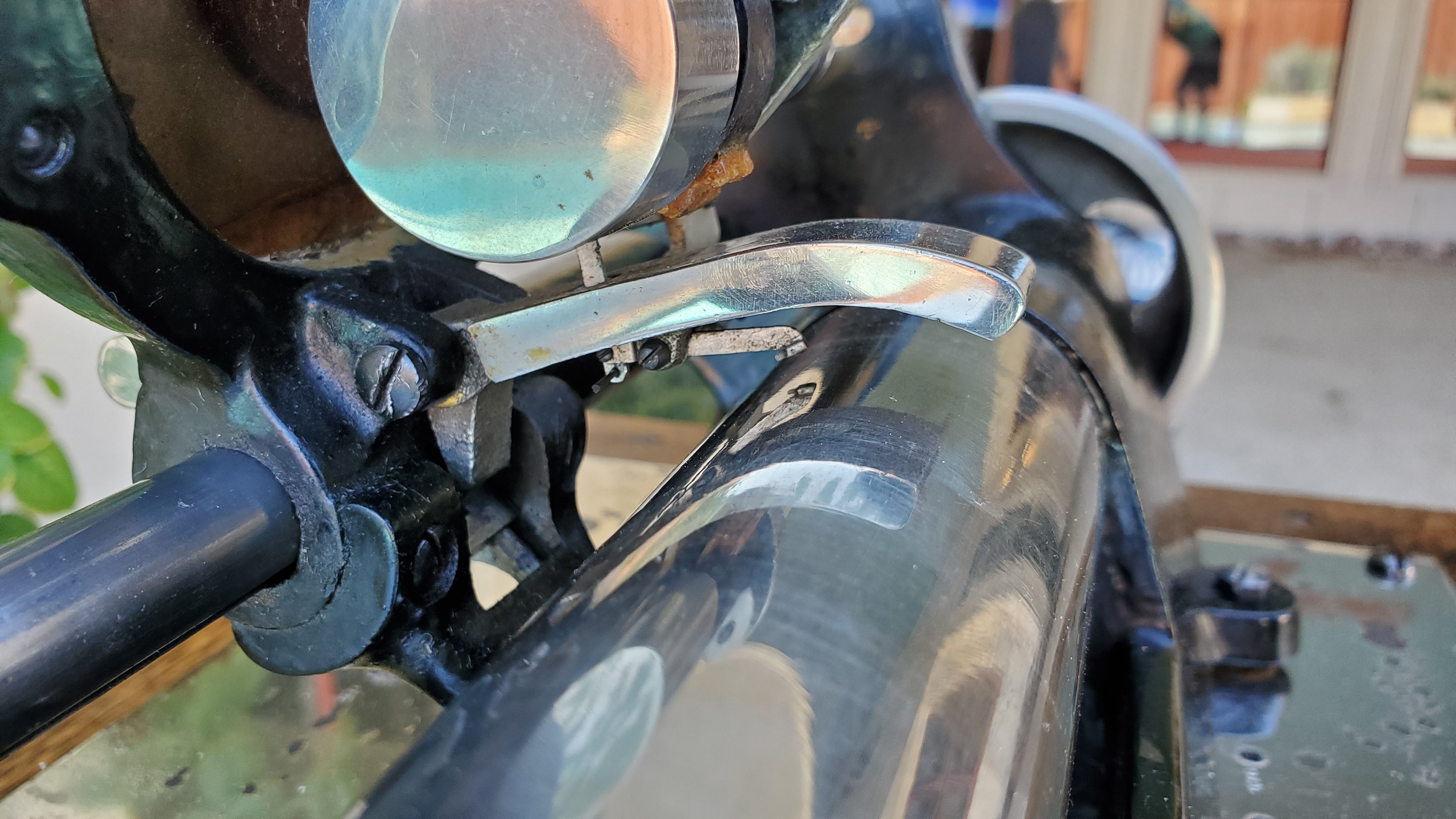

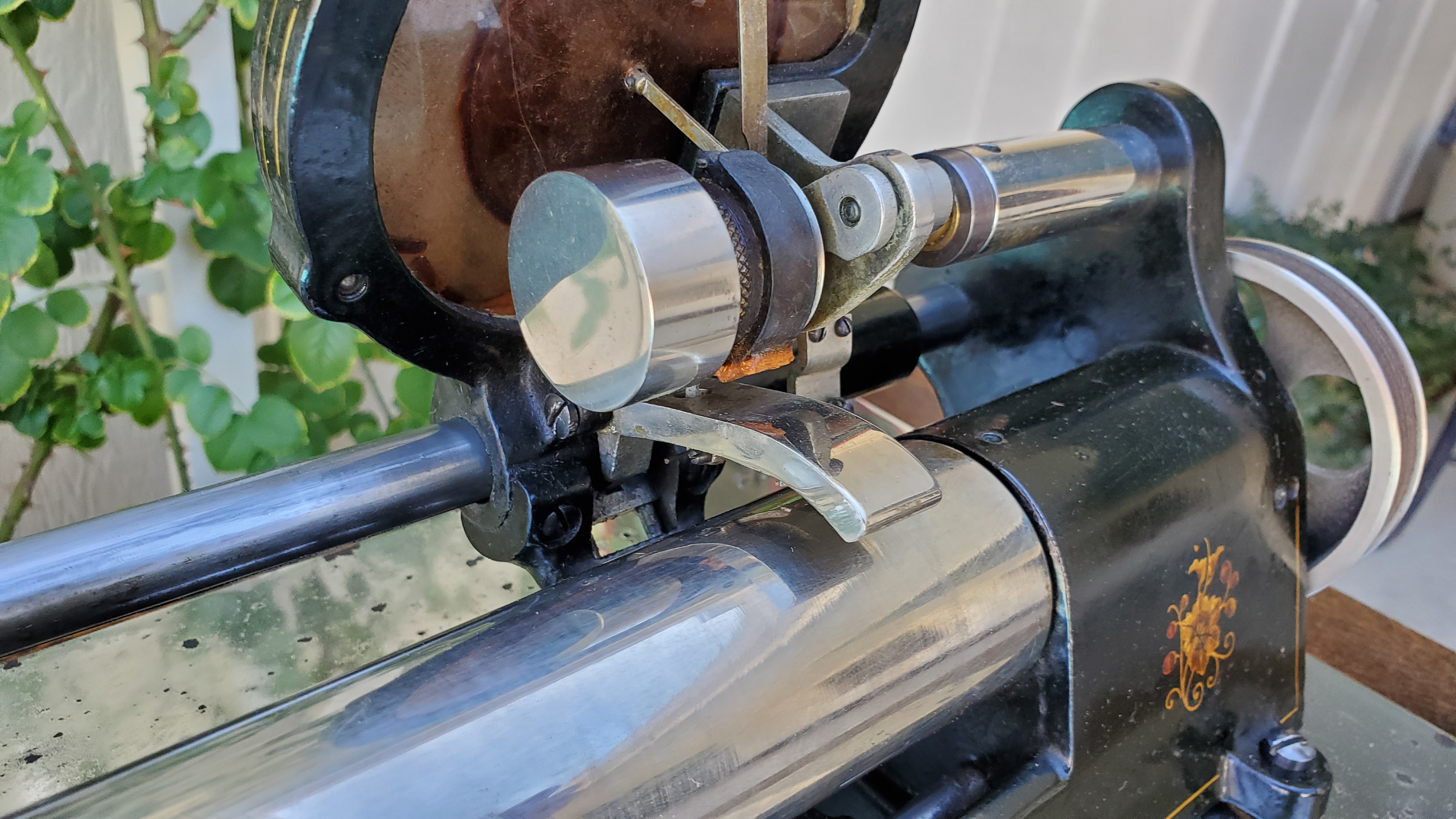

I can't explain the rationale behind the instructions, but the yellow matter between your friction shoe and the weight is not original. Here are a couple of closeup photos of original parts which will hopefully help:
https://forum.antiquephono.org/topic/50 ... mment-2651
Best of luck with your restoration!
