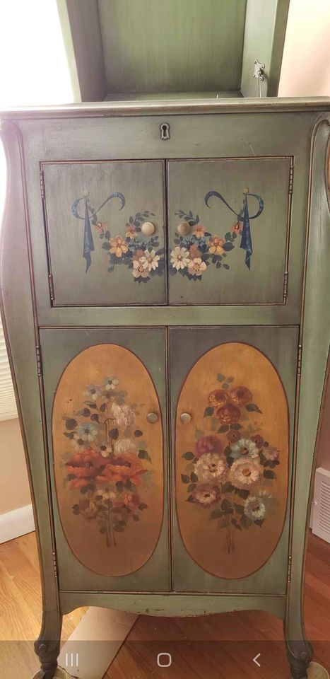

Here's a fairly nice example of an aftermarket paint job. On FB right now if anyone has interest, https://www.facebook.com/marketplace/it ... ea46d96721
Notice the painted over lid decal...

JerryVan wrote: Sun Oct 24, 2021 8:25 am Here's a fairly nice example of an aftermarket paint job. On FB right now if anyone has ineterest, https://www.facebook.com/marketplace/it ... ea46d96721
I would guess, however, that the repaint here dates to the '70s. The base streaky green looks a lot like what came out of application of the "antiquing" kits that were in vogue then (I saw a fair amount of it when it was new; Mom caught the bug), and the flowers strike me as like what was in fashion around that time. I never cared for the look, but somebody did good, neat work, though, I'll grant--a cut above just slapping on the kit color and calling it a day.

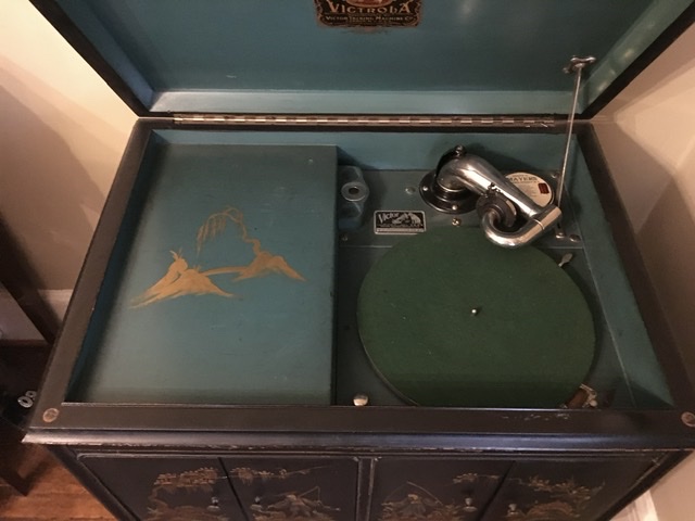

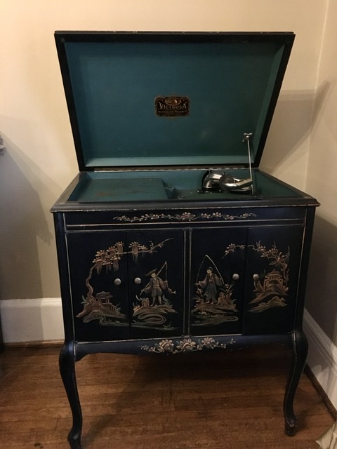

Here is a VV-210 in my collection. It looks like an aftermarket job since the decal was not applied after the interior of the lid was painted, but the exterior looks quite nice (at least to me).
Bill

drh wrote: Sun Oct 24, 2021 9:22 am
I got the 70's vibe from this too... Who knows...
