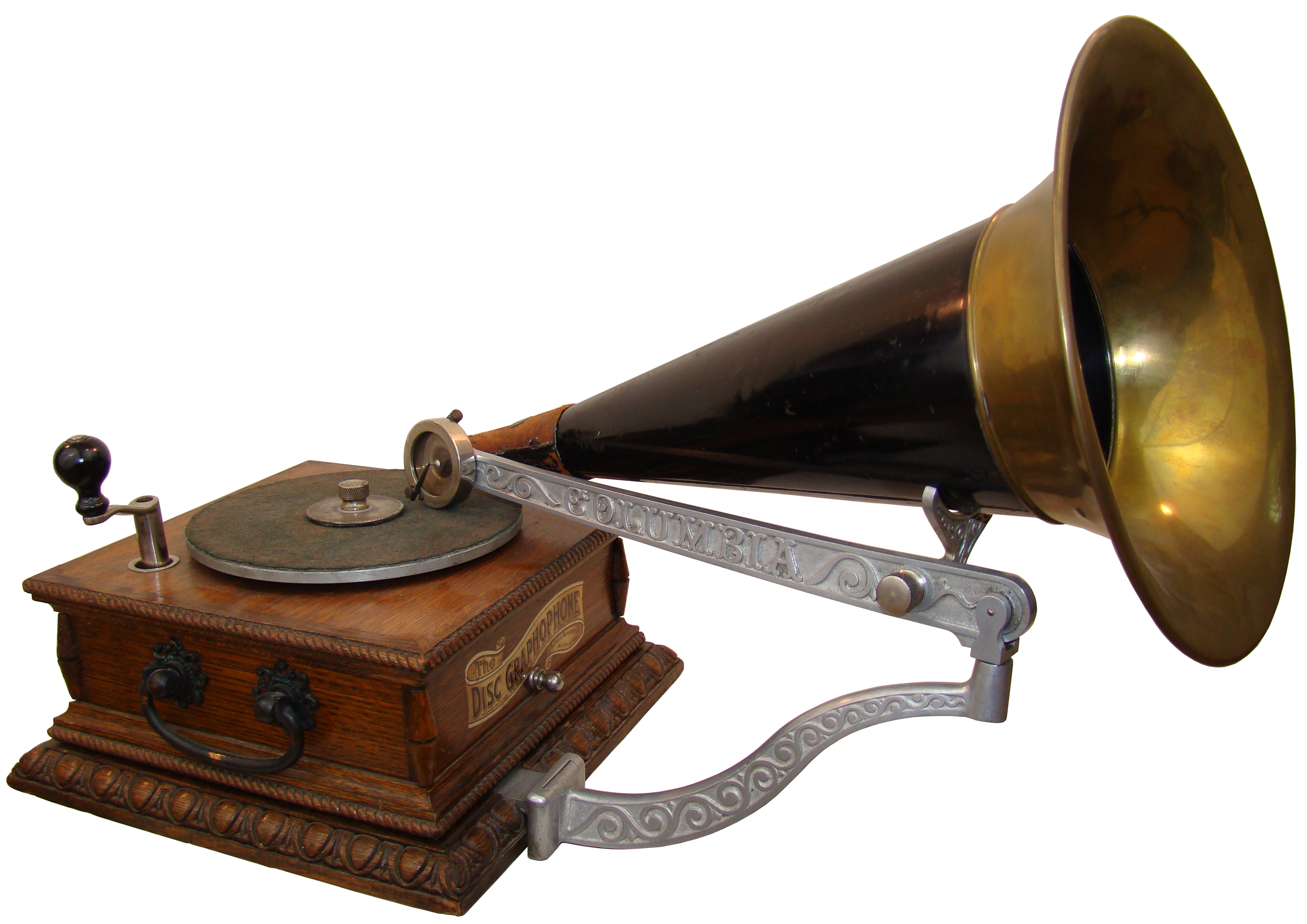

Columbia AJ Issued in 1901, this is Columbia's first 7-inch machine. It is referred to by collectors today as the Top wind AJ.
Initial Offering: This model was issued with and without a hold-down nut, with an Improved soundbox, with two variations of motor configurations, and with a cast aluminum turntable.
In future months/years, the AJ Model would go on to be issued in several cabinet and motor variations (Rear-wind, side-wind) with the later analyzing reproducer, with a brass elbow, with different traveling and support arms, and with stamped steel and pot metal turntables.
Shown here, this machine has an Improved sound box, with a cast aluminum turntable, with a hold-down nut, and with a leather elbow.

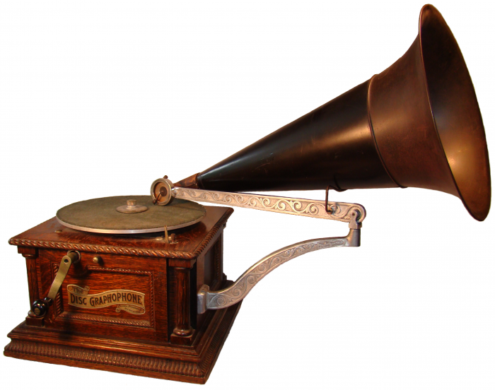

Columbia AH. Issued in 1901, this was Columbia's first 10-inch machine.
Initial Offering: This model was issued with and without a hold-down nut, with an Improved soundbox, with two variations of motor configurations, with a cast aluminum turntable, with and without the name "Columbia" cast on the travelling arm, and with or without the reproducer locking screw on the arm.

In future months/years, the AH would go on to be issued in several cabinet and motor variations, with the later analyzing reproducer, with a brass elbow, with different travelling arms, and with stamped steel and pot metal turntables.
Shown here, this machine has an Improved sound box, with a cast aluminum turntable, without the name "Columbia" cast on the travelling arm, with the reproducer locking screw on the travelling arm, with a hold-down nut, and with a leather elbow.

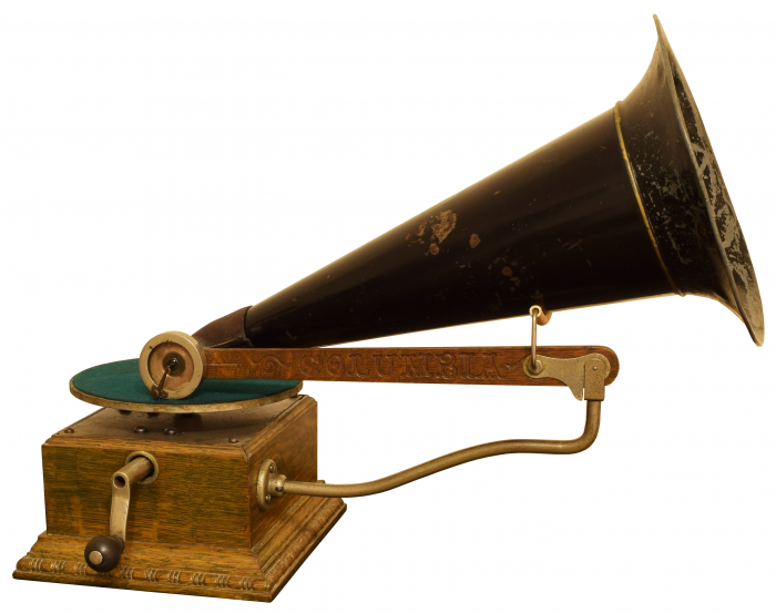

Columbia AK Issued in 1902, this is Columbia's second 7-inch machine. Priced less expensive than the AJ, it was their "value" model. It is referred to by collectors today as the rod-style AK.
Initial Offering: This model was issued without a hold-down nut, with the Improved soundbox, with a single motor configuration, with a rod support arm, with a stamped wooden travel arm, and with a cast aluminum turntable.

In future months/years, the AK Model would go on to be issued in several cabinet variations, with the later analyzing reproducer, with a brass elbow, with different traveling and support arms, and with stamped steel and pot metal turntables.
Shown here, this machine has an Improved sound box, with a cast aluminum turntable, with a zinc-bell black painted horn, and with a leather elbow.
