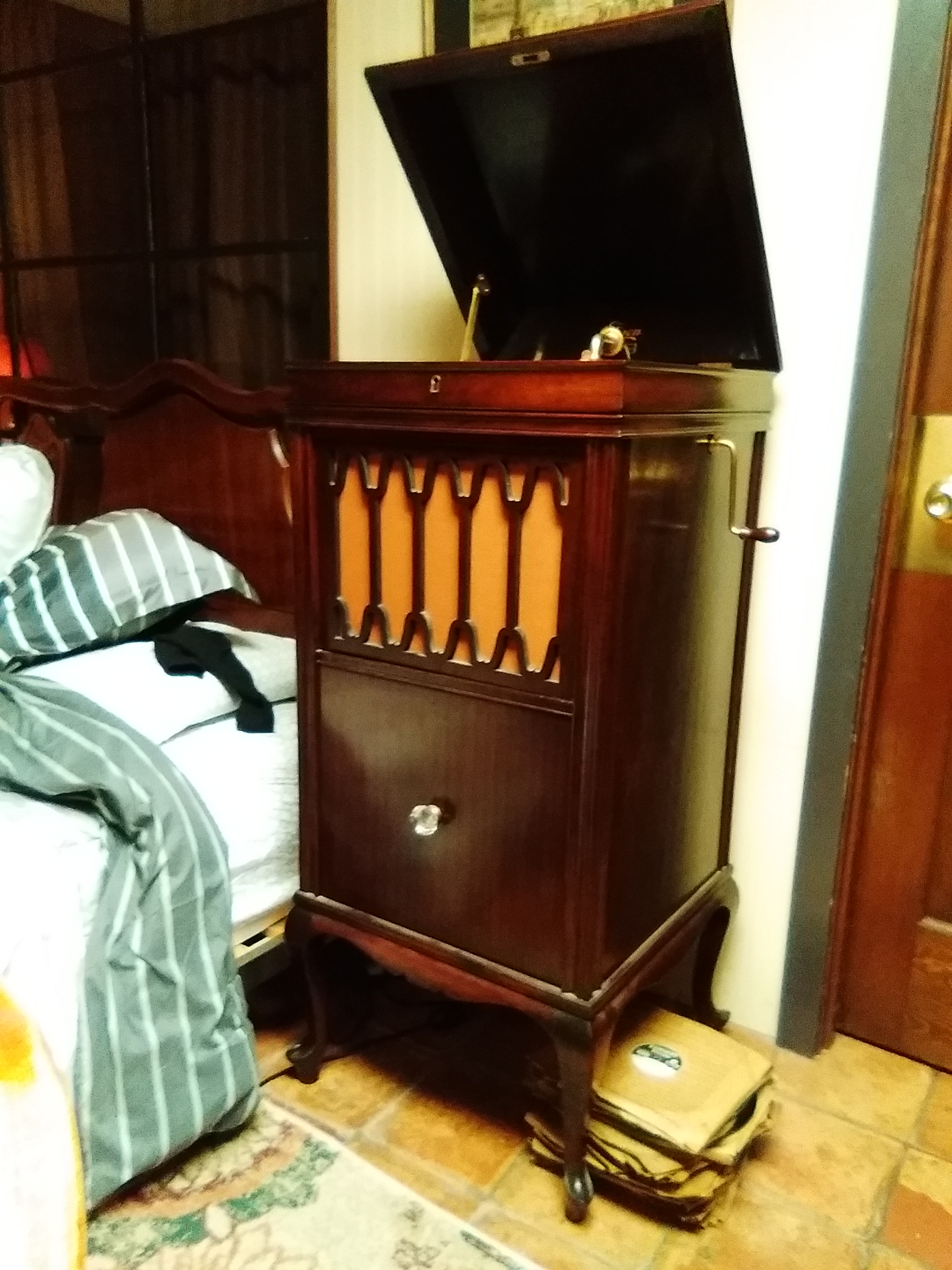

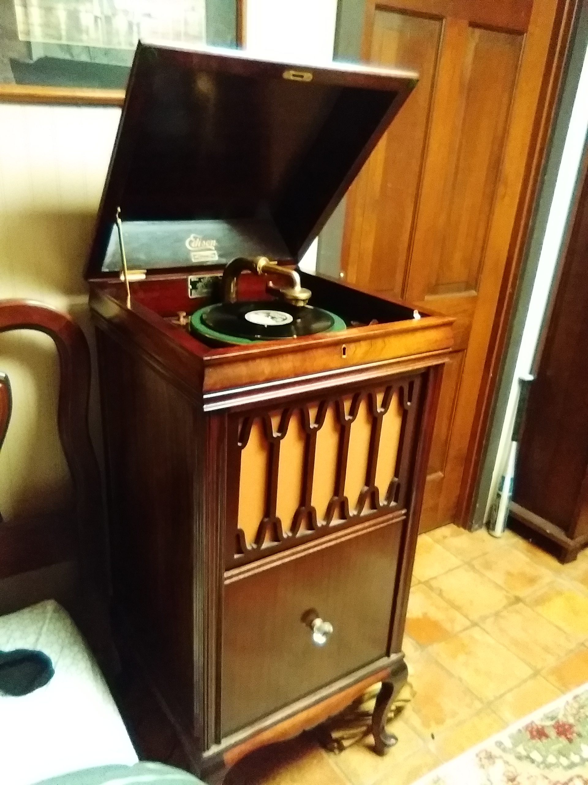

I found something mighty nice a few weeks ago & today I had the sparest of spare moments--so I fired up the Toyota and cruised over to Bristol, CT to pick up this Edison disc phonograph.

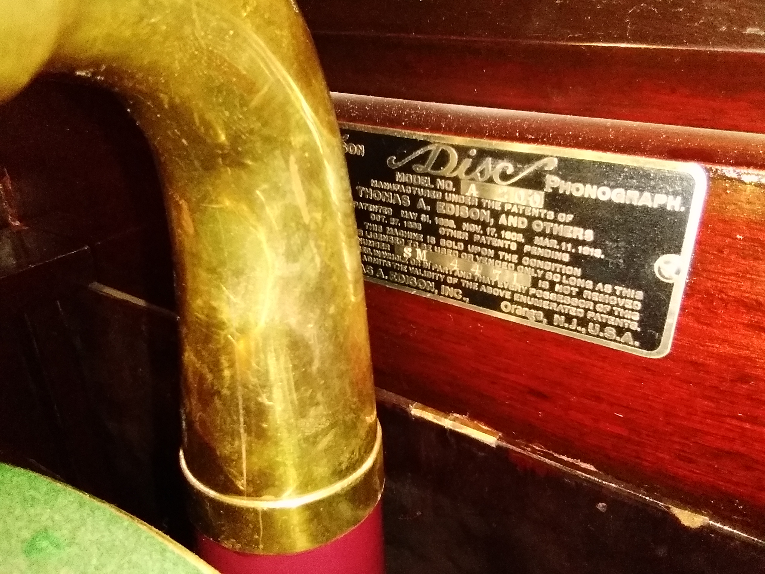

This is the first of the Diamond Discs that I've ever owned; quite a fun machine to take apart and look at. It's incredibly overbuilt. Everything on there is robust, heavy, built to last. From what little I've found these are some of the earlier Edison machines to hit the market, perhaps the first models sold (A-60?, A-100, A-150, A-200, A-250, and A-275. Wish we could find more A-290s.) Unfortunately I know practically nothing about this type of phonograph, being more of a 78rpm & cylinder collector.

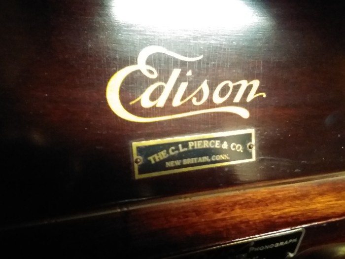

The dealer tag is for the C.L. Pierce & Company music store at 246 Main Street, New Britain, Connecticut. It's not there any more but it would've been just across from the Civil War monument in Monument Square. The old building there I might have to go take a picture of & see what it is now.
This phonograph was restored by a fellow named Don, who's since deceased--he died not too terribly long ago, and he had collected some 25 or 30 phonographs and some of those huge carven cuckoo-clocks that stand four feet tall and look right at home in the tall-ceilinged hunting lodges you don't often see nowadays. He didn't have kids or a family really so he left it to a friend of his. The friend didn't use it, wasn't interested in it, got tired of it, and sold it. His son whom I bought it from (the son of the friend) didn't seem to know how to shut the lid. So the Edison sat down stairs in a hallway with the spring wound all the way up and got ignored until someone had the notion to sell it.

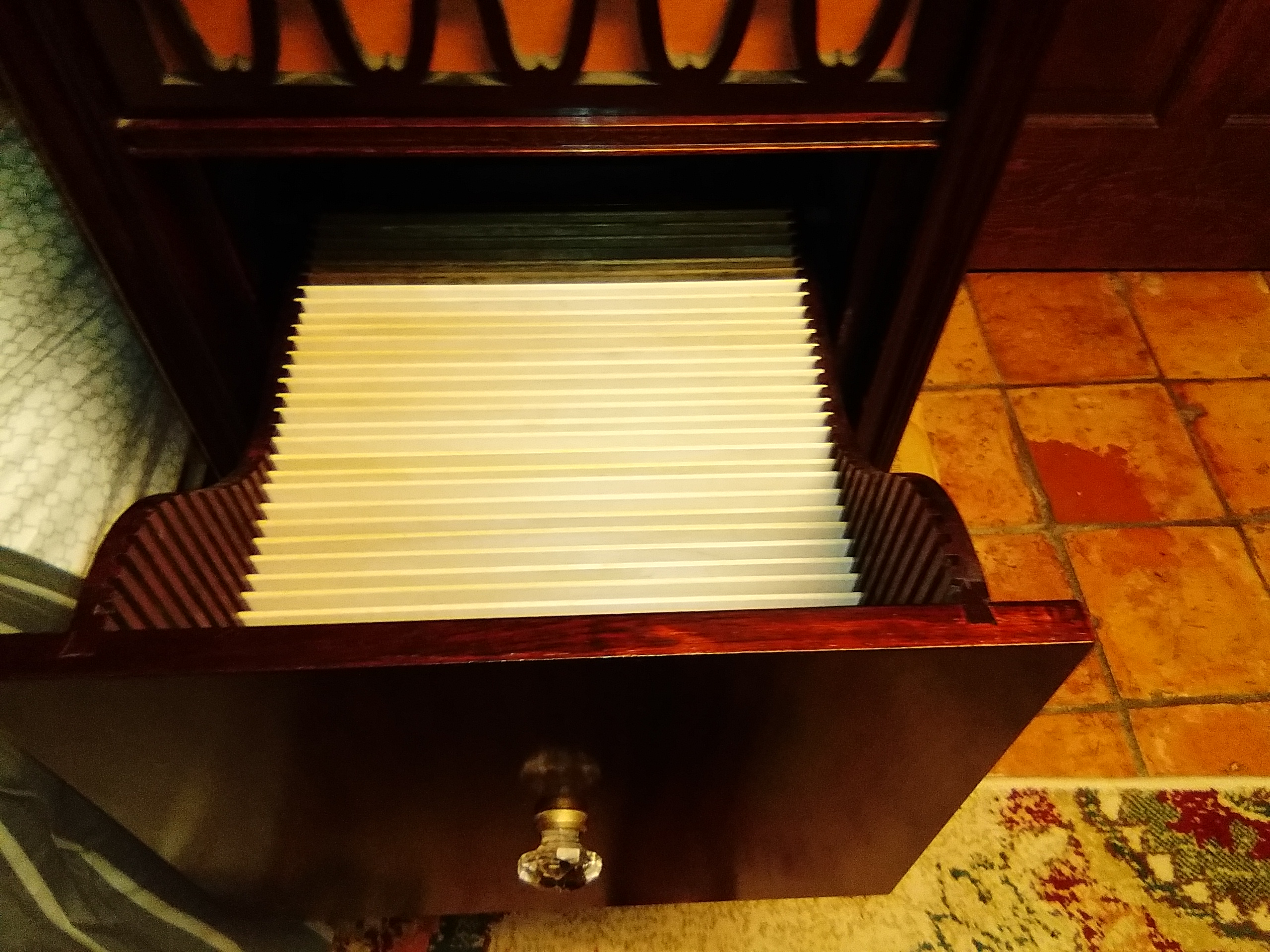

The finish is polyurethane and the horn paint is red maroon, like for a red Gem. Don also replaced the grill cloth and most of the wooden dividers in the record drawer, and he built a great little record library to go with the machine before it was given away, mixing country with jazz and whatever else--unfortunately these records were not only unappreciated; the people who had the machine did not even know how to turn it on.
Well, though I have no idea how to get everything working on it, I'm mighty glad to have it & it's one machine that (unlike my others) didn't come into the collection as a phonograph-shaped kindling pile with some rust sprinkled in it. Most of my machines start out pretty rough and need a ton of tampering and fettling to get back right. With the Gem being a colossal project in a tiny case, this is a big machine that's only a little bit of a project at the moment. I suppose I will refinish it in a more period-appropriate finish after college, and making a new mute ball for it shouldn't be a big problem.
And that's how I ended up with an Edison A-200. If I can get it to where all the controls work properly I'll let you know! The little rack doesn't want to tip up and disengage from the gear. I have to keep adjusting the height--and I'm not sure how to tell if a Diamond Disc is playable either. But so far I am kind of surprised that I ended up with an Edison DD machine and some fun records. Thank you Brett Hurt the "Dyslexic Genius" for both the encouragement to go ahead & get it, as well as the information on the A-200 in general. Your videos on setting the tracking & reproducer height for these are much appreciated.

Well Andy, guess what was wrong with it...AmberolaAndy wrote: Tue Nov 23, 2021 12:02 am
That’s awesome Charles! Hopefully you won’t have any frustrating issue with it. (like I am currently having with my B-19 feed rack! I’ll probably make a thread about it soon.)
The feed rack!
Of course it's the feed rack. I can reach in the front & manually set everything, and then it'll play just fine. It sounds quite nice. But it won't release from the rack when I press the lift lever down to raise everything. I'll get that set up.
As for the missing mute ball, the cable mostly works, and I have the metal end of it so I have to make a replica--no big deal; I've got a sewing machine. That problem isn't a real objection. And I can let the polyurethane finish slide too. It's just getting in there & setting the timing on the rack release that I have to figure out. But if I do I'll let you know.
I've really enjoyed your B-19 posts too; that light-finish gumwood case is going to stand out in the collection.
There's another A-200 parked up in New Hampshire, currently listed in the Trader at the nominal price of a dollar, to go to another collector--It was tempting! And I think it's still there. I just didn't have time to get to NH to go salvage it and ended up salvaging this one. Someone needs to jump on that one in NH as it's in substantially more original condition than this one and supposedly lacks only a crank.

No, this one tracks great but when I pick the needle up with the lever, it won't disengage. So the needle gets stuck at the end of the record.
I moved your question about the B-19 adjusting rack over to the thread on resurrecting the B-19 itself, so it's all tidier. Maybe that is silly of me but hey.
(Edit: I fixed it. There is a rack out of adjustment in there. The rack height on this machine is adjusted by a spring and a screw, right there at the mouth of the horn. The screw is underneath, and the spring on top where the rack itself pivots vertically. So I put more tension on this spring--which raised the rack--which let the horn glide more easily--which also, when I pull the operating lever, lets the rack gently float out of mesh with its worm gear instead of clashing in and out of gear.)
So that was a surprisingly anticlimactic repair--not even a real repair but just one adjustment. Okay, I'm fine with that.

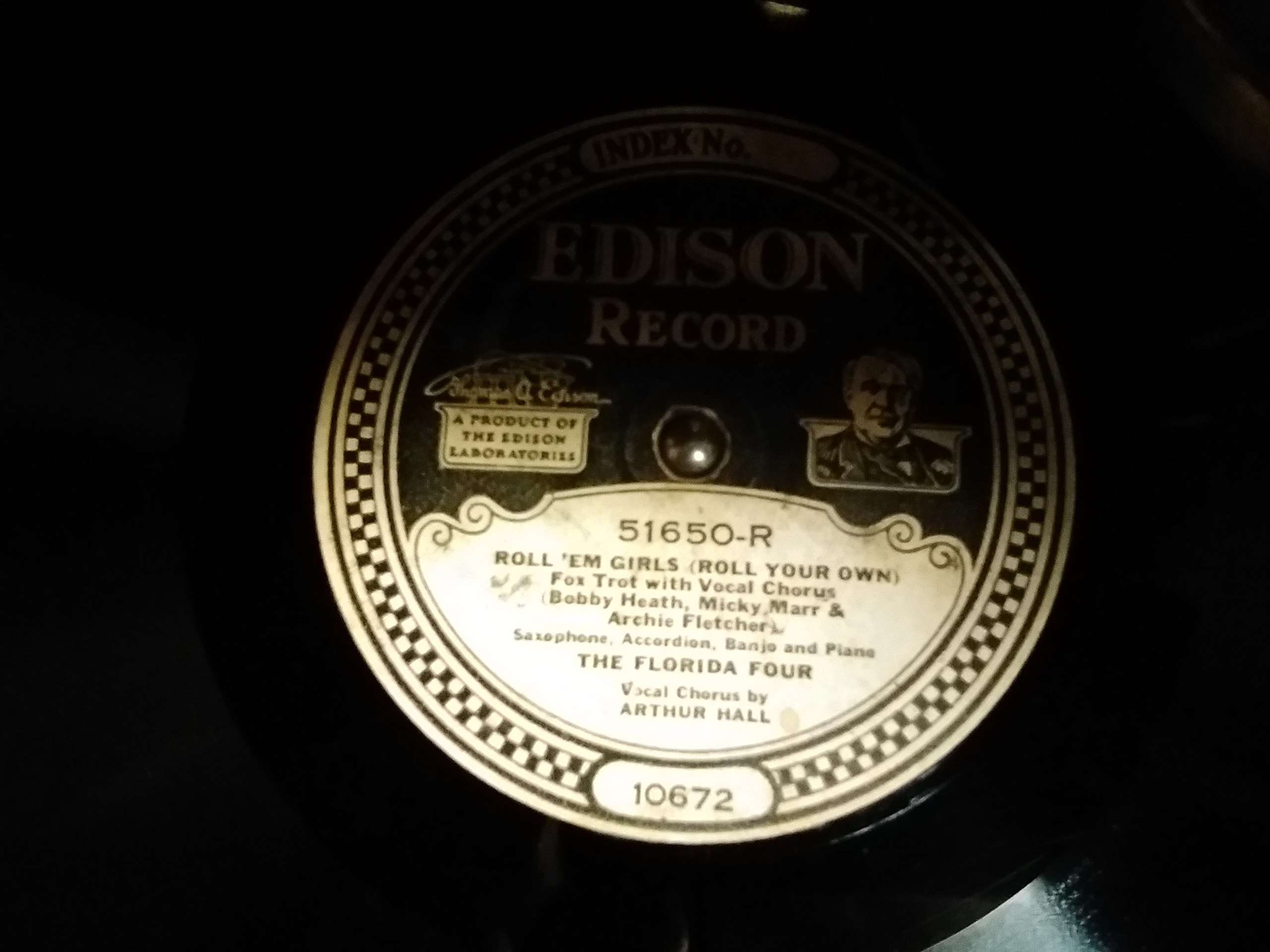

Re: A200 with 4-digit serial comes home
The Florida Four are a great group - noticing the disc on the turntable. Great find! The early Edison DD machines are tanks and the A-200 bridges the 'awesomely overbuilt' with the 'remotely-space-conscious'
