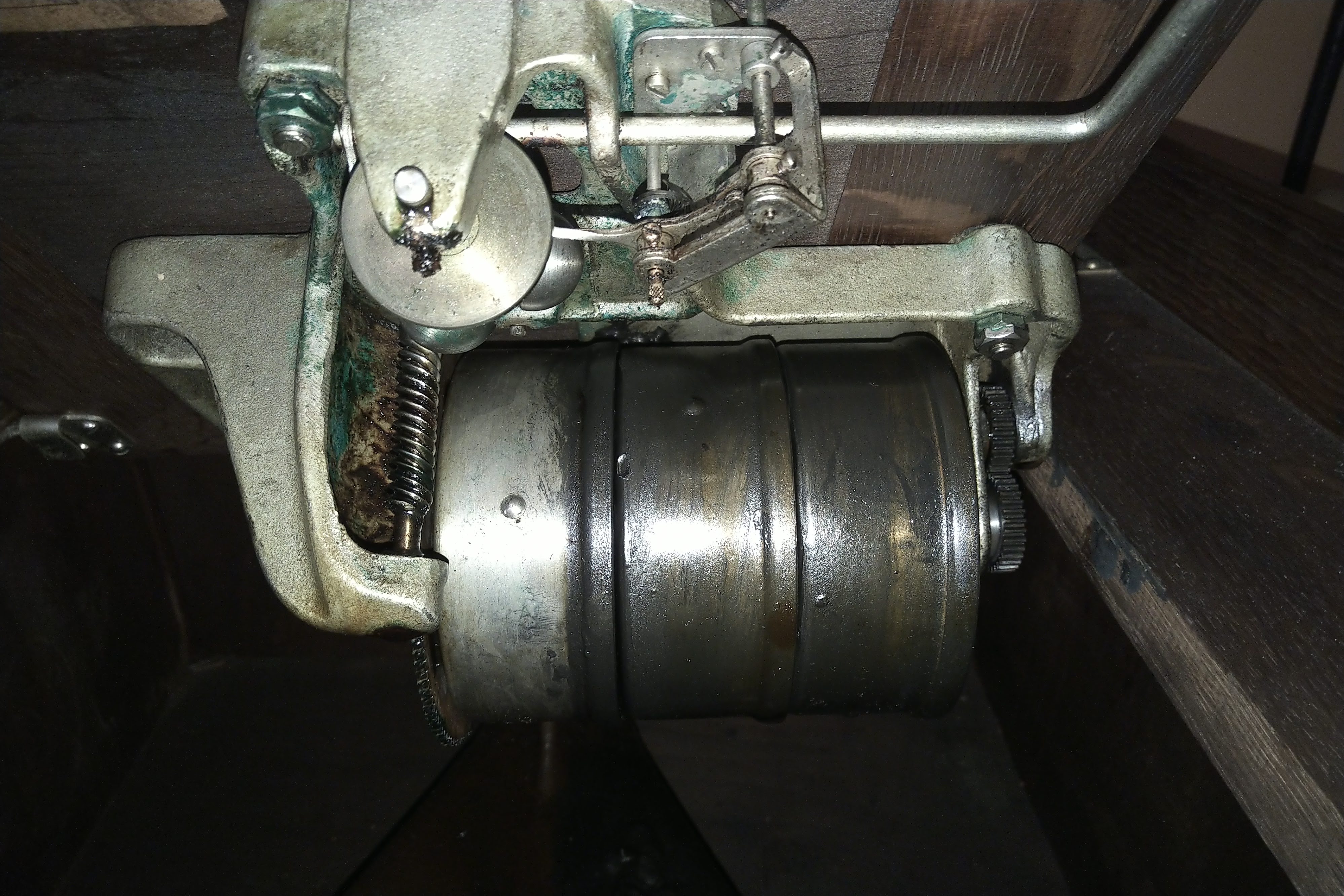

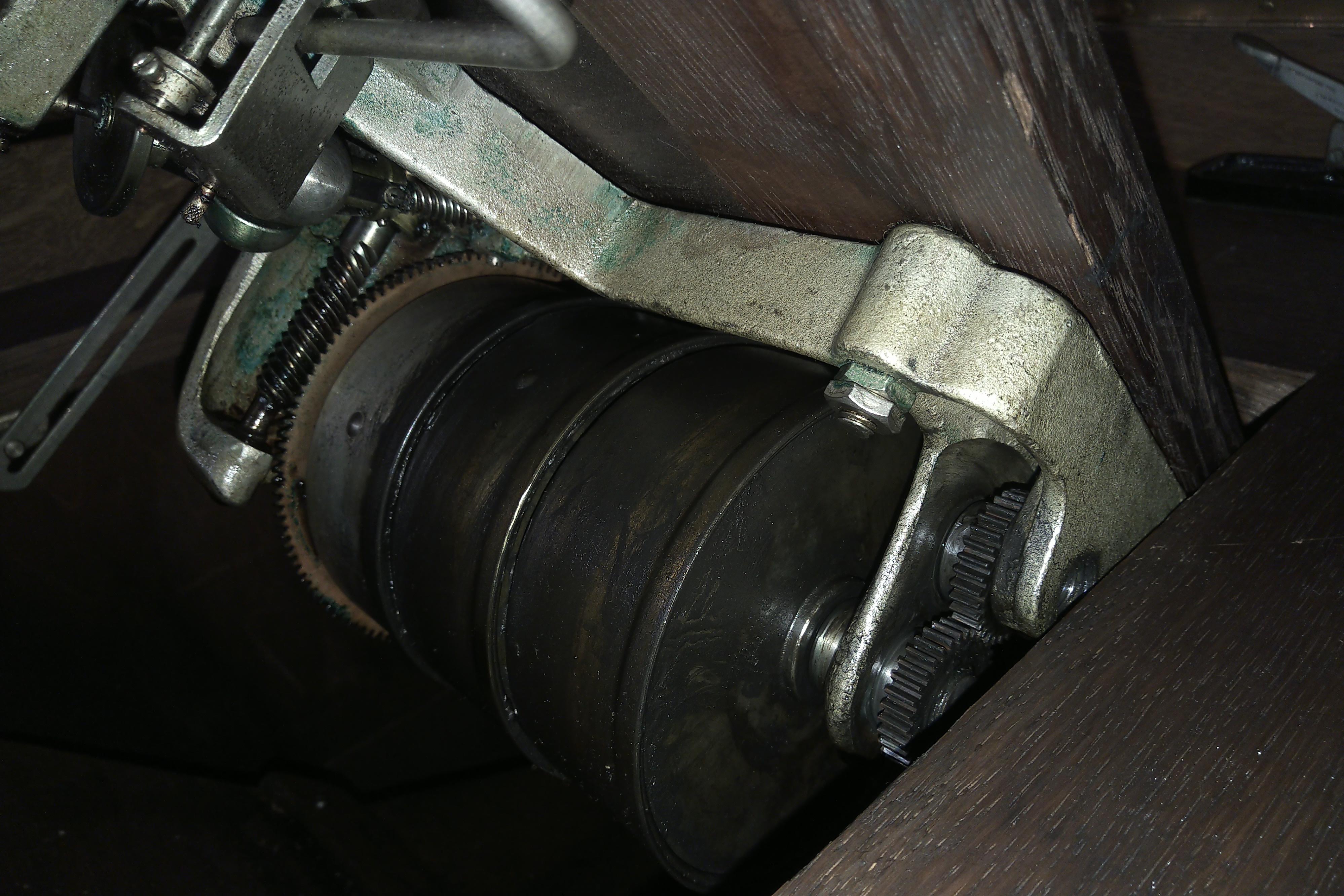

Here's some photos of the motor as well.

Hello Giovanni--Not to worry. Those barrels are perfectly fine turning a bit. Of course as old as it is it would benefit from being completely overhauled, as well as the reproducer, as this will help it play better. It's also fine to run the motor while it's up and open; that's a good way to watch it running.

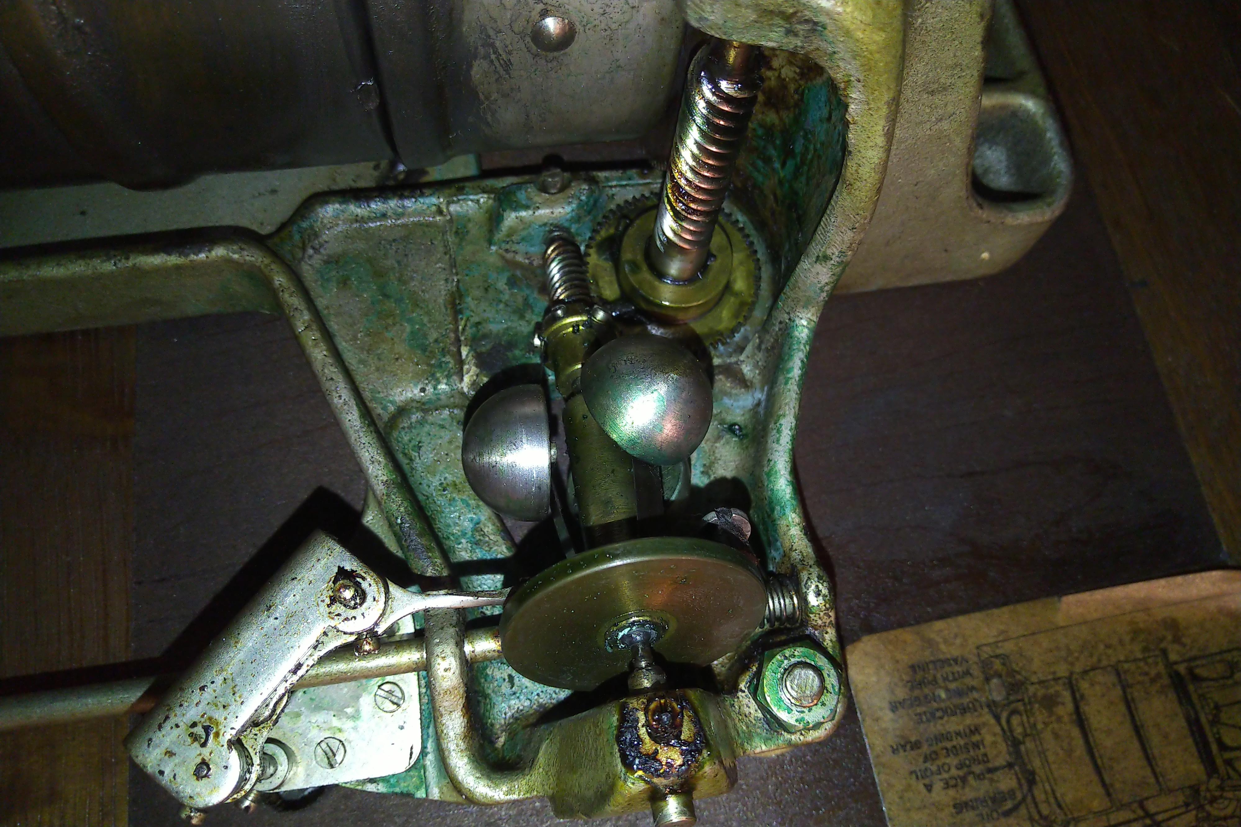

I'll point out that this fast squeaking noise is done by the governor, I bet .. the thing with three balls that spins the fastest. In between you send it for repair, just add a drop of light sewing machine oil on each bearing at the ends of the governor axis, one more on the governor axis where a brass disc attached to a brass neck slides on, and wet in oil the two leather pads at the end of respective fingers, that slide on this brass disc when rotating. Don't disassemble the governor if the motor is wound up! or it will run down savagely in a zip that will destroy the gears and maybe hurt you! All this oiling can be done without disassembling.
Also add some drops of oil at the down end cup where the turntable spindle rests. There's a ball bearing inside.
If your machine still had the paper label with the oiling diagram stuck inside the motor compartment, this will help you to see where to oil. It could be attached to the bottom of the motorboard....
Do this oiling and try again, it should improve.
Also add some drops of oil under the turntable, where the spindle goes through the upper motor casting, that is, it's upper bearing...

Giovanni, I think the middle drum has a broken spring. At the 1:20 point of your video you can hear the spring slip and the drum moves backwards. It should not normally do this.

Here's my 2 cents, only because to one else responded to your comment "While the motor spins when it's opened like that, it barely moves at all when everything's put back together".
The governors bearings are dry and/or not adjusted properly and are binding, hence the chirping bird sound, when the motor is flat, your change the position of the governor shaft and it stops; at an angle, it allows the main turntable spindle to over come the friction of the dry spindle bearings in the governor and it works.
The governor shaft could also be bent and it won't spin properly in it sleeve bearings, so no matter how much lubrication there is, it will always squeak.

The sudden jerking of the middle spring barrel is normal for a motor that has old sticky graphite grease in it.
As the springs unwind, the middle spring is not letting go at an even rate, and then it suddenly does and you get this "jerking" motion when it does.
The spring barrels are supposed to gently turn like they are as the springs slip and unwind.
When it's wound up, one spring winds up another, so if one spring is 4 feet long, it's like have a huge long spring of 12 feet.
So for it to work, the springs have to be lubricated with the correct grease, so they unwind at an even rate.
Don't use the motor like this, it stresses the springs out because the old grease is preventing the springs to unwind at an even rate.
In some cases, if the motor is wound up tight enough, the first spring that gets wound to the top will not let go.
This can can cause the center spindle to become disengaged from the centre of the spring, and you don't want that to happen, it depends upon how it's engaged, some Victor motors can become disengaged, I don't know about Columbia's.
Given the fact that all the barrels are turning down at a fairly even rate , except for that one time, the centre shaft is still properly engaged in all the springs.

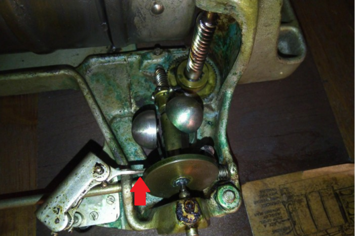

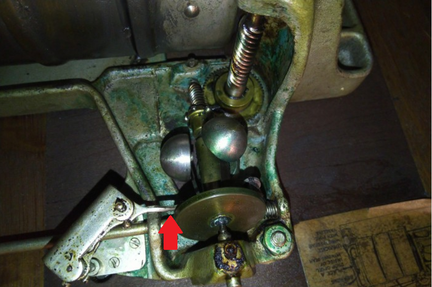

Just noticed this.
The speed indicators metal clamp looks twisted and it seems to be coming in contact with the governors brass fly-wheel.
It looks as though the felt isn't even doing its job, that would also cause that squealing chirpy sound.
