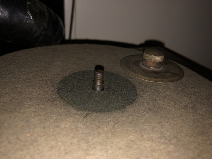

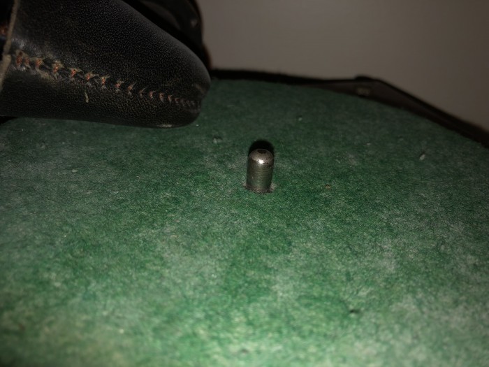

I've noticed that screw-on record hold-downs appear to have been used on only my earliest Victor machines. My Victor E, SN# 18128, has a threaded spindle with screw-on hold-down, while Victor E, SN# 55617, has a standard spindle, and presumably no hold-down was ever used. (The spindles on the two machines are pictured.) Were hold-downs discontinued after a certain date?
Thanks - Mike
