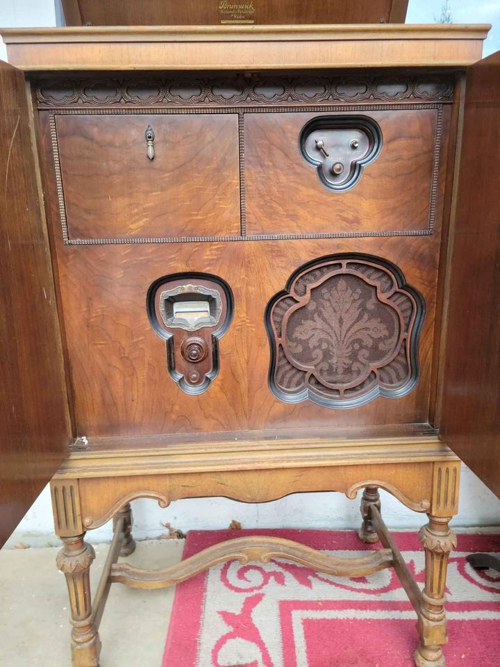

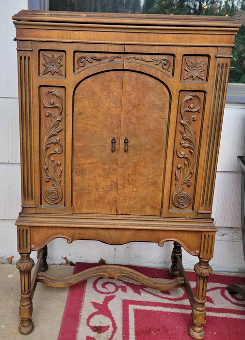

I have the opportunity to purchase a Brunswick Panatrope Model 42 changer. Currently not working. Would this make a worthy project? I have a guy locally that can rebuild the electronics if needed. I don't know how much mechanical work is needed.
Curious if any of you own and have restored them yourself. Would like to have a resource if I do decide to pick it up. And would should I look for before committing to the purchase?

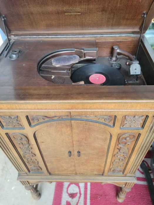

I've restored a couple of these units. Nice compact changers, The only changer that Brunswick made. The electronics aren't hard to restore if you are familiar with pre 30's radios, the radio is a modified Brunswick Model 15.
The changer is built very well and other than a good cleaning and lubrication it's pretty much bullet proof. The original models only played 10" records, later a modification was made to allow the ability to single play 12" records. For being a slinger style changer it is fairly easy on records.
The one pictured appears to have been modified for 12" use
Chuck

I have one and the motor housing is all pot metal and is falling apart. Off and on I've been looking for a replacement for it, so make sure that stuff is in good shape. There is no simple replacement for that because of the way it's all cast. I figure if I have time next year I'll just replace all of that with a single place mechanism as I've got it all refinished and the amplifier, et. are restored. At least then it will play a record. They do look MUCH better refinished. Those early lacquers fade a lot.
