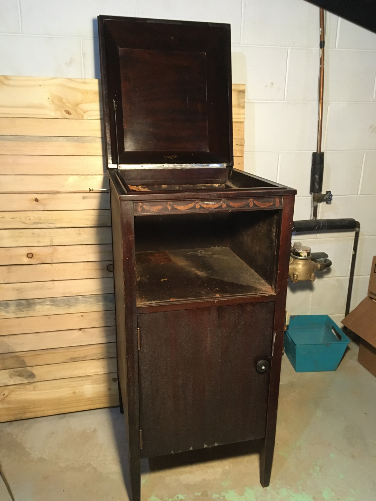

I am about to refinish this Pathé cabinet, I plan to use "shellac finish and sealer". Should I buy the clear kind or the "amber" variety? Is Zinsser a good brand, or is there another recommendation? I will clean the whole cabinet with denatured alcohol first.
Shellac finish - clear or amber?

Just my opinion, but I don't see a good reason to do a full refinish on that. I would Goop it to clean it, then try Howard Restor-a-Finish and Howard Feed-n-wax. Then if you're still not happy, refinishing may be in order. Good luck whatever you decide to do.

Yet another example of Pathé's nearly universal design for upright phono cabinets. I have one very like it (a Model 100), which was my first spring-driven machine. I'd suggest before launching into all the work and possible expense of refurbishing it, you consider a couple of questions. First, do you have the grille? I've been looking for a replacement for mine, in a desultory sort of way, for years, and I've not seen one. They seem to be quite scarce on the ground. Second, do you have the internal horn element that is missing in your photo? That swoopy s-curve line on the floor of the interior chamber is the outline of a curved wall that forms the right side of the horn (as you face the machine).
If the answer to either question is "no," I'd think hard about putting much into the cabinet. They're nice machines, but for whatever reason they don't seem to have much of a market.
Oh, and apologies if you already know all the foregoing. Just trying to help!
[edit] I just noticed that the decorative applique over the horn chamber is missing, leaving behind just the outline. Do you have that? Another thing to consider.

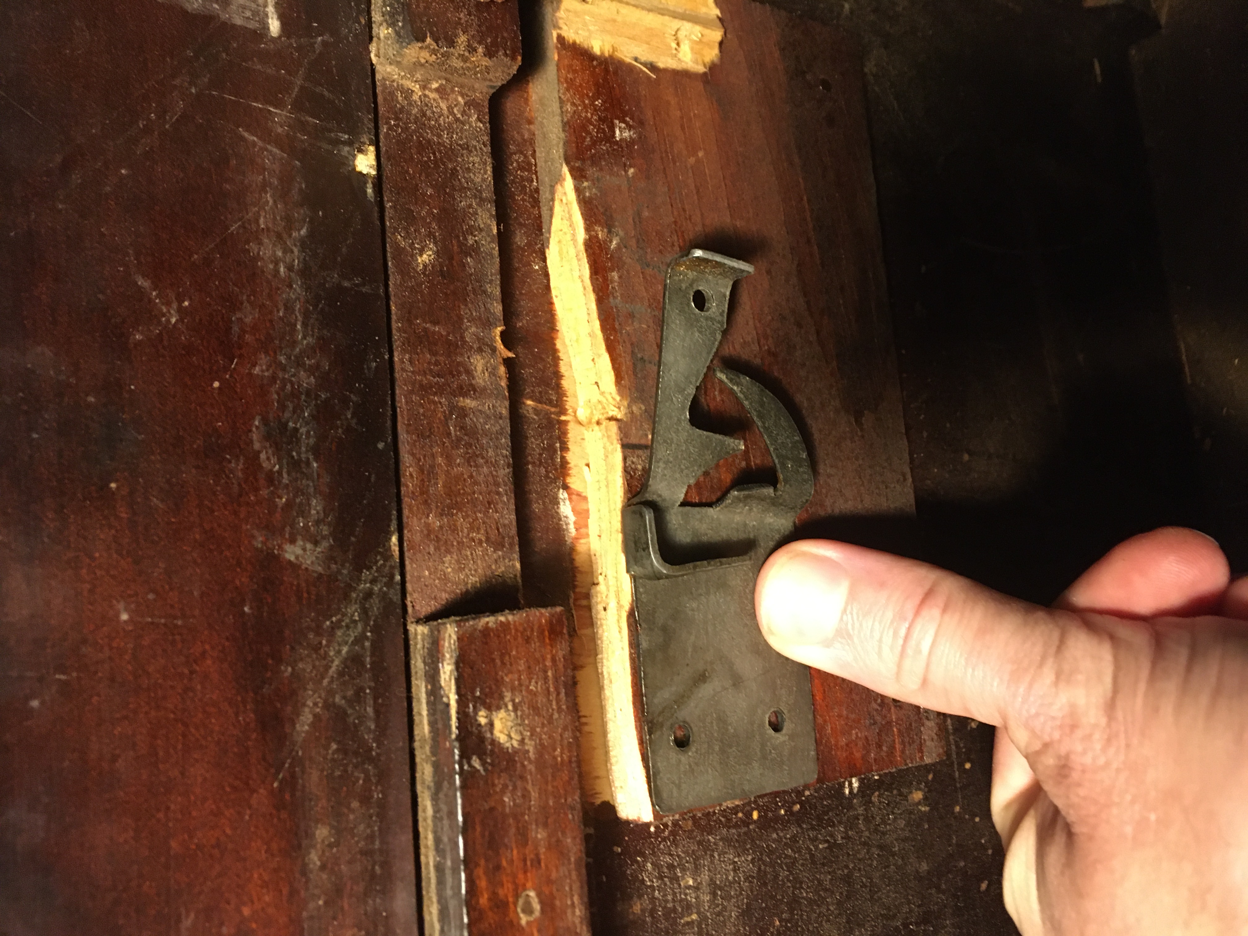

Yes, I have all the pieces you mentioned. I had to remove the horn in order to re-mount the lid support bracket, which had broken away from the wood. Does anyone know which way it is mounted? I attached a photo here showing what I think may be the correct position. But I could be wrong. You have to click on the photo to show it correctly rotated.drh wrote: Mon Jan 03, 2022 2:16 pm Yet another example of Pathé's nearly universal design for upright phono cabinets. I have one very like it (a Model 100), which was my first spring-driven machine. I'd suggest before launching into all the work and possible expense of refurbishing it, you consider a couple of questions. First, do you have the grille? I've been looking for a replacement for mine, in a desultory sort of way, for years, and I've not seen one. They seem to be quite scarce on the ground. Second, do you have the internal horn element that is missing in your photo? That swoopy s-curve line on the floor of the interior chamber is the outline of a curved wall that forms the right side of the horn (as you face the machine).
The decorative trim, I had to order from George Vollema.

You'd have to check colors in person, but I'm thinking mahogany is more likely.derik_olson wrote: Mon Jan 03, 2022 6:01 pmWould that be the dark oak variety of Restor-A-Finish?52089 wrote: Mon Jan 03, 2022 12:51 pm Just my opinion, but I don't see a good reason to do a full refinish on that. I would Goop it to clean it, then try Howard Restor-a-Finish and Howard Feed-n-wax. Then if you're still not happy, refinishing may be in order. Good luck whatever you decide to do.

Amber shellac. Don’t use that Howard’s crap.
