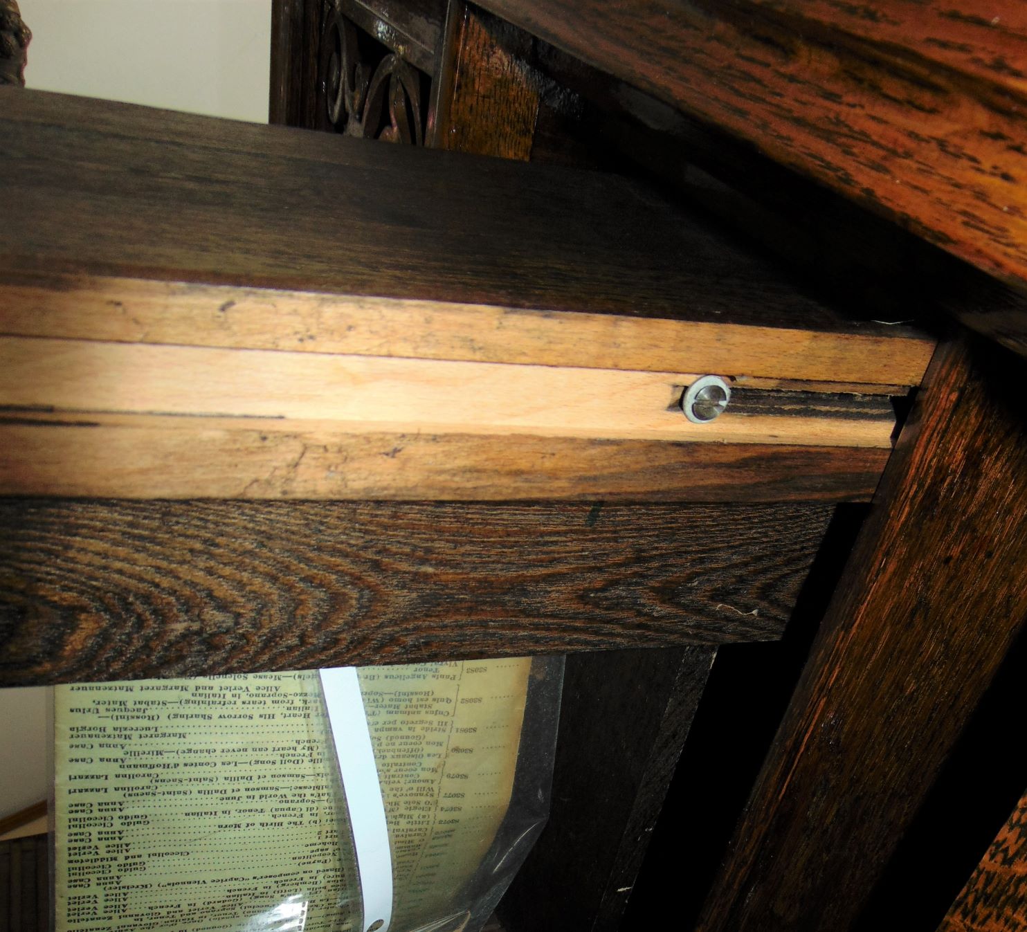

Mine has screws up from the bottom with washers between the screw head and drawer. They are kind of a pain to get in and that's probably why someone didn't put them back in place. Maybe the picture will help.

Thanks. I was thinking something like that would work. I'll have to give it a try. I'm also from North Central Iowa!
