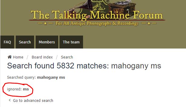

This is not a criticism, just an observation: the Search feature can be very problematic or confusing for occasional users such as myself. Just the other day I was searching for an old thread on a mahogany MS and thousands of hits came back. I suppose it is my ignorance of how to use it that is the problem, but I can’t be alone in this regard. I finally found the post I was looking for by adding the author’s name, and then it popped up.
Raphael
Posts: 6823
Re: New felt--how to apply
Raphael wrote: Fri Jan 28, 2022 2:48 pm This is not a criticism, just an observation: the Search feature can be very problematic or confusing for occasional users such as myself. Just the other day I was searching for an old thread on a mahogany MS and thousands of hits came back. I suppose it is my ignorance of how to use it that is the problem, but I can’t be alone in this regard. I finally found the post I was looking for by adding the author’s name, and then it popped up.
Raphael
You are correct. A search for "mahogany MS" would only net results for "mahogany", for which there must be at least thousands, as you say. For reasons well beyond my ability to understand, the search function ignores words, (or in this case model numbers), of less that 3 or 4 characters. It also can't process things like "orthophonic 8-9". It will only return results for "orthophonic".
