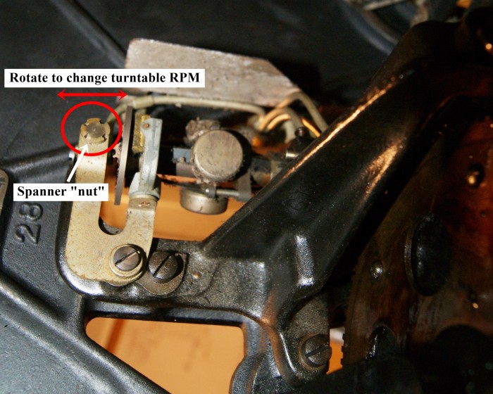

toysbyroy wrote: Mon Jan 31, 2022 7:04 pm I have an Edisonic that runs too slow. I have cleaned and lubed all obvious points, but still runs slow. Where might I adjust the speed? Thanks, Roy
The adjustment for the later "Type B" mechanism used in the Diamond Disc Phonograph is, as pointed out by 52089, underneath the motor plate on the governor "speed disc" side of the governor.
Cheers,
Fran
