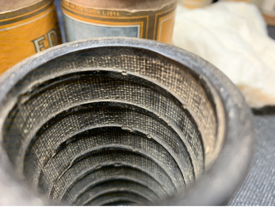

In October of 2019 I bought a bunch of Edison brown wax blanks. Most all of them had this thread core. I posted pictures of the on the forum. Here is a picture of one.

Thanks for re-posting this image of your cylinder's interior. I don't know if I would (technically) call this a "threaded" cylinder, more like "mesh." It doesn't look as if it was being used for purposes of "truing" but perhaps more for strength.
The "threaded" cylinders have the actual (helically-wrapped) thread making contact with the mandrel (not the ribs per se). Sometimes, the continuously-coiled thread would lose a little cohesion and a vagrant "loop" would detach itself from the rest of the sleeve.
However, iirc, the little wax cylinders on the Edison Talking Doll (1890) did use "mesh" inside (presumably for strength and adhesion).
Allen

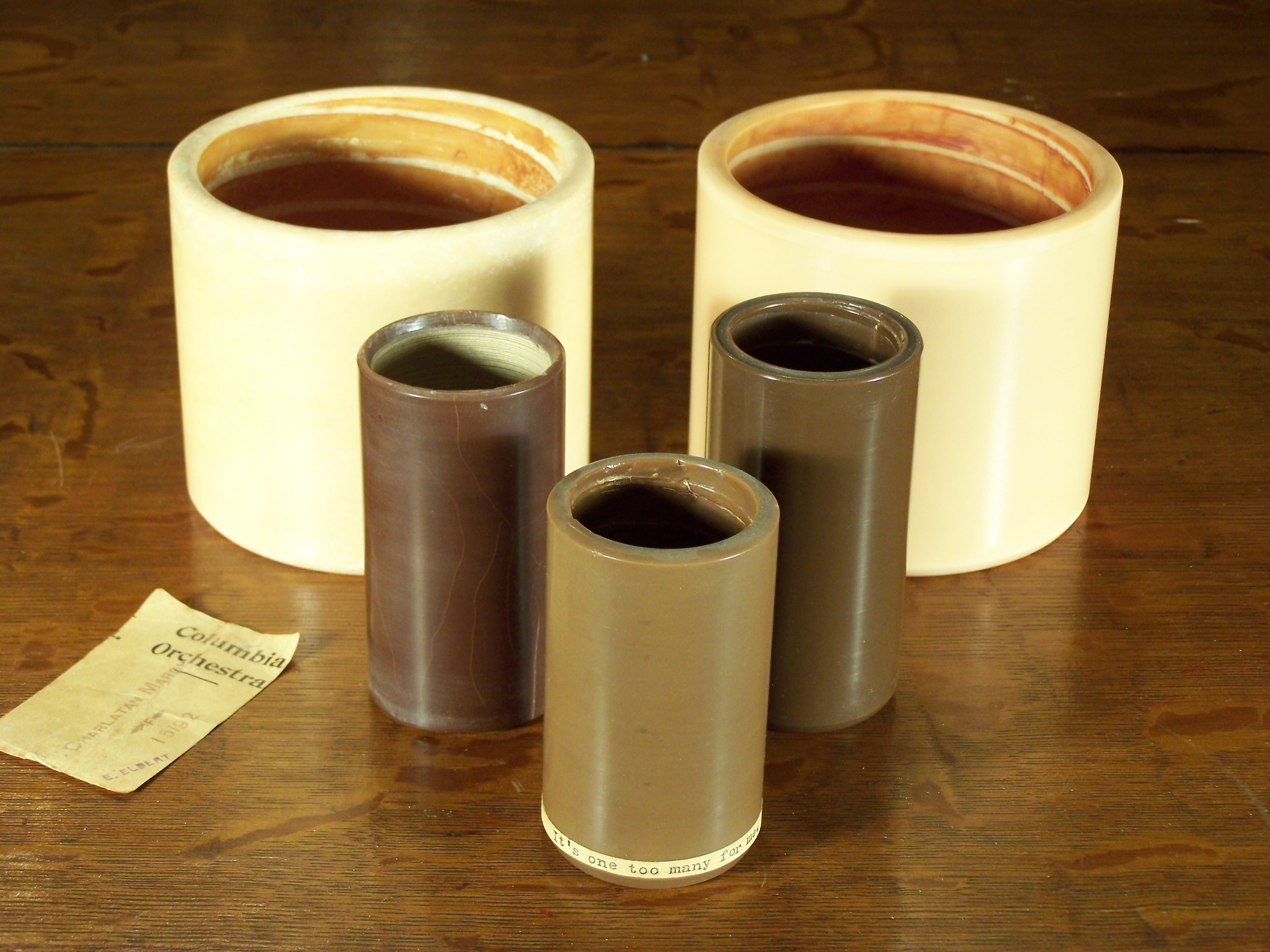

The middle left cylinder is an example of an 1889 string-core cylinder. Note that there are no helical wax ribs - only the string wrapped very closely upon itself. Click image twice to enlarge.

This type of cloth liner was used in the shatter resistant ( safety ) Ediphone dictation blanks I think from the mid 1920s onwards, so this may be a factory shortened blank or a later trimmed 6 inch blankrgordon939 wrote: Tue Feb 08, 2022 4:13 pm In October of 2019 I bought a bunch of Edison brown wax blanks. Most all of them had this thread core. I posted pictures of the on the forum. Here is a picture of one.
