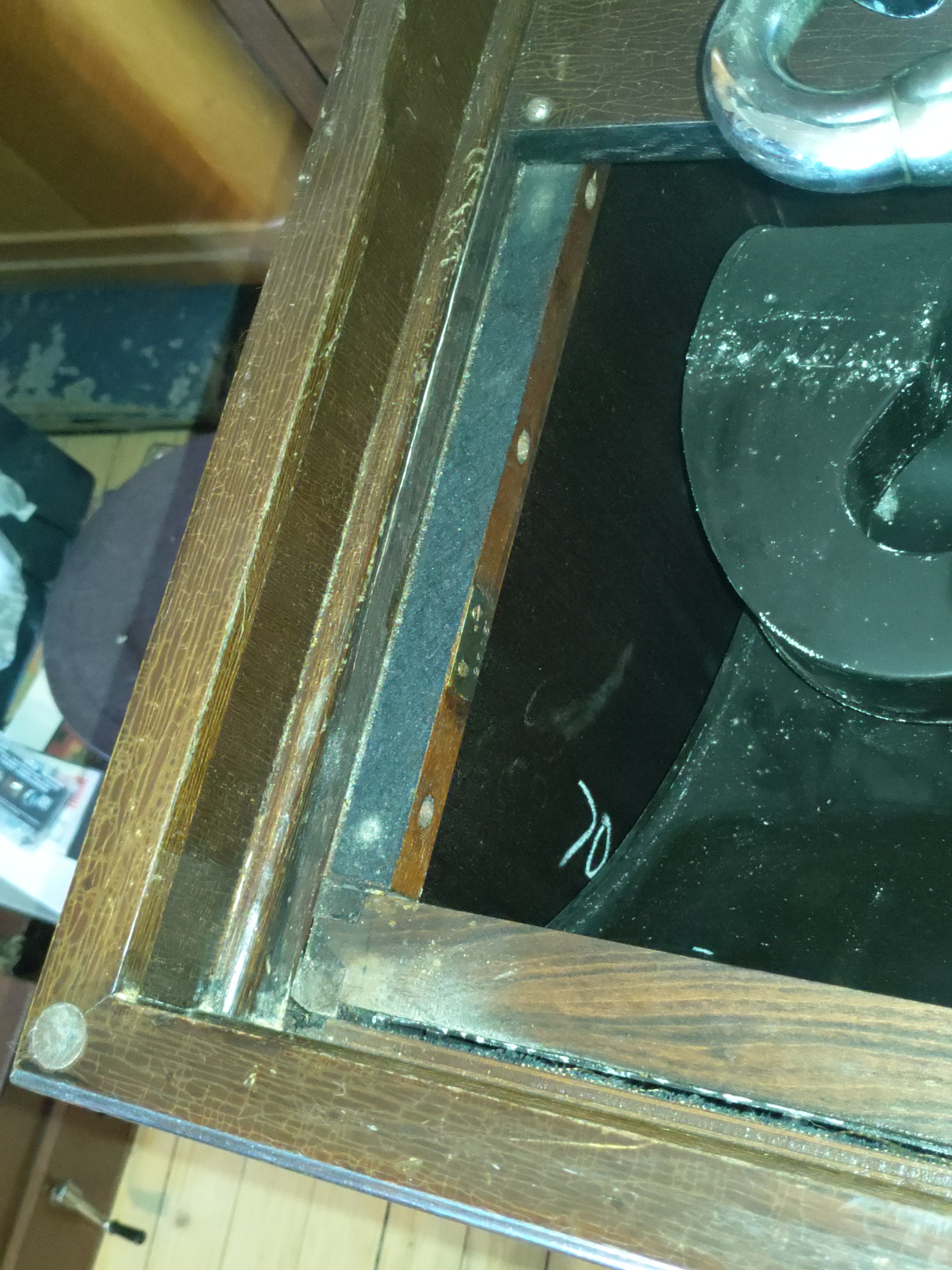

I removed the tonearm, as normal, and the brackets holding the tonearm, and the inner wooden board surrounding the tonearm, as well as the screws holding the horn.
The horn was still stuck, and the next necessary step to take, would be to remove the wooden front frame, as shown on photo. The parts of this frame are however glued together, and the wood is in addtion atttached in a manner that I guess in English is called tongue and groove, as we also can see on the photo. The upper part of the horn is bending under this frame, and is impossible to relocate without detaching the frame. On the 157 there is no way to access the horn from the back of the cabinet, contrary to the 194 and 163 etc.
So why would I consider destroying, or removing the horn? Well, this man contacted me, and had a HNV 157 without a horn, inherited from his parents. I started to tell him that removing the horn on my 157, would leave my 157 in the same way as his cabinet, and that the price of the horn would for me not be too far from selling an overhauled 157, since my plan is to overhaul the cabinet. When I asked if he had the tonearm, the metal parts holding the tonearm etc, he never replied. In addition I told him the 32 motor on his machine most likely also would need a service, so in total..he maybe felt this would become too pricey. We all know, putting a HMV cabinet gramophone back to its original condition is not an easy task for everyone out there, and even if one know how to do it, and have the correct parts, it takes time, patience and knowledge to do it rightly.

Now it is time to correct my wrongs, so no one start believing my wrongs!
Marco, quite rigthtly, there is a way to remove the horn without starting to split glued parts of the frame holding the motor board.
The procedure does not involve removing the back of the cabinet though, as on the 163, 194 etc.

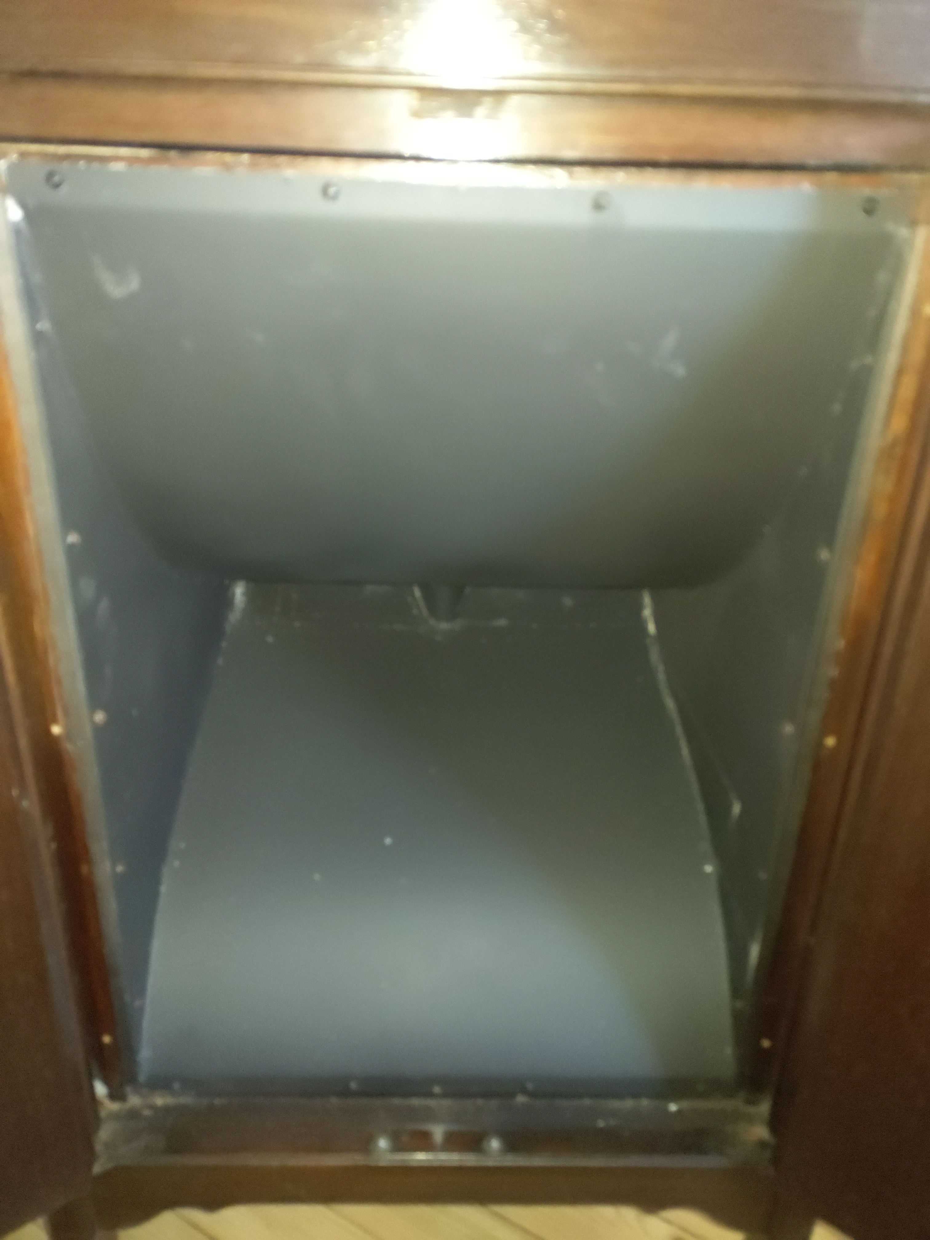

My gramophone has not been tampered with, because when checking again, in daylight, I started to think one had to pull the grill upwards and then later on remove the horn, since the grill was impossible to remove from the front. So...what do you check then? The screws holding the grill, I had in the dark evening some days ago,.,,forgotten to remove one of the screws holding the grill to the cabinet !
I removed the screw, and the grill was easy to remove by carefully pulling it out, not upwards. When having done so, the screws holding the horn in front came into sight, and by removing those screws the horn should be fairly easy to remove, after first unscrewing the tonearm and the base holding the tone arm to the horn.
I will not remove the horn, since there is no need to do it, but now I know how to do it, and also...if anyone in here ever need to do it, we now know how not to do it.
NO need to tear apart any glued parts !
