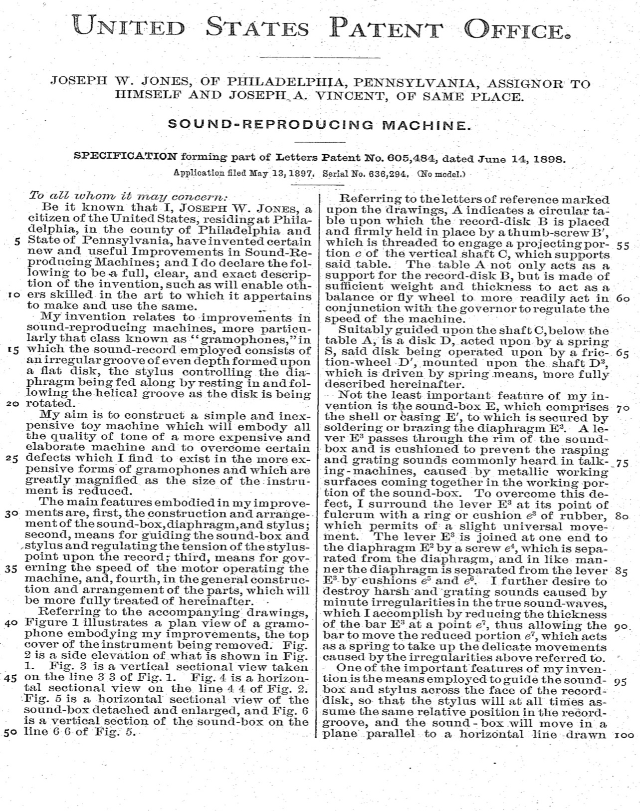

605484 Joe Jones Tangential Tracking
Post by JohnM »
The infamous Joseph W. Jones strikes again!
