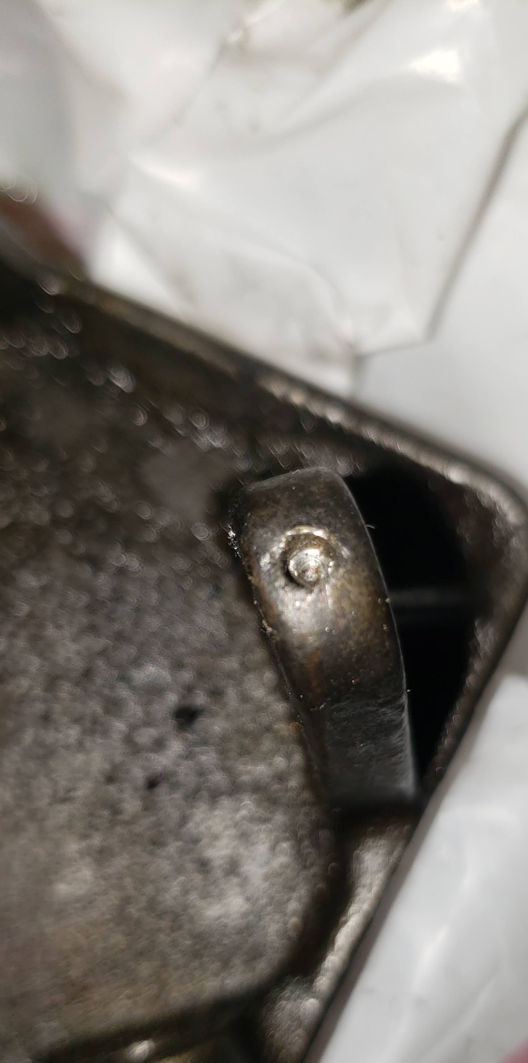

I recently started working on a Victor III I got for a good price but is in poor condition. I noticed that one of the set screws for the governor bearing was missing. Upon further inspection, I noticed that the screw had snapped in half and is stuck in the casting. My question is how should I go about removing this screw without damaging anything? Any help would be appreciated.
Thank you.

It looks like someone tried to drill it out. Typically, when the longitudinal forces are removed from a screw which occurred when the governor was removed, the screw should be free to turn unless it is bugged up or corroded. You could apply some penetrating oil and use a scribe to turn it out. If it is stuck, you should find a good machinist to get it out. It’s a fussy job, but not very difficult for someone with a vertical Bridgeport type mill and decent skills.

Sorry for the confusion, I am in Montreal, Quebec. Could I just drill out the rest of the screw with a normal drill if it is stuck?

Nipper123 wrote: Wed Mar 02, 2022 8:53 pm Sorry for the confusion, I am in Montreal, Quebec. Could I just drill out the rest of the screw with a normal drill if it is stuck?
Yes, you could do that. Use the tap drill size for that specific thread size.
The drill is likely to walk off into the soft cast iron. It is risky.
