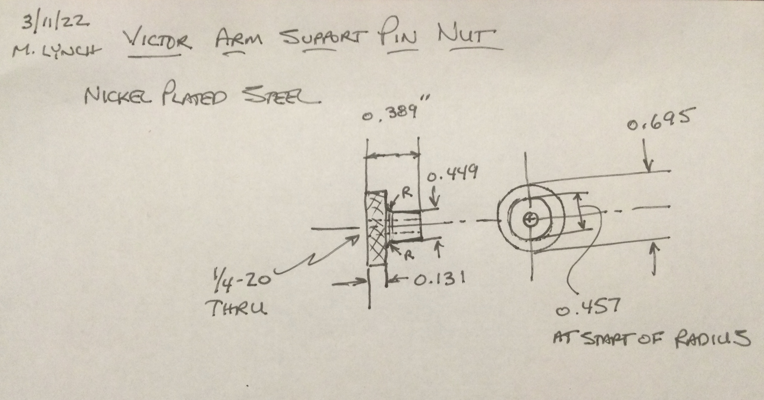

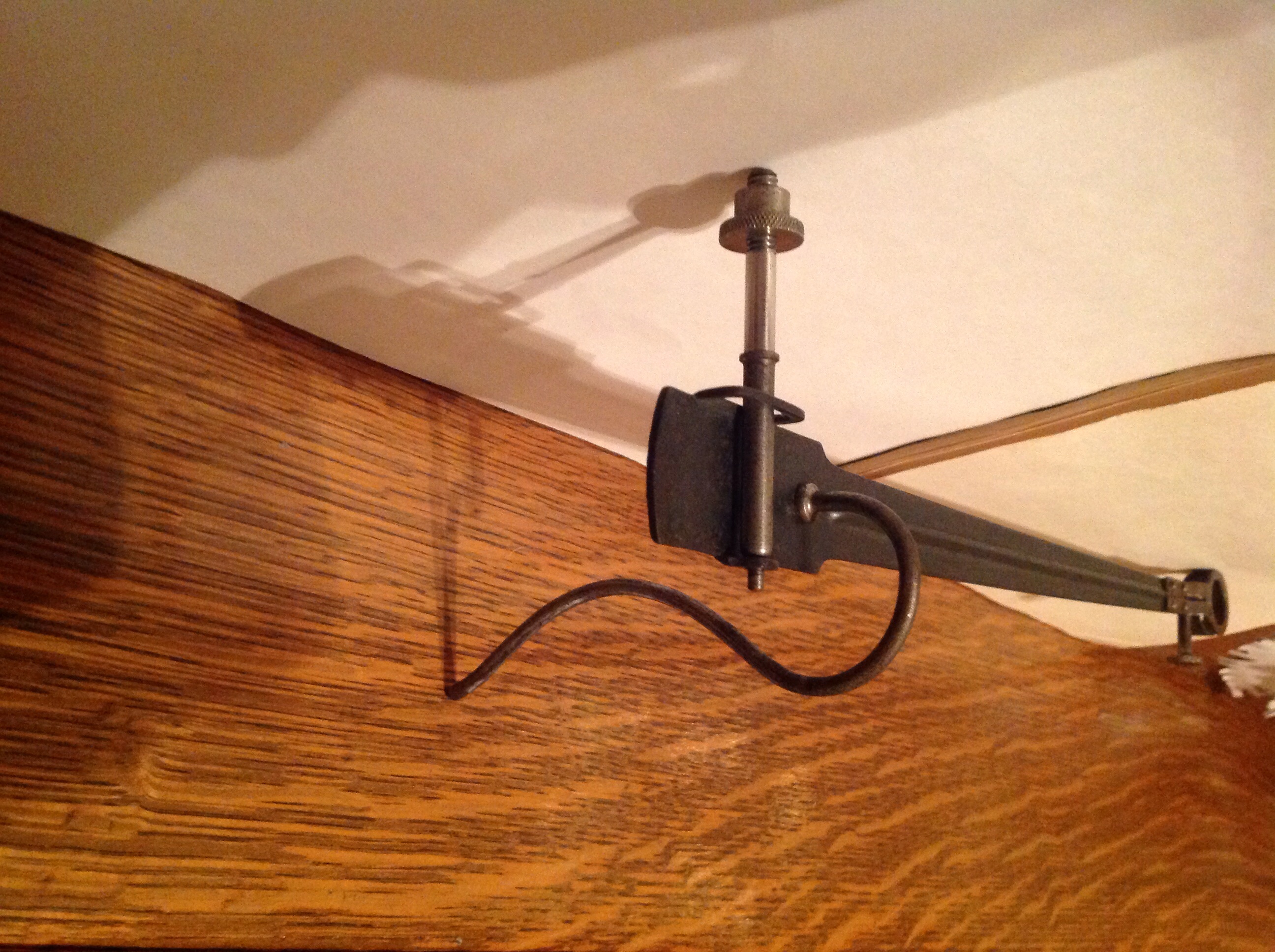

Can anyone measure one of these nuts from their collection? I would like to make one. Diameter and height would probably be enough. Thanks!

Here you go.

Wow! Thank you!

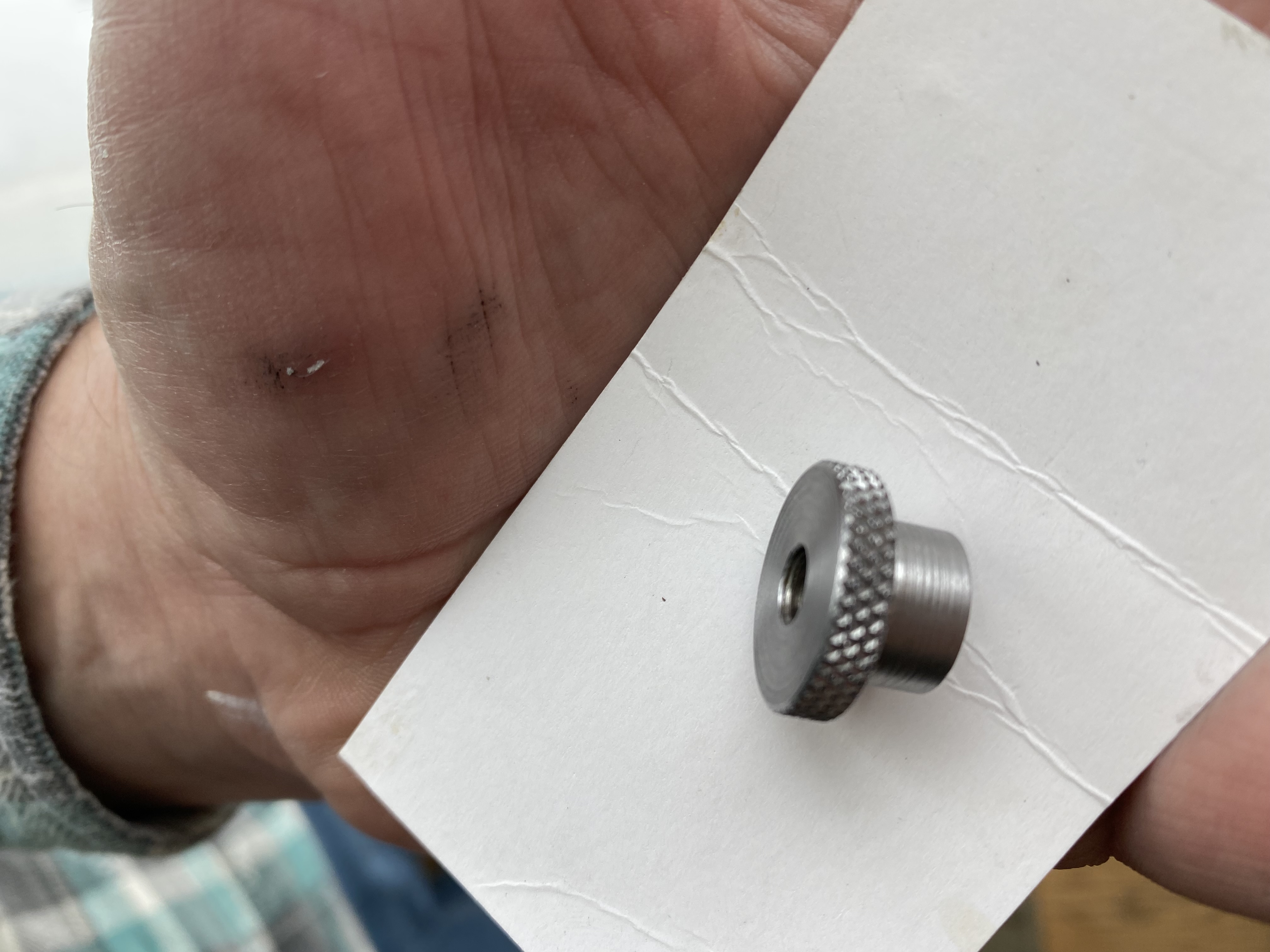

Here it is. I am not going to plate it since the matching pin is rusted and the guy who owns it seems to like it that way.
Thank, you, Mark Lynch for your excellent drawing.

Very nice work Dave!

Good knurl.

Thanks Jerry and Blain!
