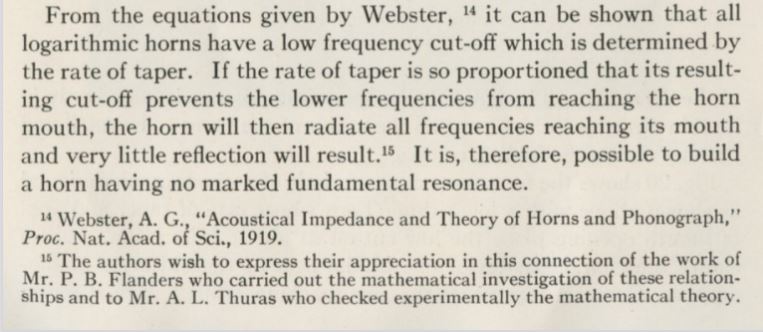

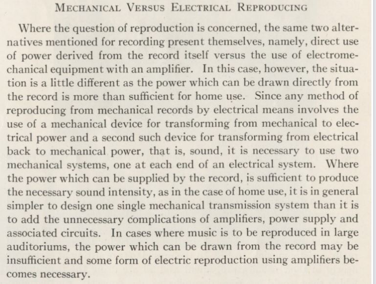

Re: Electrola history
If you return to the published documentation describing the development of electrical recording/playback --
-- you'll see that the Orthophonic Victrola is really the mechanical equivalent of an electrically amplified phonograph designed to match the characteristics of the recording system Western Electric (Maxfield & Harrison) created.
As the authors state --
The heart of the reproduction system is the sound box--not the horn. The re-entrant style exponential horn was specifically designed to fit into a cabinet that could be accommodated in most homes, and enable the sound waves generated by the sound box to reach the cutoff frequency without reflection or distortion.
At the time the research was carried out, there were no conventional loudspeakers (paper-cone designs) available that could reproduce the sonic range captured by the recording process, so I'd say, yes, it's safe to assume that the Western Electric designers initially envisioned that acoustic reproduction was the ideal method.
