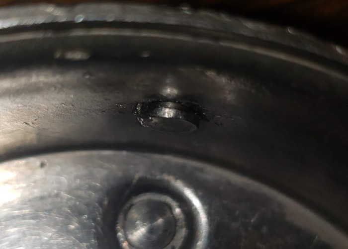

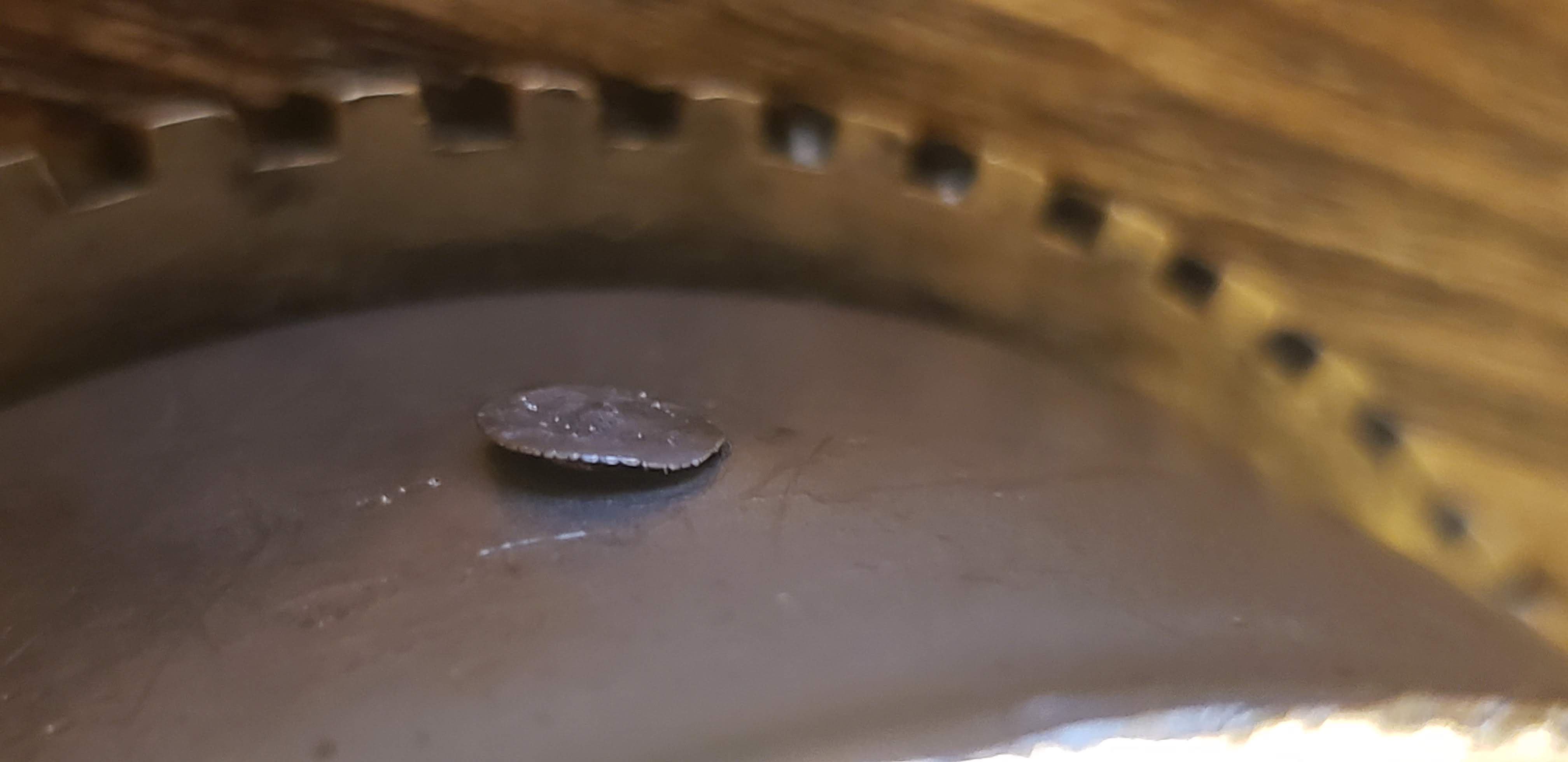

Today I took apart the spring barrel assembly of the Victor III I am working on. Once the springs were out of the barrels I found that one of the rivets that holds the spring in place is loose. It turns but is still in the barrel. I am wondering if I should just leave it be or try to keep it in place with some solder.

I have another question about installing the hook. How much do you let the hook extend out of the barrel before peening it? Also, is there a certain way you have to do it? For example: going from the centre to the edges.

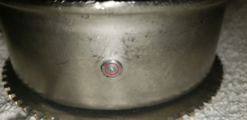

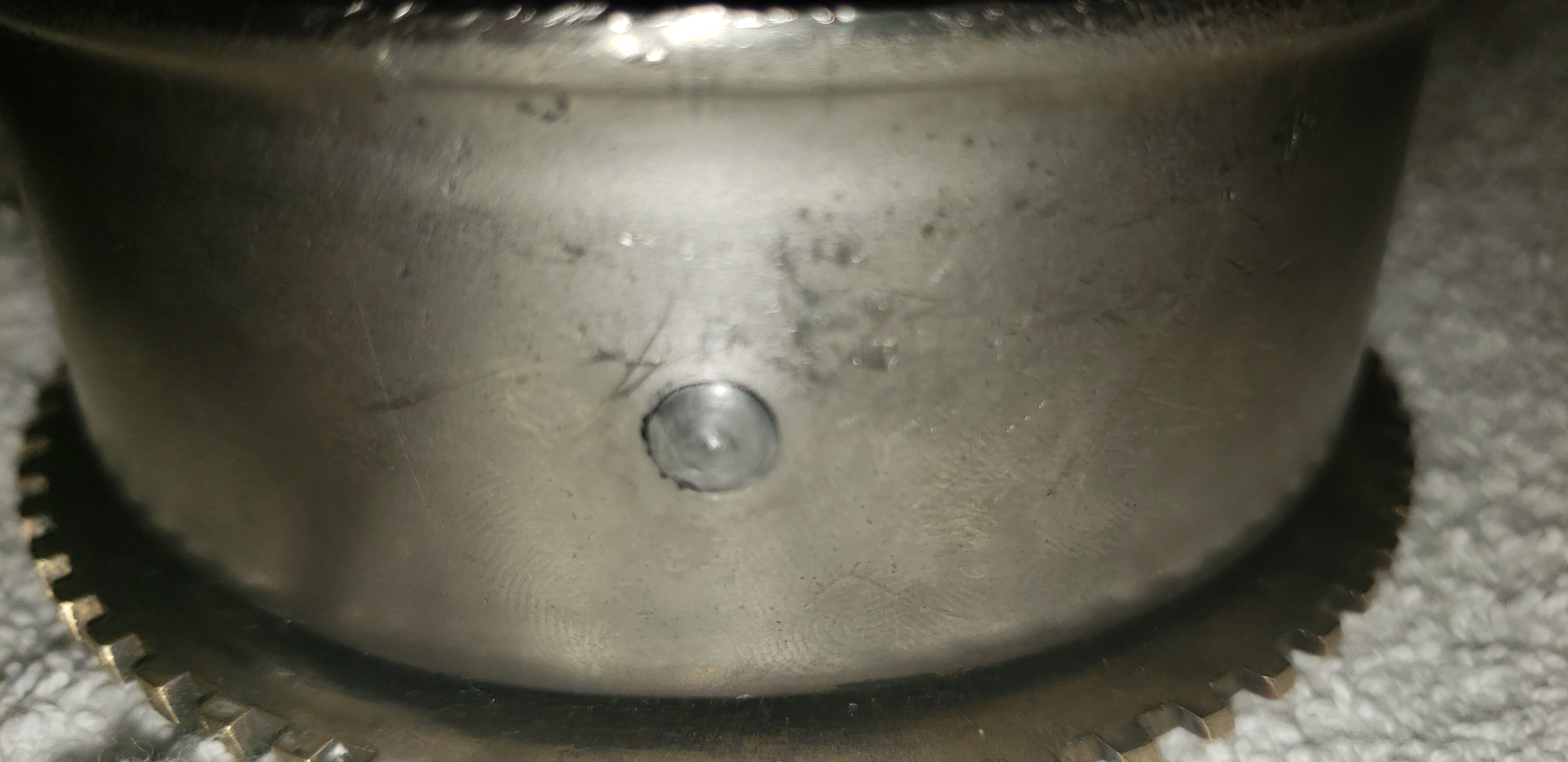

The hammer should be a fairly small ball-peen hammer and should be struck as seen in the photo.
Another solution is use a small punch in the same spot working around the circumference.
Using a punch still requires the big hunk of steel and the pin being supported.
Use the hammer to strike it about where the red circle is. Too far out on the edge won't to anything, too close to the centre won't do anything.

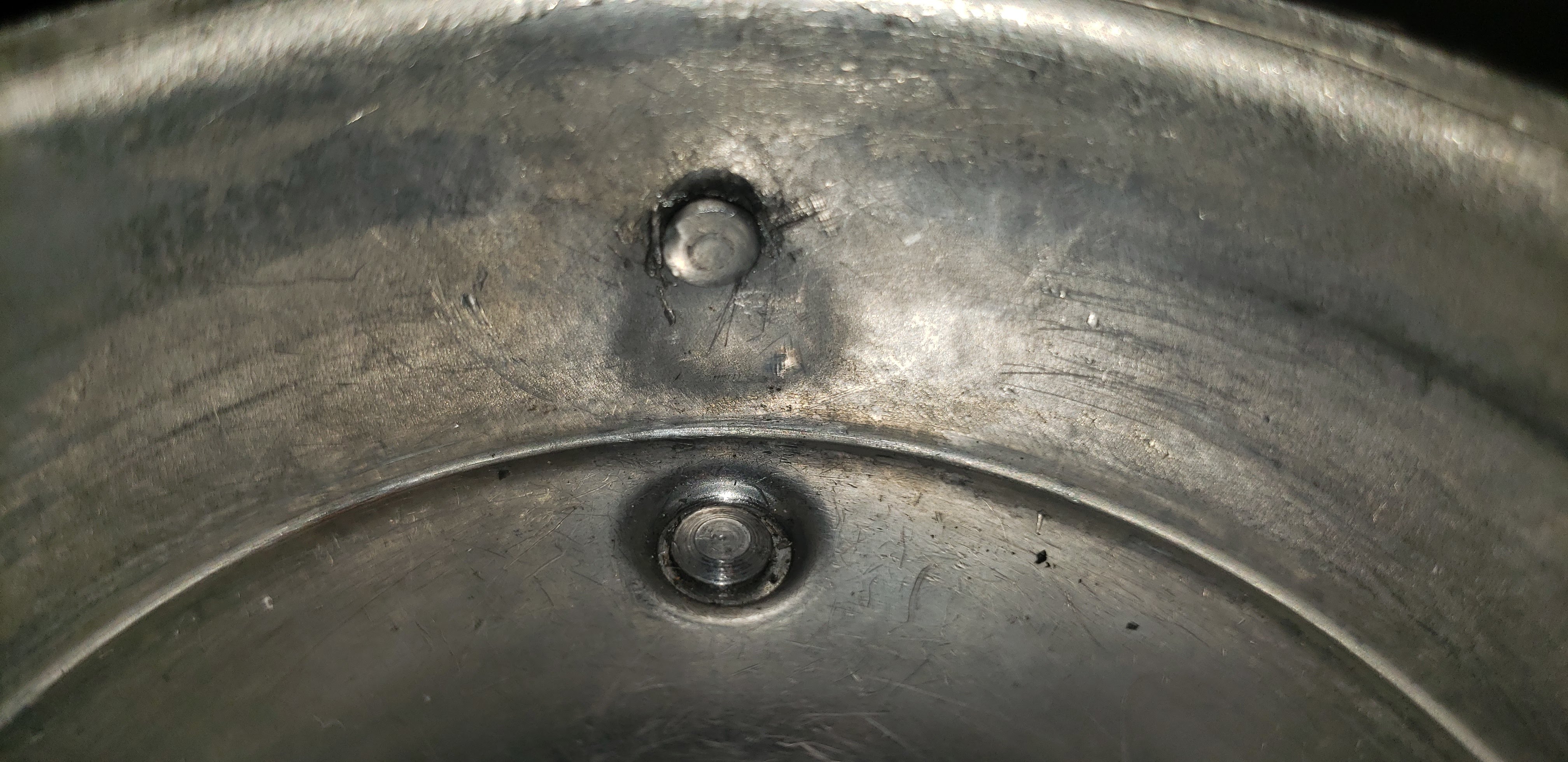

Thank you so much for the detailed instructions. I ordered new springs so could I cut a piece of a broken spring to slip under the edge where the spring hooks on to? Also, I noticed that the rivet is moving up and down slightly, does that affect the repair in anyway?

Is that the old rivet, it looks like you've been pounding on it ?
Or did you try and install a new one ?
The piece to slip under the anchor pin has to fit snug to keep in from "mushrooming" shut to the point where it still remains easy to lock the spring under when assembling.

I did hit on the old rivet with a regular hammer before making the post.
