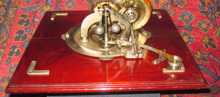

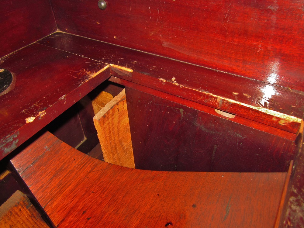

Not sure this example is going to help you much (my machine is serial number 894) but it gives me a chance to ask other forum members if they were as much surprised as I was by how little attention Victor paid to the design of these early Victrolas. Except for the little metal angle pieces you see in the picture no real attempt was made to fit the motor board to the cabinet- it's literally just the top of an early Victor VI. The fancy molded edge on the board insures that it will never sit securely in the cabinet. The scruffy appearance of the cabinet interior opening is the result of the motor board's bouncing around as the springs are wound. Resourceful owners might have used some wood screws to hold the board but obviously no one did that with this machine. All this would be excusable in a prototype but to have done nothing about the problem after hundreds of VTLA's had been made seems odd to me.
-Dave
Dave, thanks for the thought provoking post. I think the flat top VTLA was put into production perhaps a little too quickly. It has several design flaws such as the multiple position lid support and the depth of the turntable for a smaller person to change records. Most were were corrected with the domed top VTLA. Most know that "VTLA" was an abbreviation for "Victrola." Even the Victrola XX was tagged as a VTLA. This would seem to indicate that Victor did not initially anticipate other models of internal horn machines. I would say that the first VTLAs were a bit of a gamble for Victor. But that gamble paid off and Victor went from a leader in the talking machine field to nearly a dominating force.

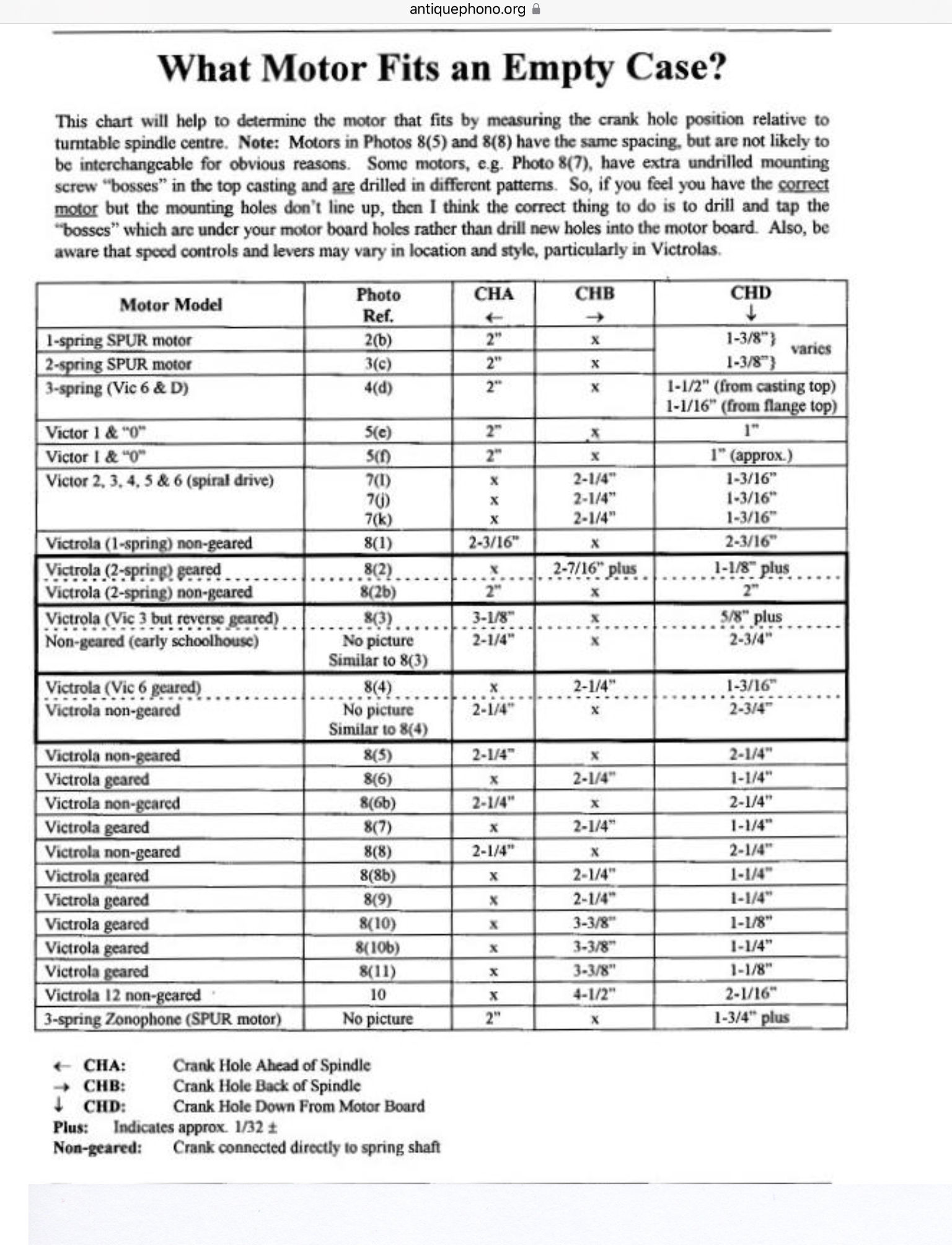

Years ago Harold Braker wrote a document that may address some of your your questions concerning which Victor motor fits which Victor cabinet.
Members of the Antique Phonograph Society can access the full article at this link.
https://www.antiquephono.org/victorvict ... ld-braker/
Here is one of the pages.
Mark

MarkELynch wrote: Thu Apr 07, 2022 7:12 pm Years ago Harold Braker wrote a document that may address some of your your questions concerning which Victor motor fits which Victor cabinet.
Mark
Harold’s motor guide has been posted on this board for over ten years, just sayin’.
