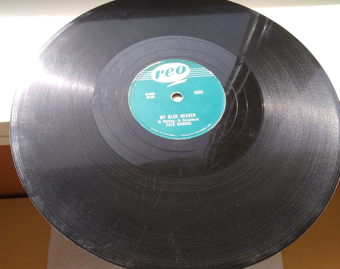

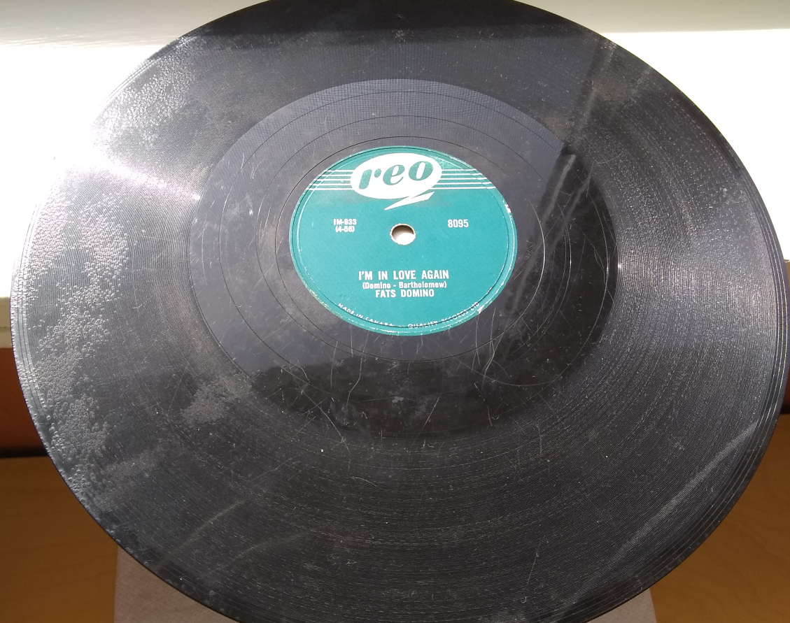

I was doing some polishing the other day with carnauba palm wax.
There is a completely trashed Fats Domino 78 which I got from somewhere. I tried once to give it away on Craigslist, but nobody wanted it. I use it as a test record of sorts because it has so much drag now. It caused the stock platter mat on an Audio Technica turntable to bunch up under it, and the AT motor struggled to play the disk with a different mat in place. It will play on my AV machine and on my Dual turntable, but it sounds awful. It would not play on my RCA Victor portable at all. It just stalled the motor completely.
So I thought what would happen if I polished one side of this record with palm wax. I remember my brother and I sock-skating down the maple-floored hallway in my childhood home after my mother had polished it - run, stop, and slide the full length of the hall. Since I did not care about the record at all, I went and did it. The cosmetic results were startling. If the record had only been loved to death with repeated plays and not abused with gouges, scrapes, and scuffs, one could produce a reasonable facsimile of a NOS appearance. The dull grey, dusty appearance of the grooves was replaced with a gloss. Carnauba wax is safe for shellac finishes so I am not worried about any damage to the record, not that I was worried in this case anyway. The interesting thing was that the record just didn't look better, but it sounded better, too, on my A-V machine, at least - it's not going near my Dual deck now. I would be lying, though, if I said it sounded good.
And wonders of wonders, it would play on my portable. I flipped the record over to the the unpolished side, and the portable just stalled again.
I am not advocating palm-waxing records. I would imagine that the wax would trap debris and dust. Nonetheless it was an interesting experiment.
My Blue Heaven has been waxed. The other side hasn't. Both sides looked very similar before the waxing.

It seems like the record benefited from the application of the wax. I've heard reports of improved sound from the application of a furniture wax/polish spray ("Mr.Sheen"), it would be providing a lubrication.
I'm curious, have you washed the record previously - there certainly seems to be some stuff in the grooves to be contributing to the amount of resistance to playing that a wash might have removed.

Yes. The record had thorough wet-washing on a vacuum record cleaning machine. The grooves still looked grey and dusty/powdery. The cleaning was done before trying it out on anything. It was still problematic.AudioFeline wrote: Tue Apr 19, 2022 10:26 am I'm curious, have you washed the record previously - there certainly seems to be some stuff in the grooves to be contributing to the amount of resistance to playing that a wash might have removed.

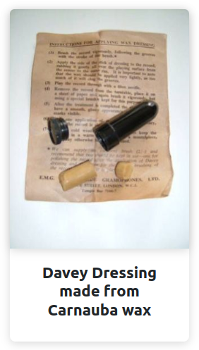

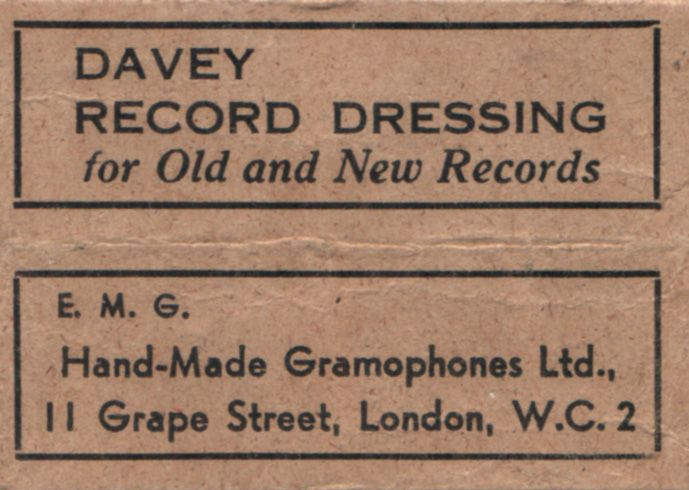

It seems there is some precedent for using Carnauba palm wax a a dressing. EMG had a Davey branded Carnauba product.
Ref: https://www.gramophonemuseum.com/emg-accessories.html

I wonder, how do they know it is carnauba wax?
It doesn't state that it's carnauba wax on the instructions nor the box.
In fact it doesn't even refer to it as wax and only ever calls it a dressing.
Did they have a chemical analysis done, was it stated in period advertising, or is it just their assumption?

This is only a guess on my part. Carnauba wax has a very distinctive odour. If you have a stick of it in a sealed tube it would retain its smell.gramophoneshane wrote: Fri Feb 03, 2023 9:24 pm I wonder, how do they know it is carnauba wax?

But your excellent question is something we could put to the person/people behind the Gramophone Museum. There is contact information on their website.

I have one, but at maybe 85 years old, despite the tube being screwed shut, the pieces inside don't smell of anything. I suppose I could cut a piece open and sniff it... Not sure I want to!Lah Ca wrote: Sat Feb 04, 2023 12:48 amThis is only a guess on my part. Carnauba wax has a very distinctive odour. If you have a stick of it in a sealed tube it would retain its smell.gramophoneshane wrote: Fri Feb 03, 2023 9:24 pm I wonder, how do they know it is carnauba wax?
