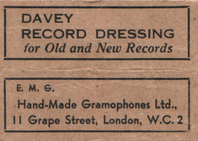

It seems there is some precedent for using Carnauba palm wax a a dressing. EMG had a Davey branded Carnauba product.

Ref: https://www.gramophonemuseum.com/emg-accessories.html

I wonder, how do they know it is carnauba wax?
It doesn't state that it's carnauba wax on the instructions nor the box.
In fact it doesn't even refer to it as wax and only ever calls it a dressing.
Did they have a chemical analysis done, was it stated in period advertising, or is it just their assumption?

This is only a guess on my part. Carnauba wax has a very distinctive odour. If you have a stick of it in a sealed tube it would retain its smell.
But your excellent question is something we could put to the person/people behind the Gramophone Museum. There is contact information on their website.

I have one, but at maybe 85 years old, despite the tube being screwed shut, the pieces inside don't smell of anything. I suppose I could cut a piece open and sniff it... Not sure I want to! 👃
Maybe Chunny (Gramophone Museum) will post here in response.
