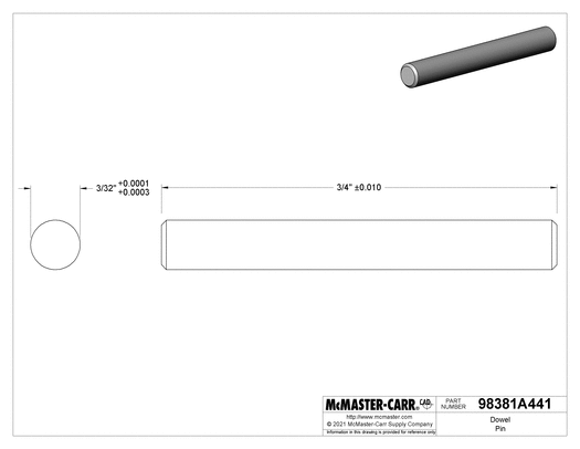

Is a 3/32" dowel pin too tight?

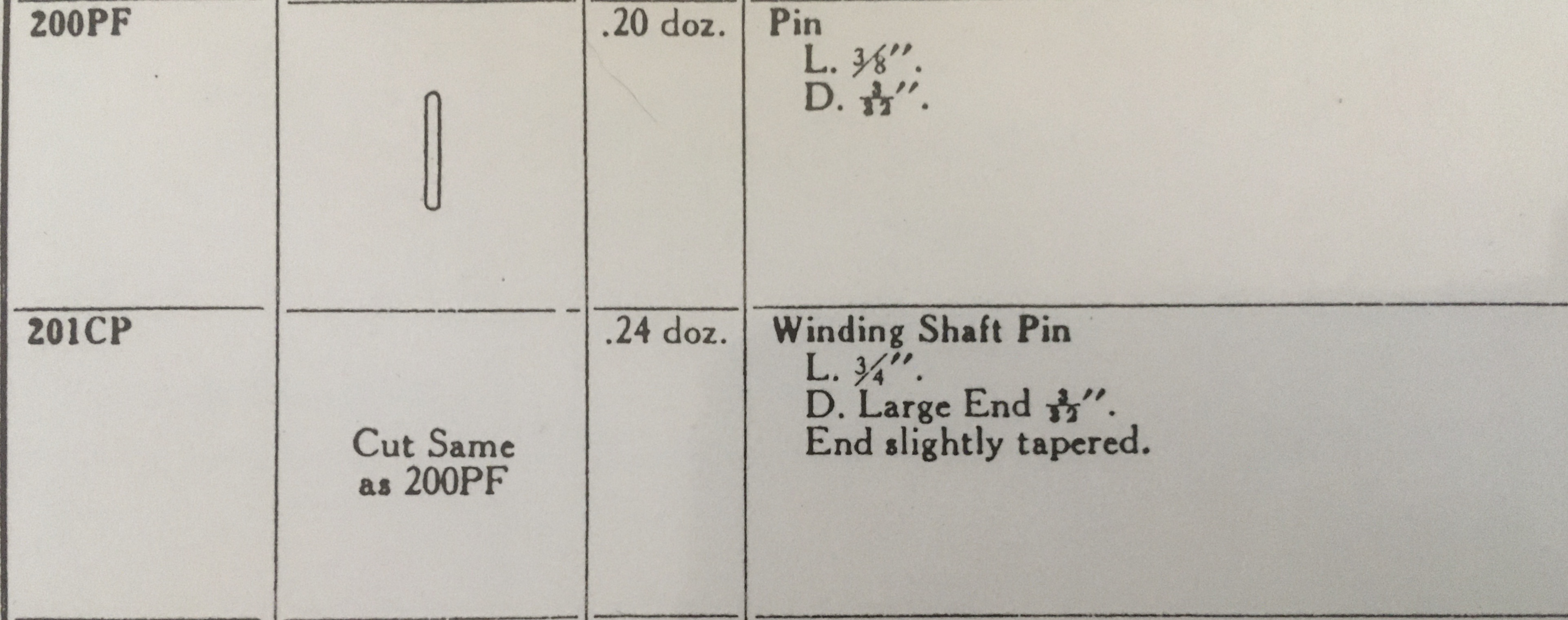

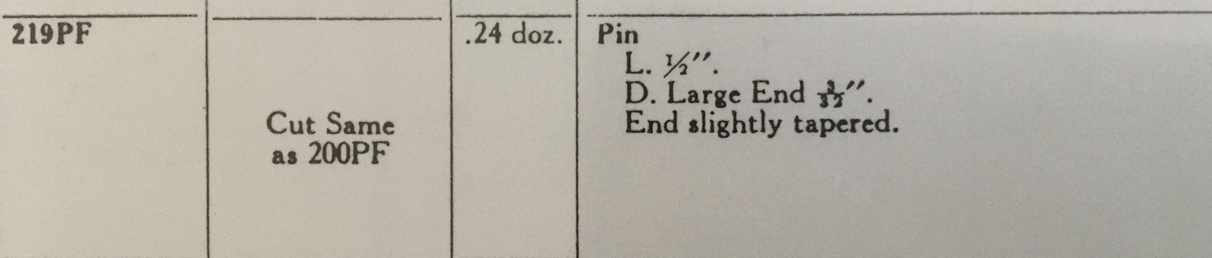

According to the Victor documentation they seemed to have used two different lengths of 3/32” pins.
201CP (copper plate) is 3/32” x ¾” and slightly tapered. Used on the earlier machines.
219 PF (plain finish) is 3/32” x ½” and slightly tapered. Generally used on spring motors through the Orthophonic era.
Dowel pins, as suggested by Jerry, are easily available from McMaster-Carr (about $7 for 50) or your local hardware. Tapering can be done easily with a small lathe or drill and file as Blizz has done.
