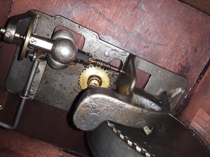

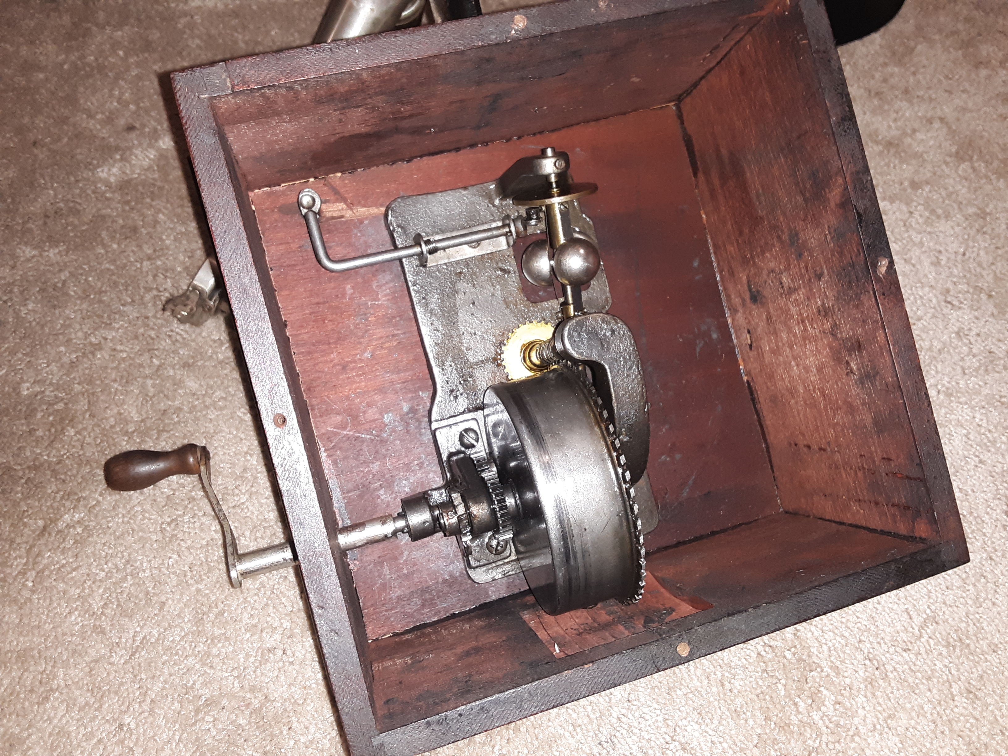

I just bought my first external horn disc machine the other day! The only bad news is it no longer works. Before I left the sellers house it worked great. When I got home and started cranking it up it would feel like something started slipping and it wouldn't wind past a certain point (without sounding like a quick unwind would happen). I'm wondering if the main spring broke or came unwind. I hope I explained the problem well enough, it would be easier if we could just post videos directly on the forum.

Thanks for all the info. So I tried cranking super slowly and in all different positions, as suggested. This is what happens: After I get a few full turns in the machine almost "pops" and then the spring loses all tension (it has tension while cranking). I can start cranking again immediately and can feel tension from the main spring. The gears all look in decent shape to me, but I've seen some in the past that looked good but were screwed up.

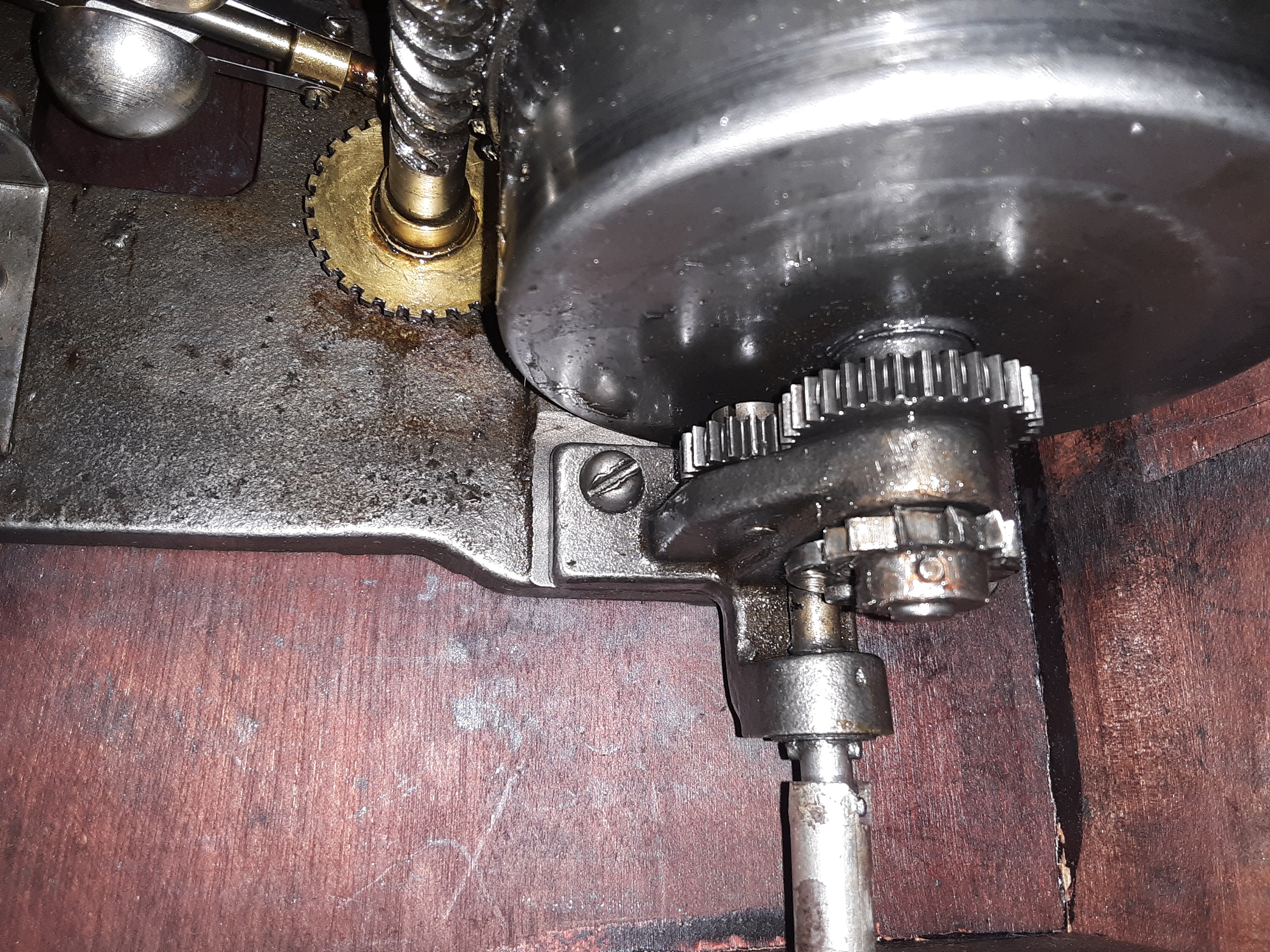

That's probably one of the easiest motors around to remove the spring barrel from as all you need to do is unscrew two screws once you've removed the crank.
You can see one of the screws in the second last photo you posted directly above.

The two screws I mentioned hold what is called the ratchet assembly, which is the triangular casting with a cluster of small gears where the crank handle attaches to the motor.
When you unscrew the 2 screws holding that assembly to the body of the motor, that whole casting and cluster will come away still assembled, and then the spring barrel can be slid out so you look inside, and it'll be just as simple to put back together when you're done.
