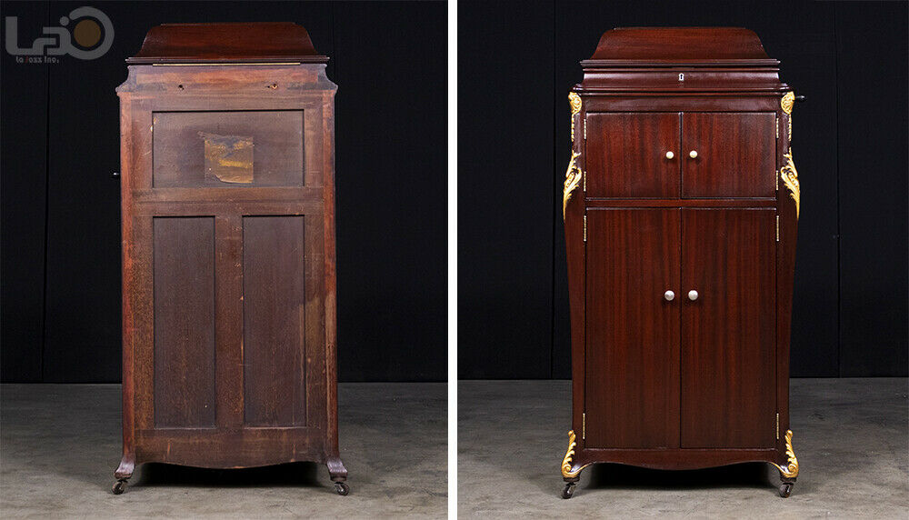

Not sure what is more creative...the extra work on the XVI, or the description:
https://www.ebay.com/itm/125306325758?h ... SwC1ZiegA6
gramophone-georg
Posts: 4348
Re: Creative VV-XVI
Post by gramophone-georg »
Looks like a "Google translate" description to me. It's a nice fantasy piece with a garish price. What's bugging me is... why not also finish the back?

gramophone-georg wrote: Tue May 10, 2022 12:28 pm Looks like a "Google translate" description to me. It's a nice fantasy piece with a garish price. What's bugging me is... why not also finish the back?
I have this same model XVI (he at least got the year right, it is a 1913). I don't think Victor start finishing the back until about 1916, mentality being, why finish the back if it's going to be up against a wall?

What I find interesting about that machine is the record trigger "stop" on the tone arm is clamped in place _ first one I've seen that isn't held in with screws.
The motor gearing is quad cut _ never knew there was that type of triple spring motor of that type with quad cut gears.
My Victor II is quad cut as well _ thought to be not original until I had the cereal number checked.

That variant of the VV-XVI had wonderful carving. It probably would have been a good candidate for gold leaf. That said, I prefer the warmth of wood, even on a VV-XX, (just my personal preference).

JeffR1 wrote: Tue May 10, 2022 4:17 pm What I find interesting about that machine is the record trigger "stop" on the tone arm is clamped in place _ first one I've seen that isn't held in with screws.
The automatic brake first came out mid way through the run of this model, so some have the trigger screwed in, and other simply didn't have one (mine was a late 1913, and had the normal screwed in configuration). This one would have been an aftermarket addition to give the benefit of the new technology.

Zeppy wrote: Tue May 10, 2022 7:46 pm
Yep, I have the same 'aftermarket' arrangement on my 1912 L-door.
That’s actually a semi-automatic brake because it has to be manually indexed. Victor didn’t introduce a fully-automatic brake until the Orthophonic Victrolas in 1925 with the eccentric run-out groove as a trigger.
