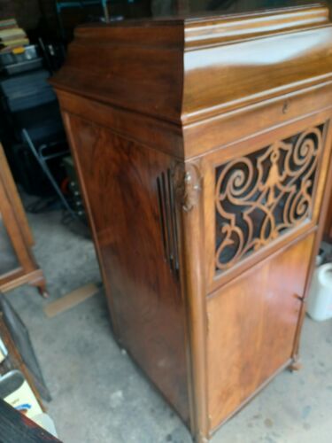

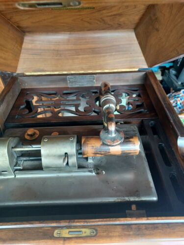

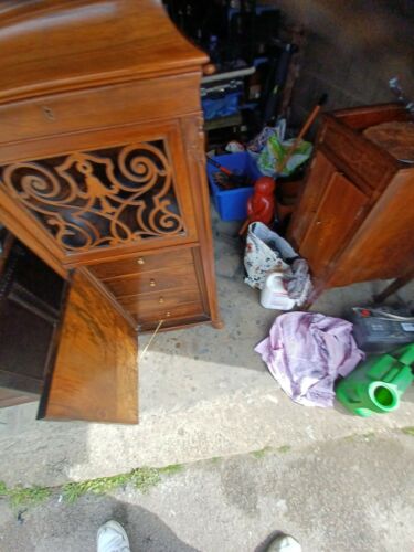

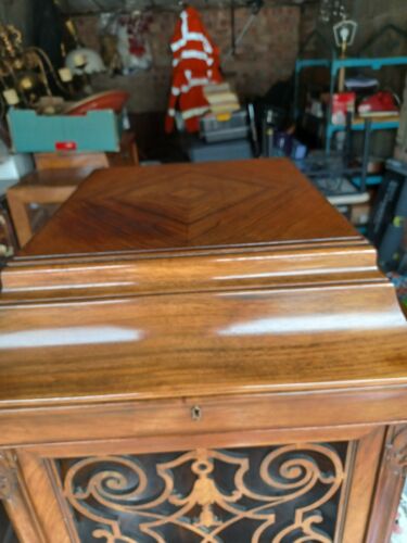

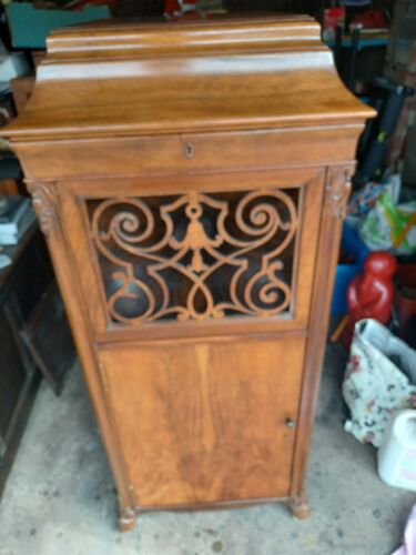

I would agree that it's Circassian. The diamond pattern on the top is kind of an Edison trademark for the Circassian machines. With 2 reproducers and drawers full of cylinders, it's quite a find if you're in the UK.
The thing is, it's a 1A motor, not a 1B. You can see the 2-and-4 switch on one of the pictures and the motor has no on/off switch on the left. Makes me wonder what else is "wrong"...
- phonogfp
- Posts: 8048
Re: Circassian Walnut Amberola - B1 ???
There's nothing wrong at all - it's a 1A, manufactured in 1910 or the first half of 1911. The cabinet was supplied by the Pooley Furniture Company. There's a 3-part article that appeared in the APS magazine in 2009 on these machines.52089 wrote: Sun May 15, 2022 8:30 pm The thing is, it's a 1A motor, not a 1B. You can see the 2-and-4 switch on one of the pictures and the motor has no on/off switch on the left. Makes me wonder what else is "wrong"...
Another red flag: shipping is about $225. Packing and crating one of these costs more than that.
Yes, but the listing includes the following: "Plate on interior, "Edison Amberola Phonograph, Model B, Type SM, Serial number 3682."phonogfp wrote: Sun May 15, 2022 8:53 pmThere's nothing wrong at all - it's a 1A, manufactured in 1910 or the first half of 1911. The cabinet was supplied by the Pooley Furniture Company. There's a 3-part article that appeared in the APS magazine in 2009 on these machines.52089 wrote: Sun May 15, 2022 8:30 pm The thing is, it's a 1A motor, not a 1B. You can see the 2-and-4 switch on one of the pictures and the motor has no on/off switch on the left. Makes me wonder what else is "wrong"...
I sure wish this was near me!
Perhaps someone put a 1B plate on a 1A machine? 3682 would seem to be a pretty late number for a 1A, no?
- phonogfp
- Posts: 8048
Approximately 3500 1As were built, and the first 1Bs were offered alongside the last of the 1As. As written in the final installment of the Amberola article in the September 2009 issue of the APS magazine:52089 wrote: Sun May 15, 2022 9:14 pm Yes, but the listing includes the following: "Plate on interior, "Edison Amberola Phonograph, Model B, Type SM, Serial number 3682."
Thus the first Amberola 1Bs were offered alongside the 1As, and it is expected that serial numbers may intermingle between the two models around No.3500. Indeed, Amberola No.3519 consists of a 1A mechanism capable of playing only 4-minute cylinders. There are also stock 1A mechanisms featuring brass oiler caps on their bedplates, which possibly date from this transitional period.
The machine in question being a Circassian cabinet, it may have lingered in the West Orange inventory awhile before being ordered, serially numbered, and shipped out. Someone probably forgot to reset the "B" to an "A" on the stamping machine; this has been seen on other Edison machines, especially during periods of transition.
Hmmm.... now the listing says, "Plate on interior, "Edison Amberola Phonograph, Model A, Type SM, Serial number 2271."52089 wrote: Sun May 15, 2022 9:14 pm
Speaking of red flags...! I suppose if there re more than one early Amberola on the premises, it would be possible to confuse the data plates...Valecnik wrote: Mon May 16, 2022 6:39 am Hmmm.... now the listing says, "Plate on interior, "Edison Amberola Phonograph, Model A, Type SM, Serial number 2271."
